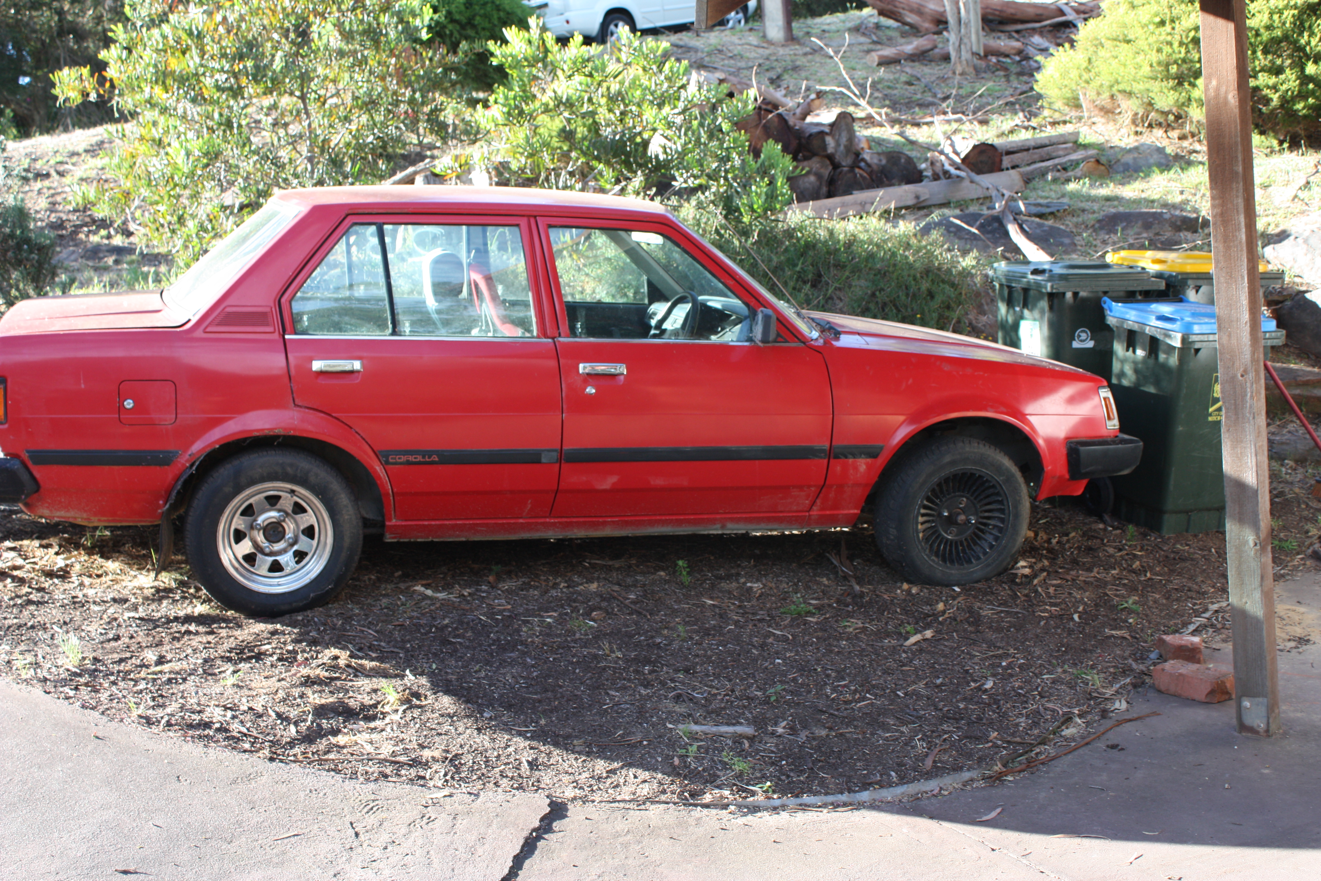

snot35 Posted November 27, 2011 Author Report Posted November 27, 2011 A quick photo from the days action. The suspension made so much difference with the rally tyres as well. The car felt fantastic and I was able to push it pretty hard. I'm not sure how the times compared to others, but I had fun anyway. Now we have a few months off to sort things out. Rack rebuild might be next. The cooling also proved a bit marginal on the hot day that today was. The heater core is also leaking a little bit so that will have to be looked as well. Fun times! Quote

snot35 Posted December 16, 2011 Author Report Posted December 16, 2011 No much to update. It's probably going to be quiet over summer, I have to do some work around the house and sell a different car. But in the mean time, I've added to the mag collection and done a dodgy photoshop.... I now have 11 of these mags, the plan is a set for the rally tyres and a set for some road tyres that I have to get too and from events, and maybe the odd motorkhana. Quote
