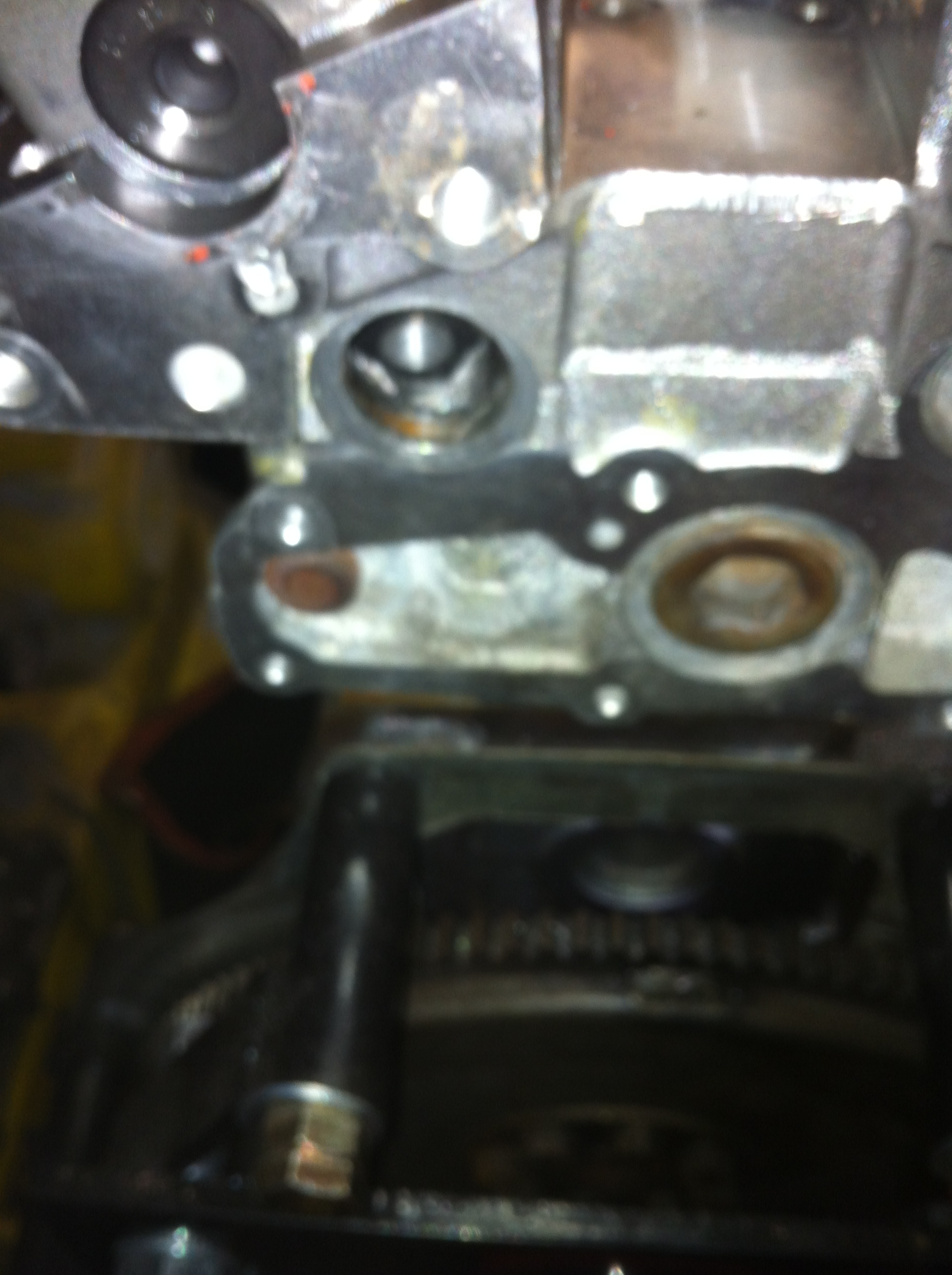

been working on ideas with this engine and its over efficient oil pump, they have a habit of filling the head with oil and running the bottom end dry if held in high revs, not good for me considering it have no mercy and will be 8500rpm limiter
so my idea was instead of stuffing around with restrictors like the RB's (there doesn't seem to be any for the CA, and I'm not about to test something out) is making the oil drain faster
so there's this hole in the back of the head which had a welsh plug in there, it opens up into the valve spring cavity
in which ive grinded down a 1/2 brass fitting to fit in there
and all glued in there, if i had a lathe or was patient i would have done it so it was a press fit sort of thing, but I'm not, so epoxy will do
this way if the head starts to over fill with oil, i.e. the original drain holes aren't flowing enough, then opil should rise up and drain out this fitting, which will have a hose to a return in the sump

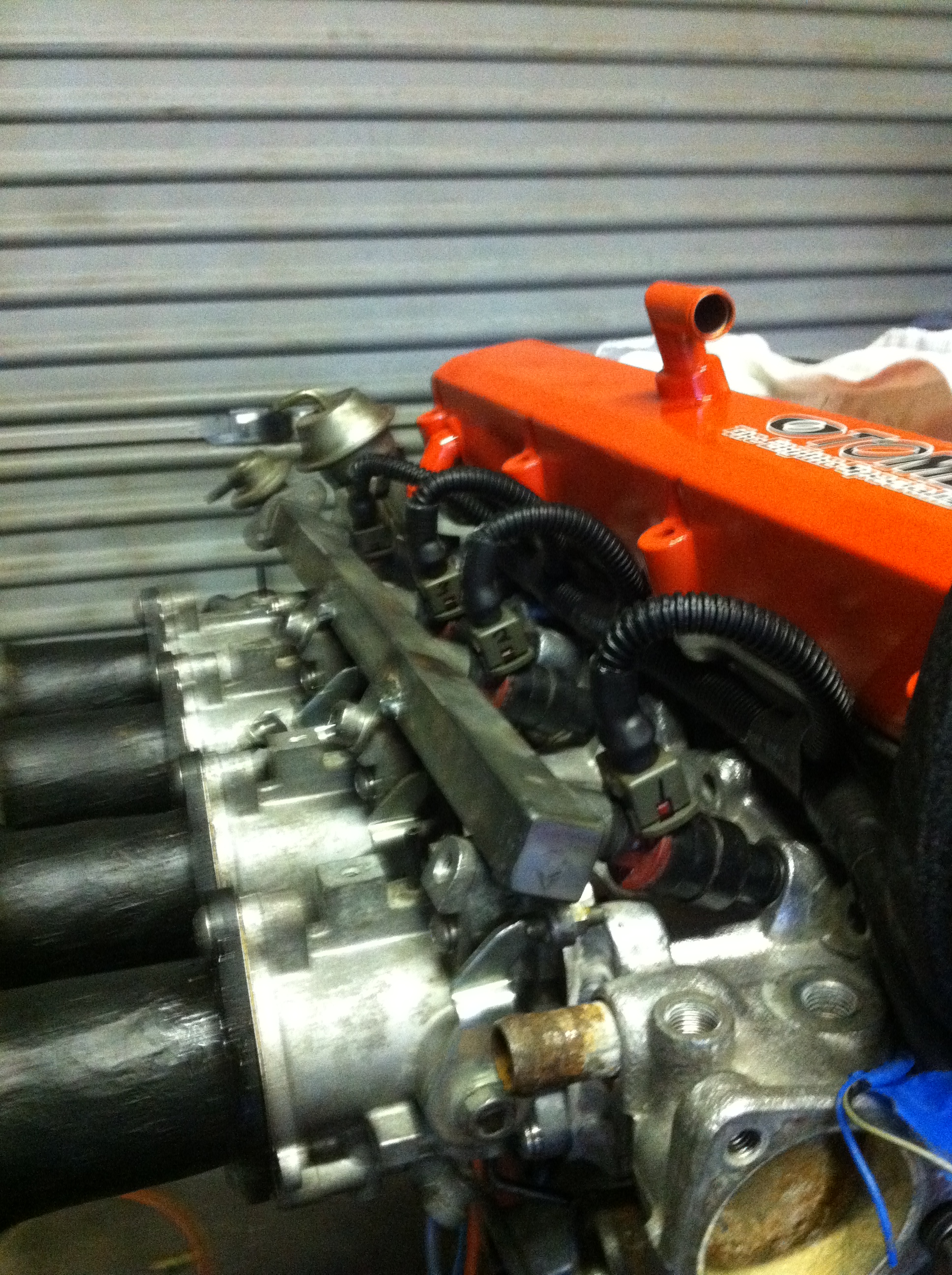

fuel rain also needed some work, the original mounts just weren't going to work any more, and the feed line fouled on the #1 throttle body
so i removed all the ugly old mounts and feed line and made these mounts, I'm going to run a speed flow fitting in the front end for supply fuel, i just need to make the trip to get them
happy with the way it will turn out, needs a coat of paint yet tho

made a trip to speedpro on Friday night and bought a shite load of speed flow fittings and weld on's so i was able finish off the fuel rail and started working on the the vacuum reservoir,will get pics of it up when its done
fuel rail done
i love speed flow fittings
