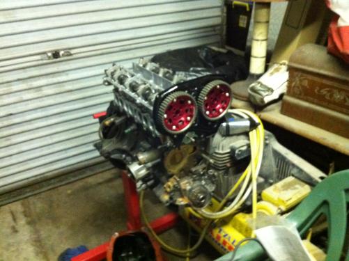

pozman Posted October 30, 2011 Author Report Posted October 30, 2011 finally a decent update mate that i was getting the welding done by's welder died, so had to find some one else to do it have a friend a the local 4wd custom shop (4b fab) and he did the welding on the manifold for me, they did a top job, and only cost a cool hungy welded around the inside too grinding it out to make it all pretty again (i have since smoother all this out, just don't have photo ATM)I've done a lot of port work, and has taken some serious time, i will never ever wonder again on why porting is so expensive, because with the hours i put in it sounds cheap lol heres a pic of the work that was done in the head i also got the head back finally, had it shaved down by about 35 thou, which will give me a healthy 12:1 compression ratio, cams and cam gears are in Quote

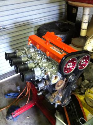

pozman Posted October 30, 2011 Author Report Posted October 30, 2011 And after a few days working on the manifold, match porting all 8 runners to the head, and matching the round port of the throttle bodies to the once oval manifold, knife edged the split in the port i was finally able to bolt the quads on and the trumpets on and smash it on the motor for some, what i would say are some what horny photos :dance: Quote
