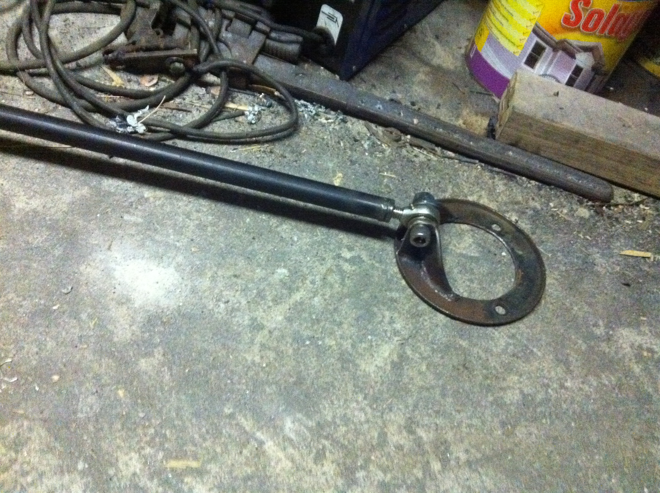

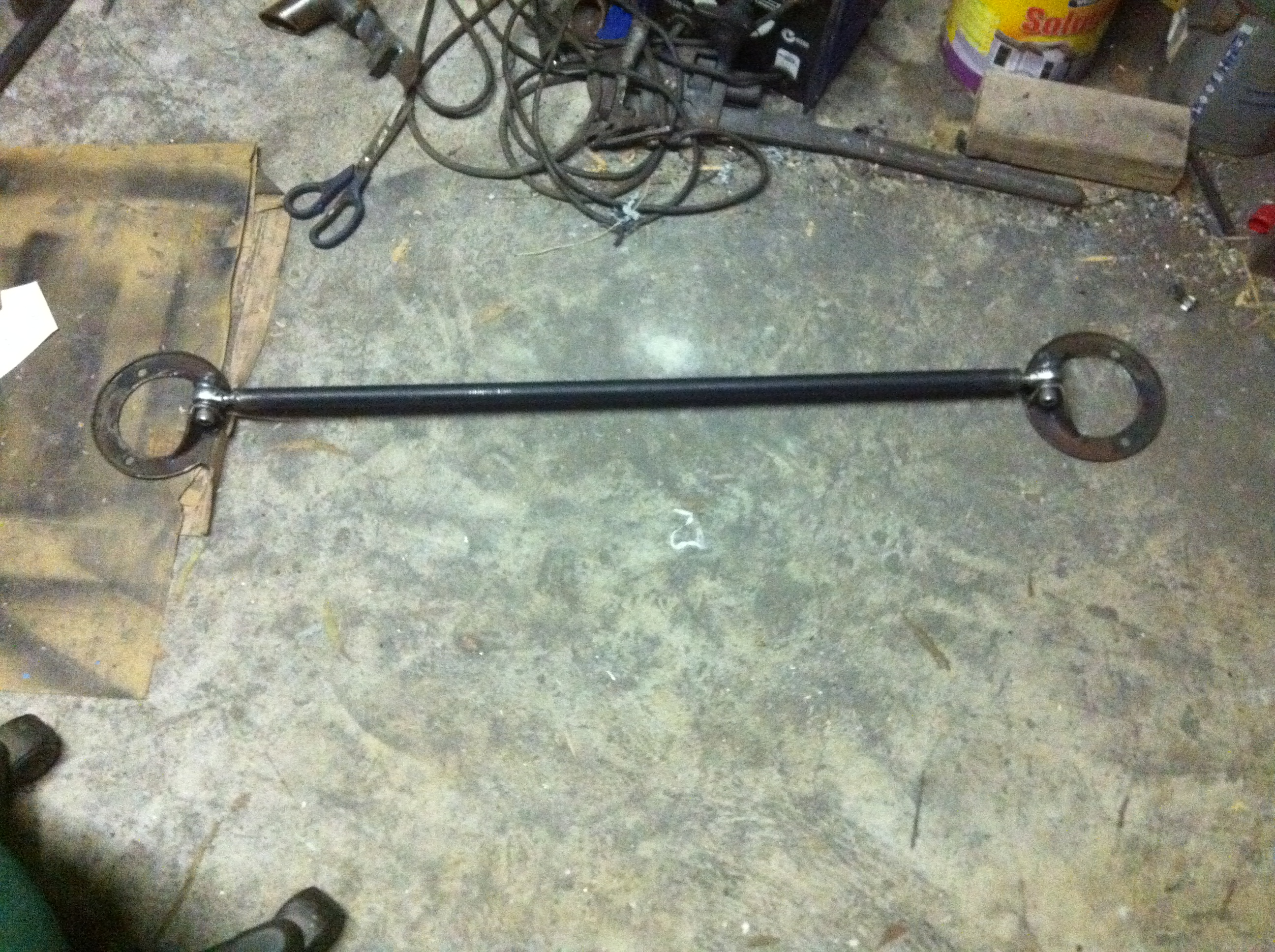

been working on a strut brace over the last couple of weeks in my spare time

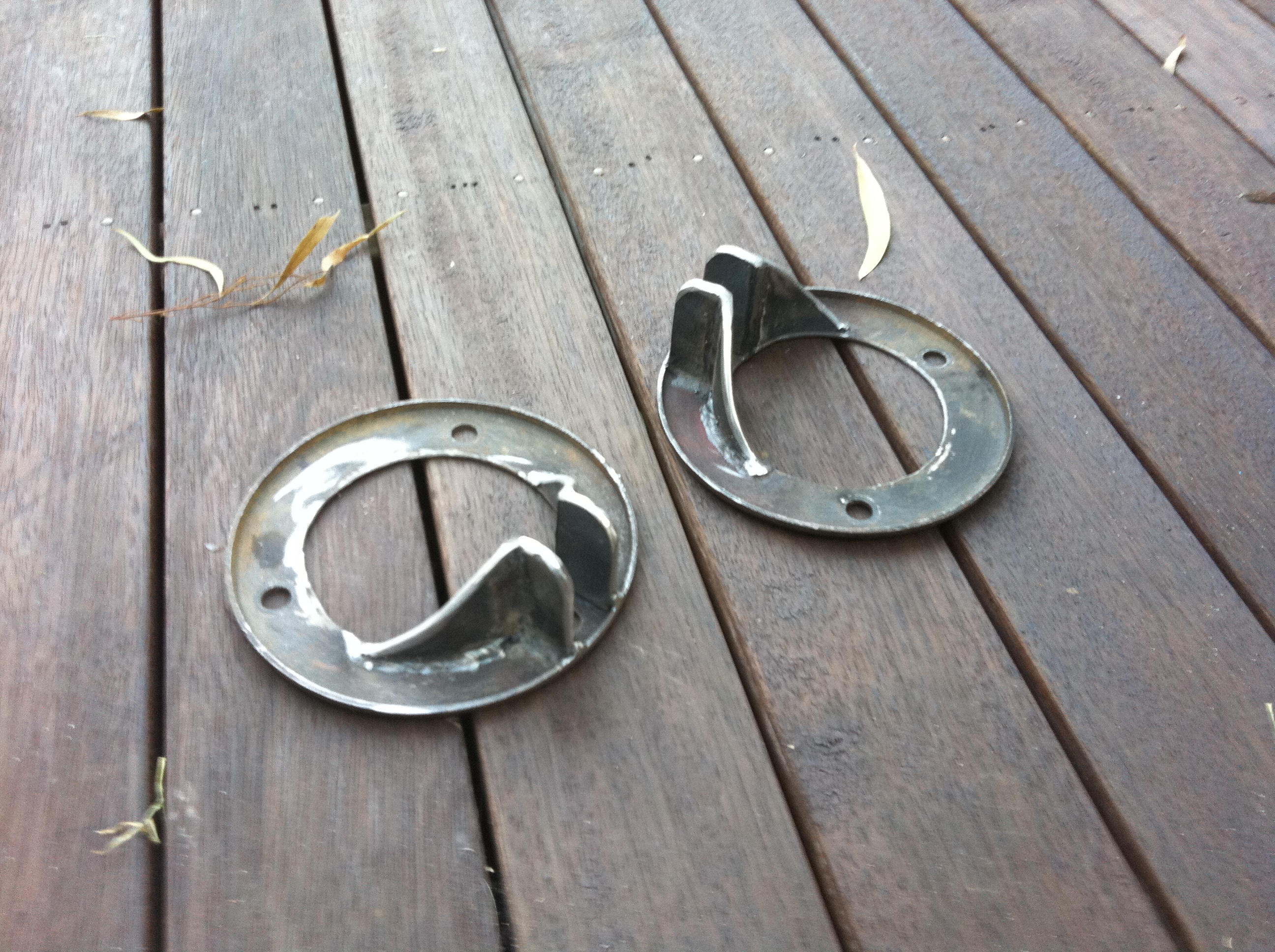

made the tower pads from old strut tops that i cut and grinded the center out of, then bent and welded some flat plate on to it to make these

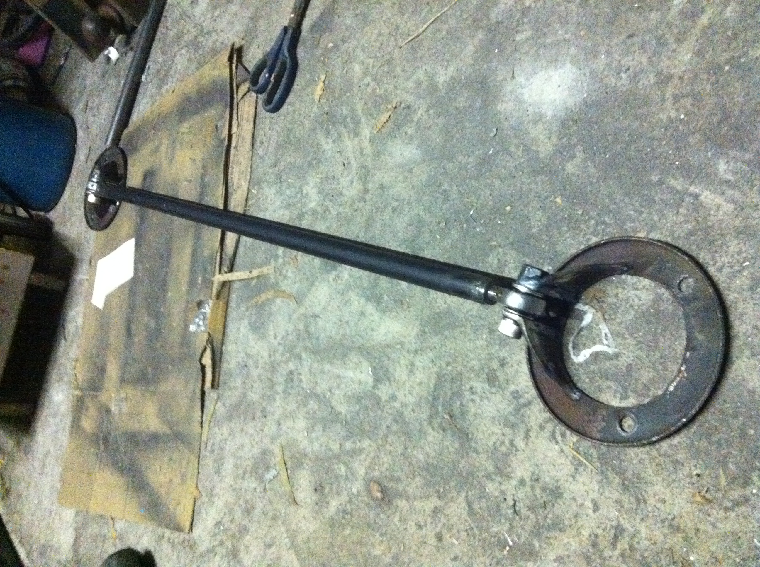

i made the actual brace out of some 16NB with some rod ends, one right hand thread and one left, bought some male ones aswell and cut the tie rod end off them and welded the threaded section into the ends of the pipe
12mm stainless cap head fixes the brace into the bases/pads
haven't painted it yet but should come up quite nicely

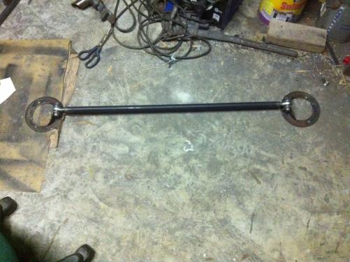

decided today to triangulate the strut brace since i have some rod ends left over
