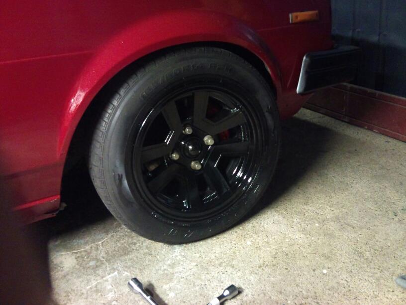

Ella Posted December 28, 2011 Author Report Posted December 28, 2011 hrmm long time no post again, as per mt previous posts have been busy moving house. new place is so much better! finally moved this and the DX on monday so they now live under the new house. had a few spare moments so i chucked one of the new wheels i got for it (cheers chris) on so see how it test fits.... what you guys think?? :) Quote
BUZ440 Posted December 28, 2011 Report Posted December 28, 2011 Looks good Luke, Push it in the sun and take a flick, will do it justice Quote

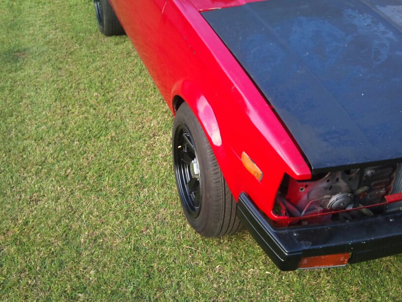

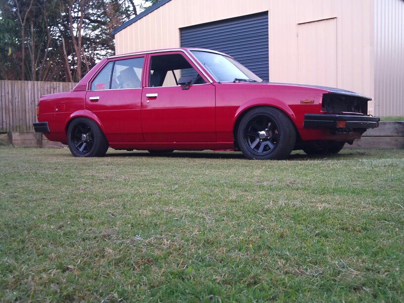

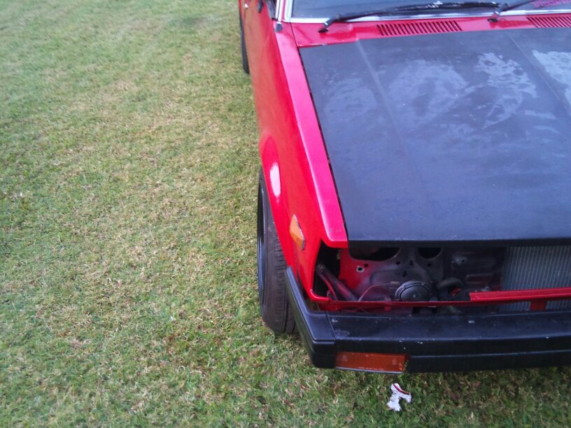

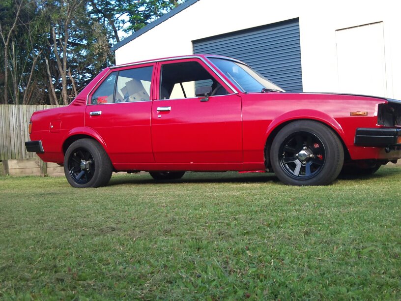

Ella Posted January 8, 2012 Author Report Posted January 8, 2012 ok so no headlights in, but i did do just a little bit of work to it. suspension, wheel alignment and ride height in front and back are all sorted! ill let the pics do the talking! before height front corner shot new height shot front corner shot showing new camber, caster and toe settings (kinda lol) what do you guys think? Quote
rian Posted January 8, 2012 Report Posted January 8, 2012 (edited) So dope! The colour looks really good in this photo against the black MA61s, plus they fit heaps well. Have you got XT130 lower control arms? Edited January 8, 2012 by rian Quote
Ella Posted January 8, 2012 Author Report Posted January 8, 2012 (edited) cheers spencer, yeah rian xt130 contol arms and struts with cusco camber tops, every single bush in the front end is brand new urethane too, rear end has re bushed control arms with toyota genuine rubber bushes, and urethane bushes everywhere else, cut and reset jeep cherokee front springs and suzuki sierra heavy duty shocks. oh and the colour in real life is much more like the first pic (lighter) and has glitter in the clear coat lol. the paint job is a bit rough but still ten times better than a unpainted one. Edited January 8, 2012 by Ella Quote
