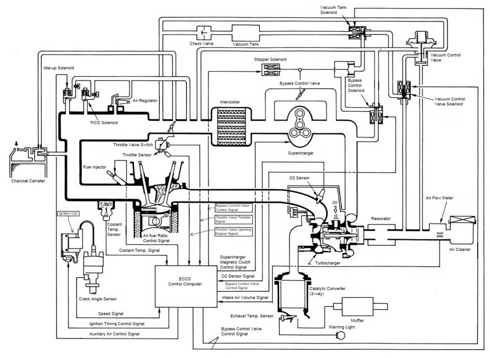

AE25 Posted April 29, 2011 Report Posted April 29, 2011 tidy 55 you got there! and good to see you converting over to the efi. :happy: plenty info on how to twincharge on the interwebs already if you not sure. existing production twincharged cars incl. Nissan March superturbo Lancia Delta S4 VW Golf tsi click on above to see system diagrams. some more ramblings of my own on this forum if you havent seen. http://www.rollaclub.com/board/topic/13186-4agze-twincharger-conversions/ theres an awesome mitsi evo5 twincharge in scotland. can see vids on youtube under user evomadmac. he uses compound charged turbo into super with two coolers. pretty much the ultimate setup like the delta s4. Simplest setup being turbo into super but is limited to how much heat the system creates and how much heat the supercharger can handle. balance of boost levels is key. the other option is go sequential which requires a bypass valve. can use either turbo into super (nissan march) or super into turb (VW) but each has it's own quirks to iron out. Position of throttle before or after supercharger also makes big difference to system operation. then theres the parallel system which may or may not work. they usually fail. one that works is the opel mantra kadett volvo engine thing. he uses two flapper valves from what can been seen in his pics. i just never see the point in it when series and sequential are proven performers. so yeh. keep up the effort. curious to see how you get on. will assist in system design if requested. good luck Quote
mhmills Posted April 29, 2011 Author Report Posted April 29, 2011 (edited) Thanks for all the advice, more info never hurt anyone :) I have a customer who has one of those VW Golf's, he says it hauls ass. I've seen it and you could hear the induction on it. Pretty mad little car, only hope mine can thrash it :P Speaking of Turbo into Super, which seems to be my setup as of current, Turbo>Intercooler>Supercharger, I figure that will lower the heat before airflow hits the Supercharger. MIGHT even squeeze in another intercooler, might not. Haven't decided. Cheers, Jake. Edited April 29, 2011 by mhmills Quote

JJT036 Posted April 30, 2011 Report Posted April 30, 2011 Air Intake --> Turbo --> FM-Intercooler --> Supercharger --> TM Intercooler --> BOV --> Intake Manifold. Could looks and sound cool. :yes: Josh :cool: Quote
mhmills Posted April 30, 2011 Author Report Posted April 30, 2011 That's the idea at the moment Joshy. Quote
