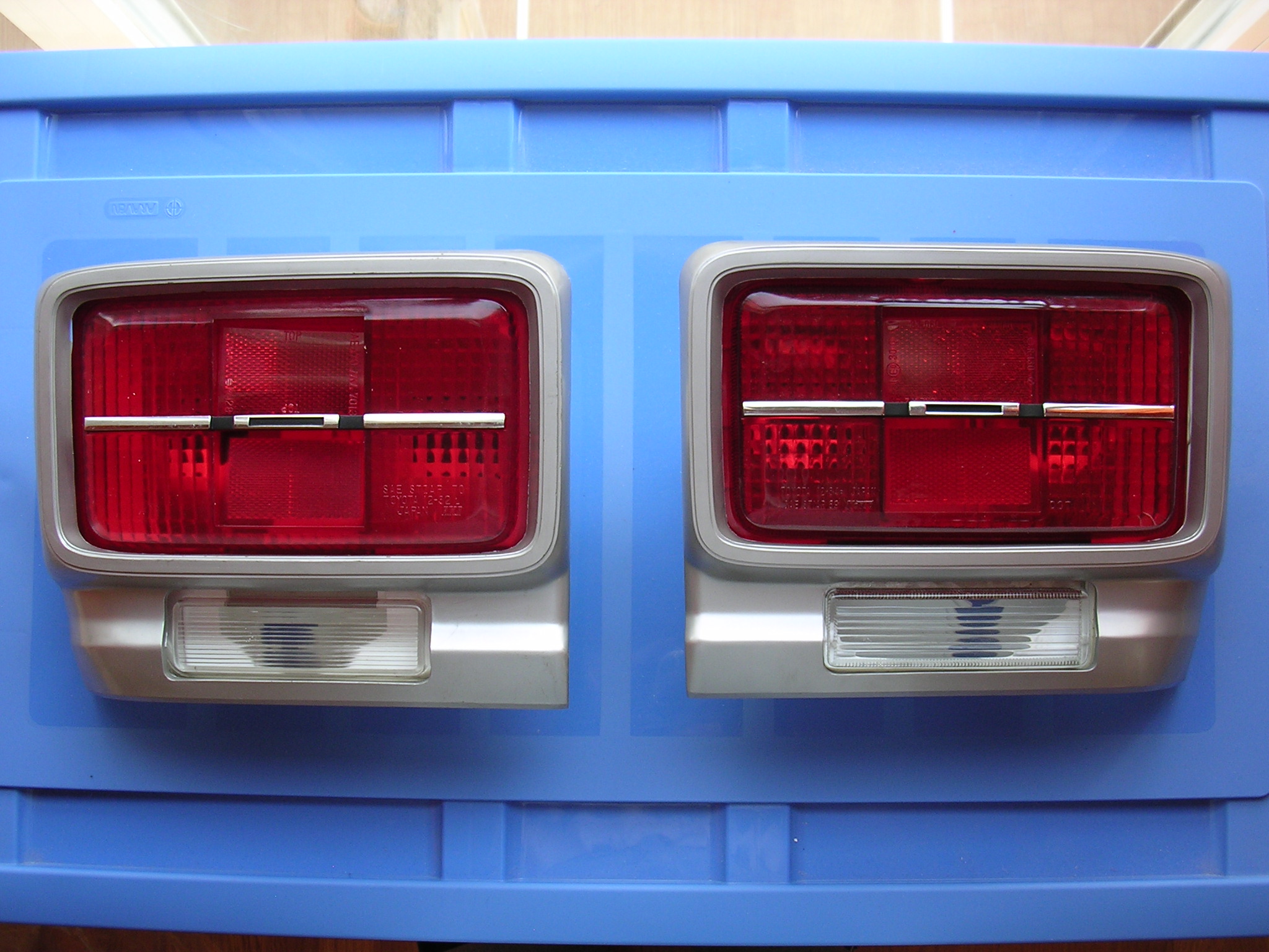

and are these right tail lights for a 71
Any help would be apreciated

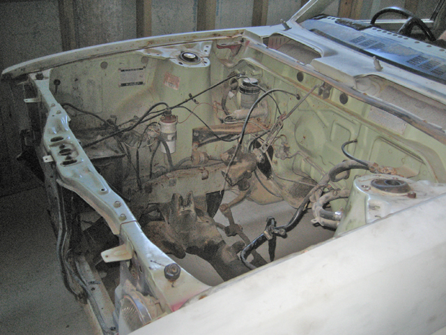

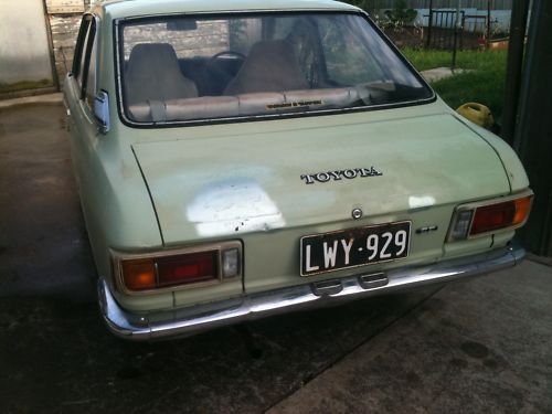

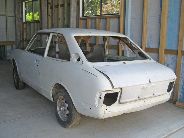

here is a few pics of the projects thats ganna lay dormit at the brother in laws for 6 months while the new crib gets built :bash:
The 71

The 74

the front garnishes will fit all Ke2#'s but the taillights will only fit early ke20's like your white one...
71 grill might have different mounting points so not sure if the 74 grill will fit...
Edited by Tally
something to remember if you are wishing to put those front garnishes on your 71, the 74 has side markers (guard mounted indicators) on the guard itself, whilst the 71 has the side markers on the actual corner garnish.
to stay legal and keep the upper indicators, you will need to either swap the guards from the 74 onto the 71, or drill the 71 guards to fit the indicators from the 74.
hope that helps.
