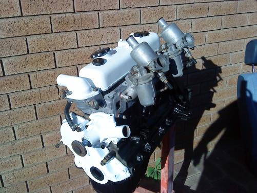

altezzaclub Posted May 27, 2011 Report Posted May 27, 2011 There are different acids that guys use, some neutralise rust, others don't. Some strip paint and grease extremely well, but the block rusts straight away. Oxalic acid is what makes rhubarb bitter and is why you don't eat rhubarb leaves. Maybe someone would like to start a thread on this and see what we can all hammer out. I'm running inch & 1/4 SUs, the HS2s, they're great for NA work, but for forced induction I would go for a single 2" myself. Its easy to make your own needles so they are lean or rich in any rev range, and you will certainly need the FMD setup I run, or something that tells you mixture by reading exhaust O2. http://www.rollaclub.com/board/topic/42407-the-girls-ke70/page__p__445727__fromsearch__1#entry445727 Quote
Spencer[RL] Posted May 27, 2011 Author Report Posted May 27, 2011 Altezza - I've read the build of yours for your daughter about a 100 times! :laff: Definitely going to have a FMD setup its been a must from the first day I thought this build out. I'm selling my Dual inch 1/4 Hs2 on a lynx manifold like Altezza's if anyone's interested . :wink: Quote
