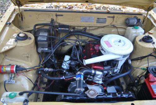

rad32 Posted December 6, 2010 Author Report Posted December 6, 2010 anyone got a tutorial on how to remove and replace the spark plug tubes? as I'm getting oil leaks from there?! Quote
Tally Posted December 6, 2010 Report Posted December 6, 2010 remove spark plugs, take spark plug tubes out :) if they are leaking take them out, the rubber o ring is probably gone, go to a wreckers or find someone wrecking a ke70 and grab some decent condition ones... Quote

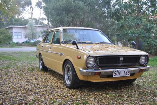

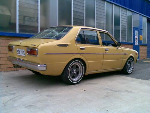

JordyKE Posted December 6, 2010 Report Posted December 6, 2010 Hey mate clean 30 :) I personally like the wheels you have on it now. You can get NEW lowered king springs for the front at a reasonable price. Check on the left hand side of Rolla clubs homepage in the Sponsors section, something a rather Suspension blah blah.. he/she sells lowered springs for the front for around $125 a pair. So check that out. Also an option instead of blocks, you can get your leafs reset, which some people seem to find safer, but it comes at a cost I'm pretty sure, i got a quote for $350 for resetting the leafs. NEW blocks would set you back around $100 ishhhh depending on who you go to. Anyways thats my 2 cents :) Quote

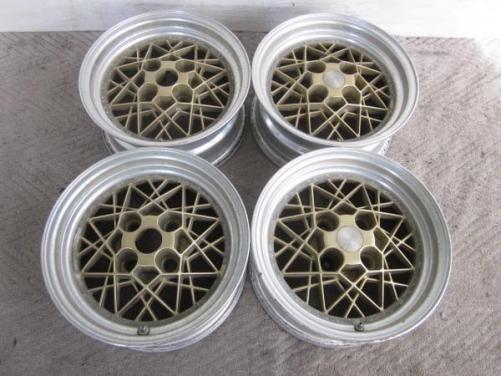

JordyKE Posted December 6, 2010 Report Posted December 6, 2010 ps.... what wheels are these..? :hmm: Quote
rad32 Posted December 6, 2010 Author Report Posted December 6, 2010 those wheels were enkai. i didnt want them so the seller kept them. didnt think it was that hard to find steelies in 15" and 114.3x4 there NO WHERE! Quote

towe001 Posted December 7, 2010 Report Posted December 7, 2010 also look for a k50 gearbox, will bolt straight in. if you can find one. To a point. K50 from either a ke3x or ke55 will be a straight fit, where as the K50 from the ke70 will need the hole for the gear shifter modified. anyone got a tutorial on how to remove and replace the spark plug tubes? as I'm getting oil leaks from there?! How To Fix K Motor Oil Leaks Quote
