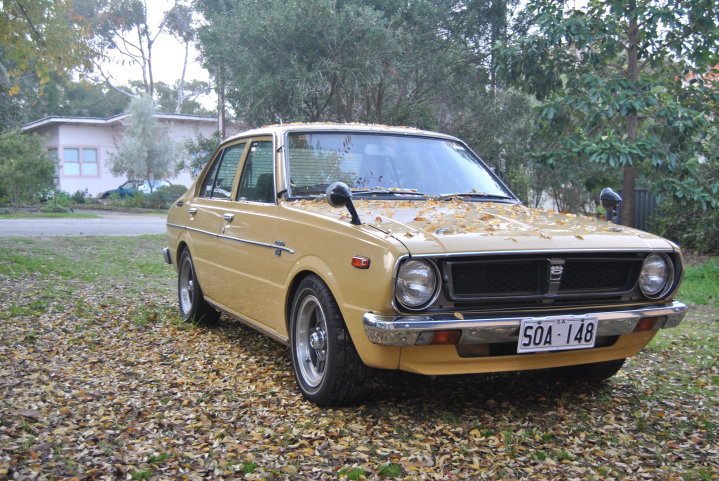

rad32 Posted December 5, 2010 Report Posted December 5, 2010 (edited) hey all, well yesterday i purchased my first ke30! straight overrated body, fendor mirrors, overrated interior, 5k engine and 4spd box. few questions as i have never had a car with leaf springs. 1- how do i go about lowered the rear 1.5inches approx? 2- what front shock/spring setup can i use for the front? coilovers? 3- engine is a 5k, what carbie setup should i look at? 4- what gearbox should i look at for a 5speed? i don't really wanna change much as i wanna keep it as original (body and inside) as possible. gonna hit up some r31 chaser wheels with white walls for a clean old school look. cheers Edited December 5, 2010 by rad32 Quote
Evan G Posted December 5, 2010 Report Posted December 5, 2010 nice find. search the FAQ for your lowering needs Quote
Ke30Liam Posted December 5, 2010 Report Posted December 5, 2010 very nice find. are you looking for better handling or just want it lower? myt also if you get yourself some new rims let me know about the ones on there, look like they'll suit my car just nicely more pics? wanna see more of this car. Quote
Ke30Liam Posted December 5, 2010 Report Posted December 5, 2010 also look for a k50 gearbox, will bolt straight in. if you can find one. i spent a whole day driving around western sydney and making phone calls trying to find one. only one came up and they wanted $600 for it. i found one a few months after that on the south coast for $100. you'll tend to find them in liteaces, townaces, etc. good luck, looks like your going to have a fun little car when your done. Quote
rad32 Posted December 5, 2010 Author Report Posted December 5, 2010 thanks. ideally i wanna drop the car abit lower (not too much) but also try and improve handling in the mean time. i had a ke70 which ran ajps coilovers in to front and falcon cut springs in the rear, but don't wanna spend 950 on front coilovers! and i have never had a car with leaf springs! PS. where is the FAQ thread? Quote
