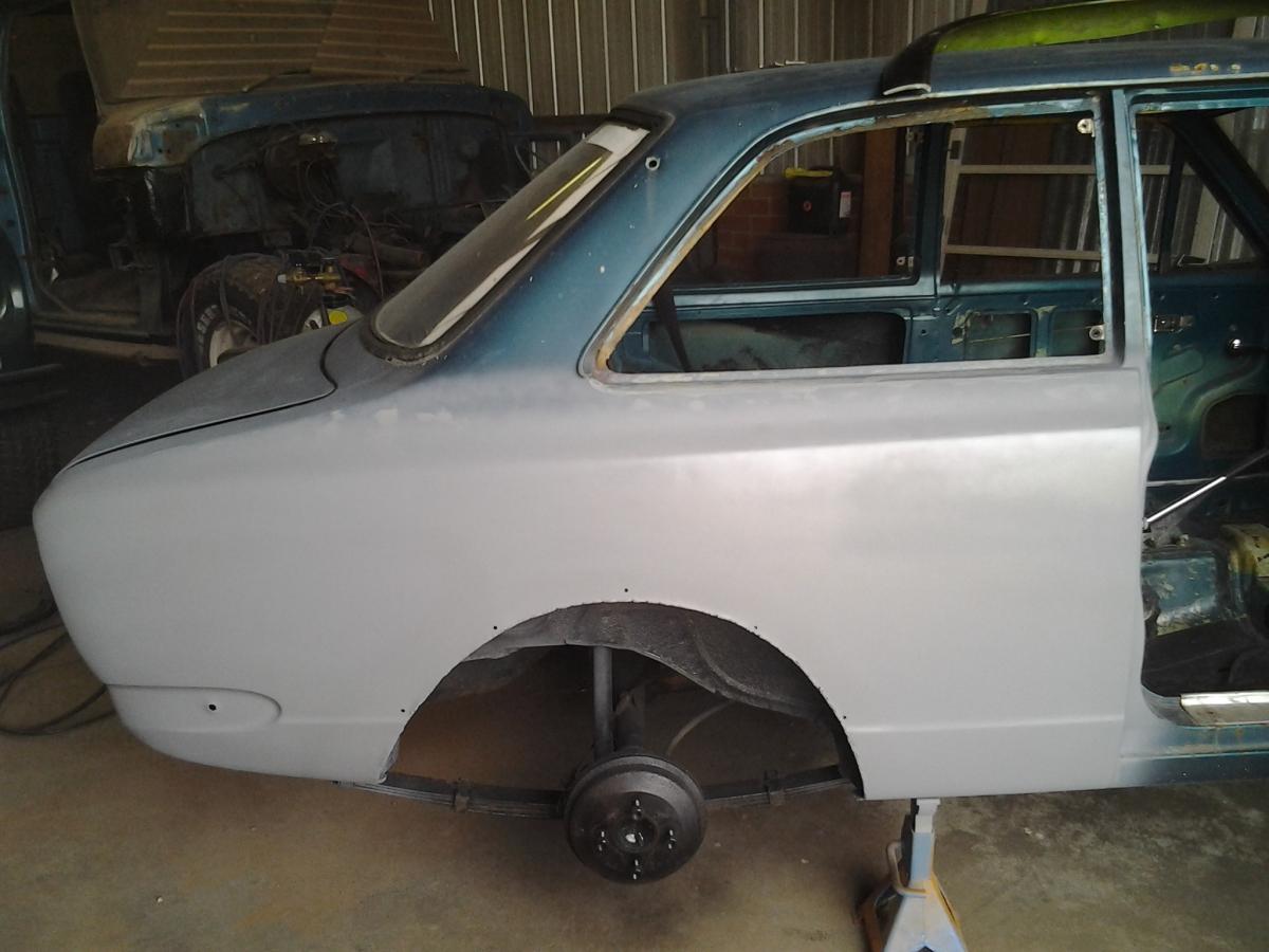

benhachi Posted August 17, 2013 Author Report Posted August 17, 2013 I'm stripping all the goodies out of the orange ke20 and transferring them into the red 25 and the panelvan. I'm really struggling here.. Should I cut the ke25 guards and fit the te27 flares or just leave it as is?? It'll have a 3tgeu it's starting to look like a te27 replica now.. Quote

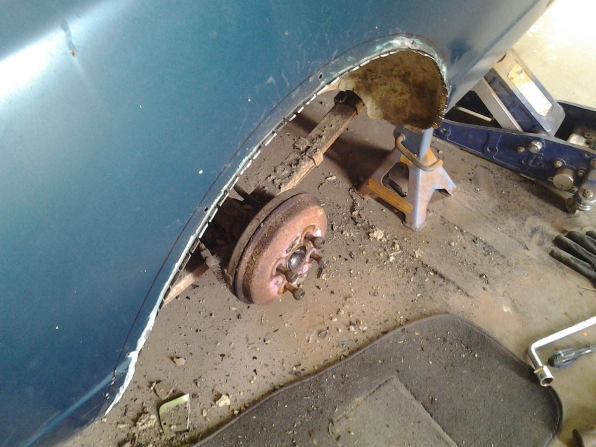

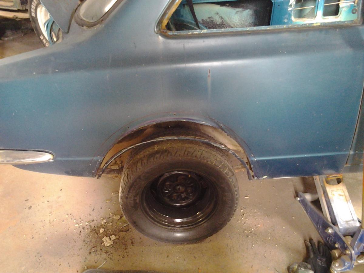

benhachi Posted June 22, 2014 Author Report Posted June 22, 2014 New rolling stock SSR MKII !! Making my own set of flares to put on to cover them. near future plans are 4x114.3 rear diff conversion for new wheels, TE27 Flares, Te27 Ducktail Spoiler, Trueno Tail lights. I've worked out that the engine cross member has moved across about 7mm causing the track and camber to be off so its going up on the hoist soon to get re aligned. now... My dilemma is I'm going to cut the guards for the flares and I want to carefully cut them out in 1 peice so if I want to in the future I can weld them back in and return it to no flares. What would your Tool of choice be to cut them out? Air hack saw? Looking forward to opinions cheers guys Quote

.T. Posted June 23, 2014 Report Posted June 23, 2014 I didn't cut by guards - i knocked the lip flat against the guard & then stretched / shaped the factory steel flare with hammer & dolly to fit under the fibreglass flare - a bit of work to do, but much stronger. i don't know if i have a pic or not... Quote
Feral4K Posted June 23, 2014 Report Posted June 23, 2014 Really depends on how much clearance you require?, We needed to fit a decent size slick under it so went the whole hog, chopped the inner guard a tad less than the outer skin and tapped n welded em back together ( slr torana style) personally seeing as your little beast is so pretty id just lip the guard and play with offset tyre size to get em under it in this shot you can see how i filleted the inner to help get it back to the outer, i didnt add a filler panel, so as it stretched it flattened out the top of the wheel well, without the outer flare bolted on we can fit a 14 x 10 tyre under it no worries. hope this is helpfull. Quote

styler Posted June 27, 2014 Report Posted June 27, 2014 You have to cut the fronts as the front of the car is quite a bit narrower than the rear, the rears you can roll and pump the lip out up to a point or go all the way and cut and shut the twin skin to suit. Internal clearance can also be an issue, check lock to lock on fronts and rears around corners no scrubbing is a ballpark indication its in the clear for that rim/tyre combo. Quote

benhachi Posted October 29, 2014 Author Report Posted October 29, 2014 Not going to cut the guards anymore... look at them they made it this far in perfect condition I'm not about to wreck them Quote
