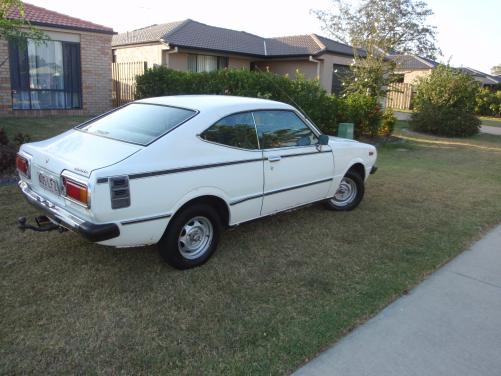

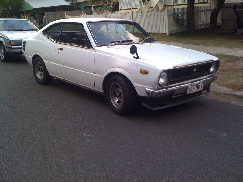

Undertaker_is_the_best Posted October 26, 2010 Report Posted October 26, 2010 (edited) Looking for a place that sells lowering blocks specifically for Corolla rear leaf springs. Yes I have searched and can't seem to find anything but generic ones and I have no idea of what dimensions I need, I know I want to lower it 2-3" but thats all. Also I have heard of rear springs being reset etc ,once again best place for doing it or any suggestions at all cause I reckon the rears are a bit tired and its probably a better option than the lowering blocks. Any help much appreciated. Regards Keith hey Keith with my experience with lowering blocks in a smaller car like a corolla there are not comfortable to use at all the make it a lot stiffer and you can feel every bump best to get the leafs reset like i have in my ke55 coupe i brought mine like that it would be the better of the 2 choices to do my rear leafs are only reset to 2 inch but for the comfort and look of the car it works a treat i have attached a pic for you to look at what mine sits at and i borrowed a pic from PHATKE30's pics just trying to compare the stock with the 2 inch lower and yea there is a difference Edited October 26, 2010 by Undertaker_is_the_best Quote
