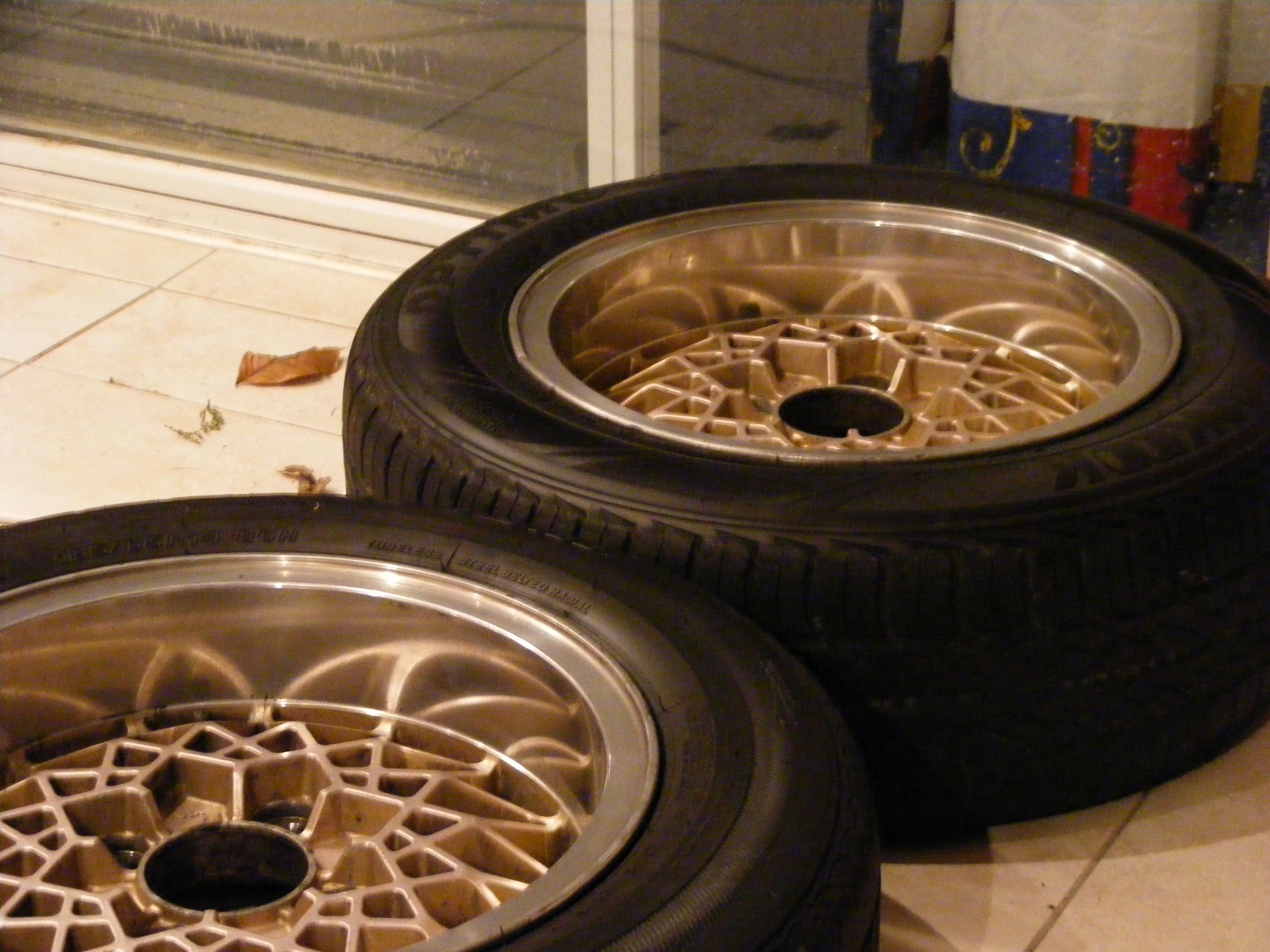

dfunkt Posted May 20, 2008 Report Posted May 20, 2008 The dish is of no use lying on the floor teddy... Quote
