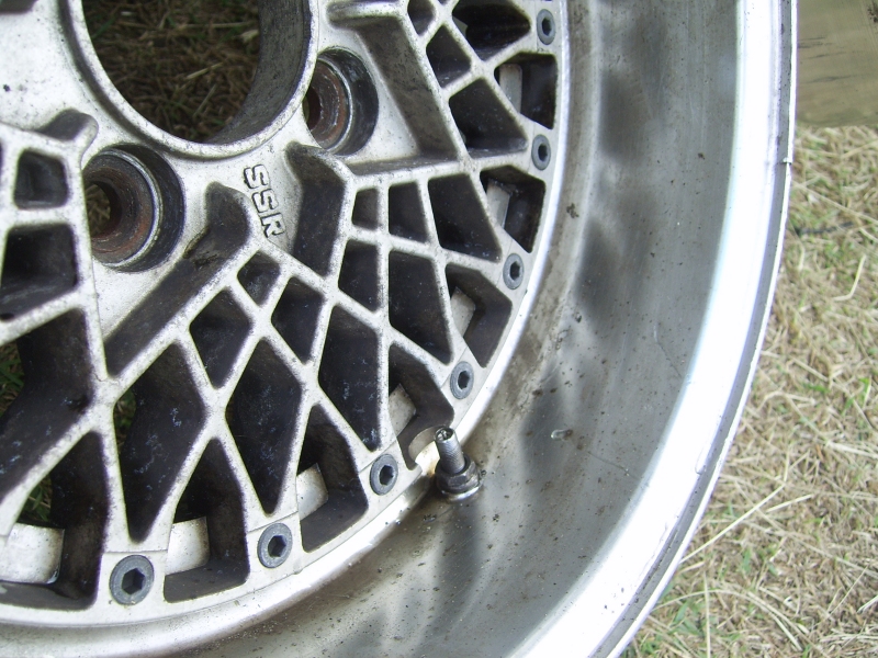

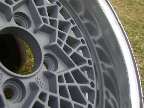

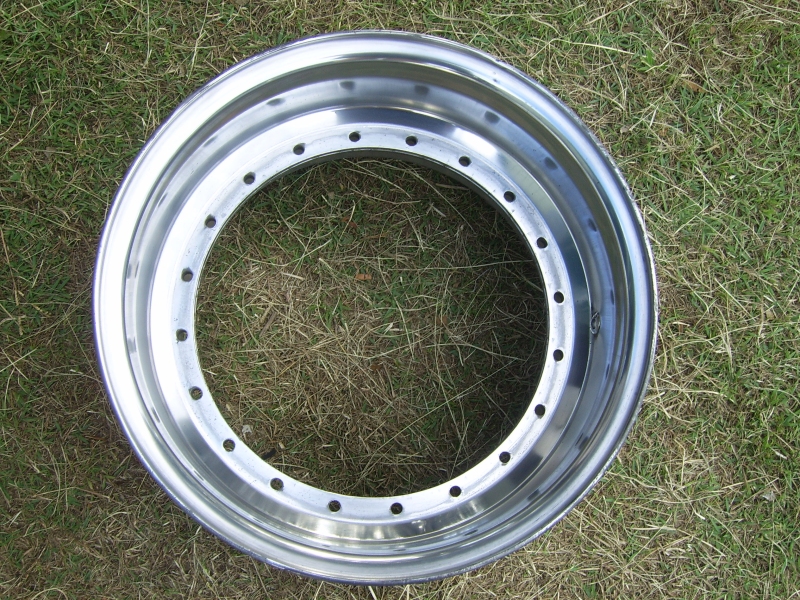

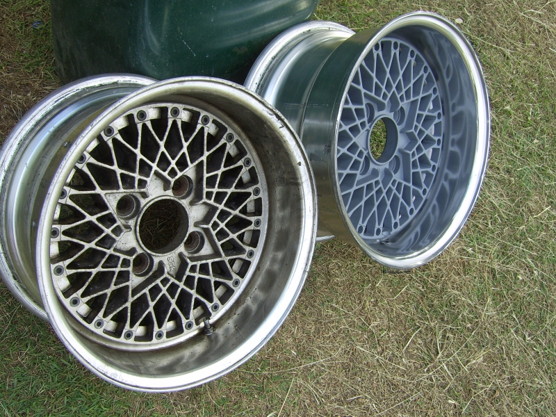

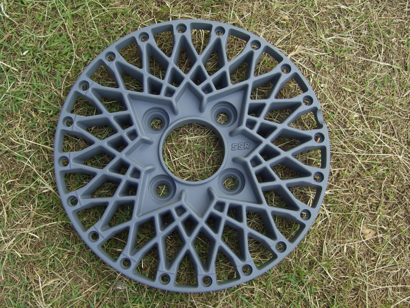

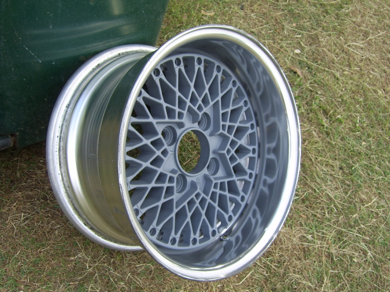

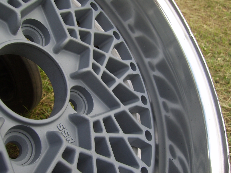

Medicine_Man Posted April 19, 2008 Report Posted April 19, 2008 Some photos of the progress of one of the SSR Mesh rims, Sanded off the clear coat with 320 grit sandpaper, Then 1200 grit sandpaper, Then Autosol and a buff they came up a treat... Also sandblasted the center of one wheel and etch primed it so teddy can get that painted during the week.. Quote
sixsixone Posted April 19, 2008 Report Posted April 19, 2008 Some photos of the progress of one of the SSR Mesh rims, Sanded off the clear coat with 320 grit sandpaper, Then 1200 grit sandpaper, Then Autosol and a buff they came up a treat... Also sandblasted the center of one wheel and etch primed it so teddy can get that painted during the week.. Lookin sweet, any hints on what colour? Has it been stated before? Quote
Teddy Posted April 19, 2008 Author Report Posted April 19, 2008 a Darkish blood Gold for the middle :dance: Quote
