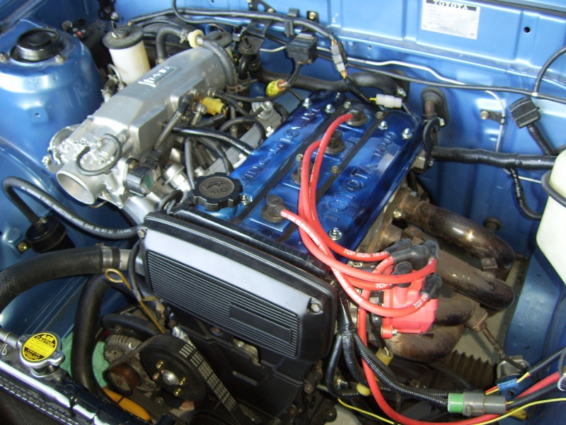

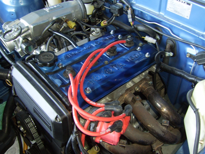

Teddy Posted March 1, 2008 Author Report Posted March 1, 2008 Ok, movie(s) to come of blue car ! - removed fuel filter from engine bay, removed pipes. Made custom bracket and rubber insulator for fuel filter, painted bracket black. Mounted fuel filter, and lines in correct positions. Also installed final 2 fuel pipe / brake pipe clamps onto body. Still not 100% happy with the angle of the feed line from under fire wall to fuel filter. Will tweek again next weekend. - mounted MAP sensor - cleaned up, painted cam gear cover and water pump / middle plastic cover. Filled out and stuck on timing belt replaced at sticker. - Wiring to mirrors is all done, bar putting the power wire on. Putting it into the back of the ciggy lighter circuite, and upping the fuse. They work well :D - bell housing bolts installed by majic pixy that lives on mexican cheeze and argon-gas - wiring installed over top of motor, fixed up - wiring cleaned up more under dash, (ECU stuff) - Tested handbrake light - Ran vehicle to get timing and TPS set. Motor making a weird squeeling noise.. later found out by tony that its most likely the timing belt being done up too tight. Will de-adjust asap. Motor runs so nicely :hmm:. Sump plug has a leak. *><* :wink: Quote

Medicine_Man Posted March 2, 2008 Report Posted March 2, 2008 Teddy at home under the car.. Few pics of the cam/cam gear covers on.. Quote

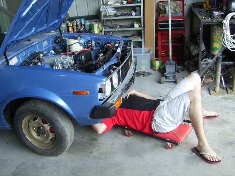

love ke70 Posted March 2, 2008 Report Posted March 2, 2008 that car is obviously not low enough if you can get under it on a trolley. and get them steelcaps on, you'll get more done :wink: Quote
Medicine_Man Posted March 2, 2008 Report Posted March 2, 2008 love ke70 said: that car is obviously not low enough if you can get under it on a trolley.and get them steelcaps on, you'll get more done :wink: It is on stands, Just an optical illusion and he is wearing his aussie steel caps... Quote
