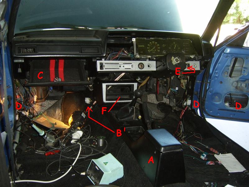

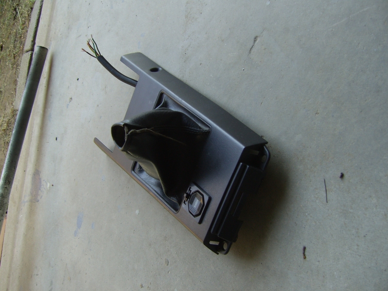

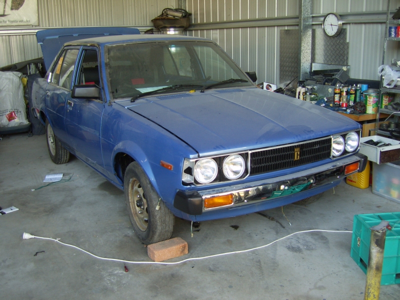

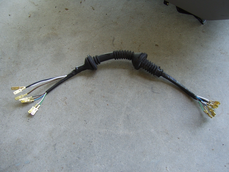

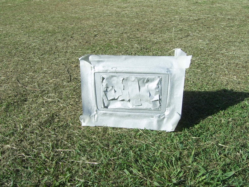

Teddy Posted February 24, 2008 Author Report Posted February 24, 2008 Oh yeah its deficiently looks like a 90's hot 4 special. Catch is, theres no rice in this ride :jamie: Picture Time :P Mirror switch and wiring, before the plug installed Random outside shot. Note dust and bonnet in need of adjustment Door stuff. All nicely new lookin Ae102 rear door rubbers with our loom through it. Note its this big, because of the amount of wiring going through such a small gap, when the door is closed it crams the wiring up badly, so I'm expecting these to fail within 6 months. Loom size is this big so that its removable and easy to replace. Making her silver Note ignition light :no2: A - Center glove box has a light, connected into park light circuit B - Mirror switch and wiring C - Glove box, that I'm proud of. lol. Those red stripes took hours to custom do. Getting a light, switch neg earth'd, when glove box open - light comes on. have not looked into what circuit to hook that into yet.. Wont be like a VN commodore tho.. car off and light could stay on. When car is off / locked, its off ~ period. D - Loom wiring into doors, and wiring in door(s) E - Ign. Light, operated when doors open, and will soon have (along with all other courtesy / feature lights - fading function) F - Cup holders from either 07 hiace, 05 triton or 02 hilux. Hymm. :y: Its going really well. Alarm system is now almost fully functioning. Quote

Jason Posted February 24, 2008 Report Posted February 24, 2008 O the soldering iron in the foot well, how i know you so... :P Quote
7shades Posted February 24, 2008 Report Posted February 24, 2008 CUP HOLDERS!!!!! One thing the dear old kesev has always been lacking... Where ya gunna stick em, ted Quote
7shades Posted February 24, 2008 Report Posted February 24, 2008 Ah right. I had some from a Hyundai Sonata inlaid into the plastic strip above the glovebox. One of those half-din push and two holders slide out and drop down all smooth and sexy type ones :P Quote
Teddy Posted February 24, 2008 Author Report Posted February 24, 2008 ooo got any pics? & nup, its an Rt142 corona light. Quote

goldke70 Posted February 26, 2008 Report Posted February 26, 2008 F - Cup holders from either 07 hiace, 05 triton or 02 hilux. Hymm. :y: Try Hilux 95 year model, Which probably means that 90-96 had the same ones also.. Should be just about the right size for that gap.. I'm pretty sure it was about half din size and spring loaded as well, I will look for a photo for ya.. ..Was the best feature about my hilux :P Love this build-up :jamie: Quote
