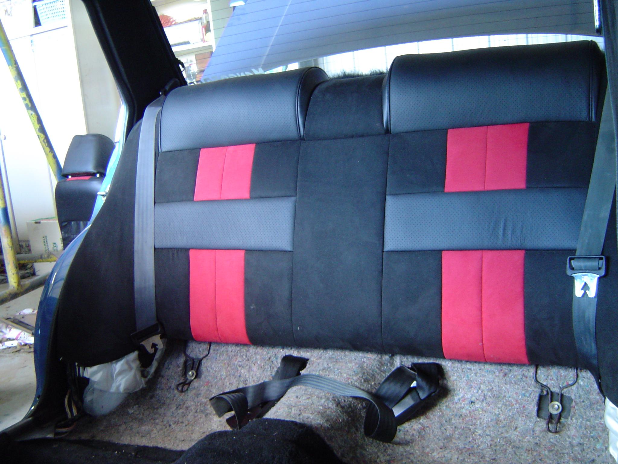

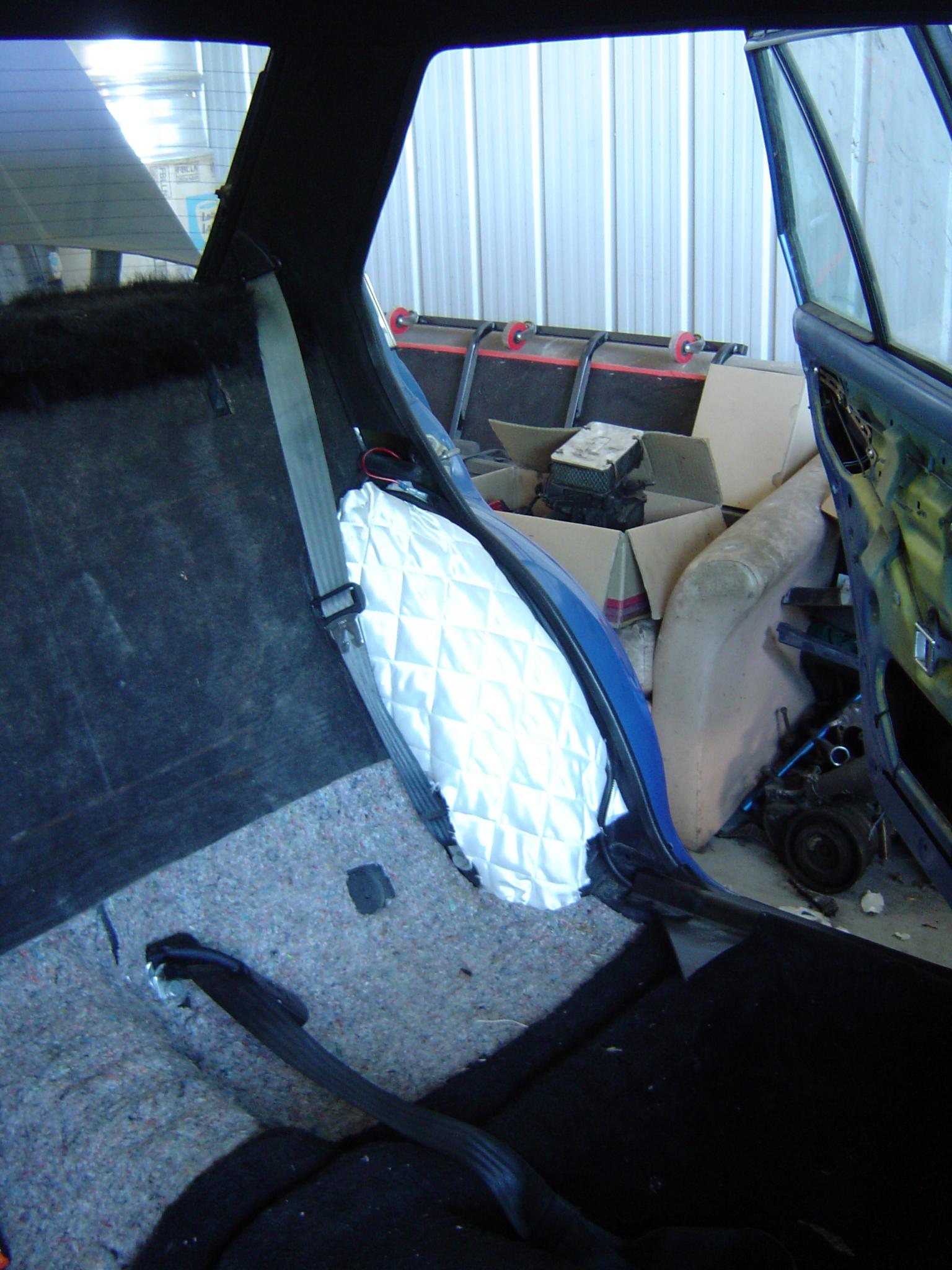

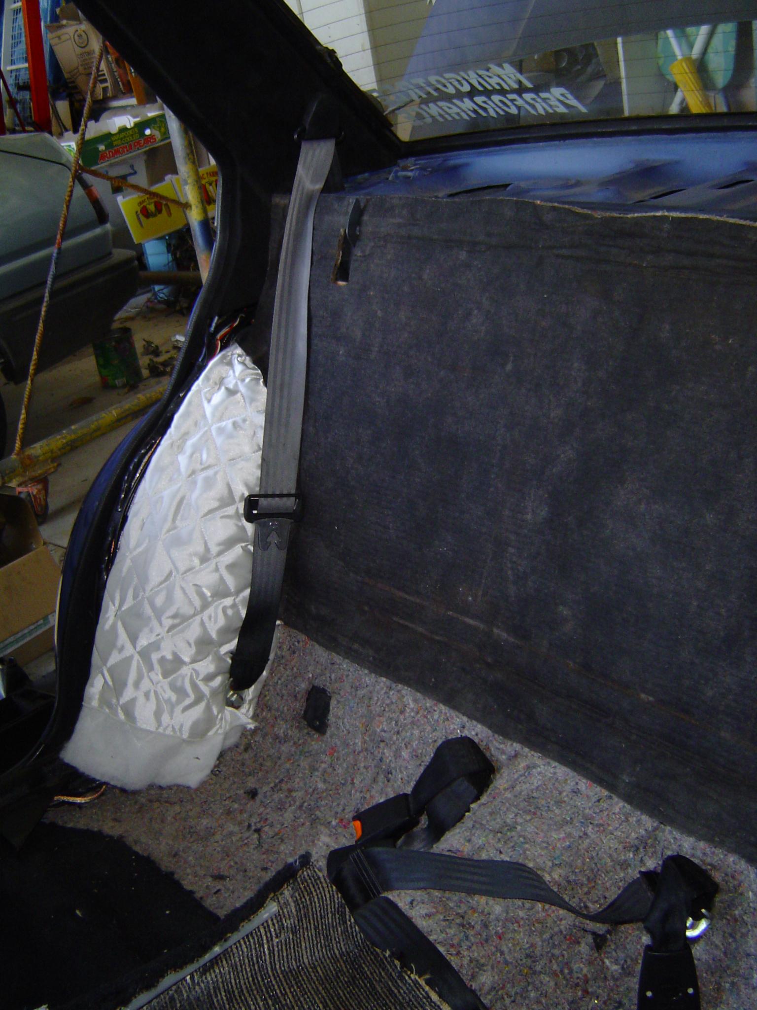

- Found all nescessary bolts and things, and correct belts (again) for car. Took a while to get all the right bits, as theres a few different spacer tube-washers for the belts (belt tight, but buckel can still freely move). Anyway, Managed to put all that together. Rear now has retractiable belts :) W00t. Took long enought to clean the belts, yuck to years of grime and crap.
- Once belts in, covered rear wheel arches on inside in bling-soft material for sound deadening, so the seats don't rub. Velcro'd them into place, and double sided the material for extra nice-ness. Chucked rear shelf in (pimp-spec fur :(), and then FINALLY installed rear backing board and rear seat. Got tight fit? Looks nice now atleast.

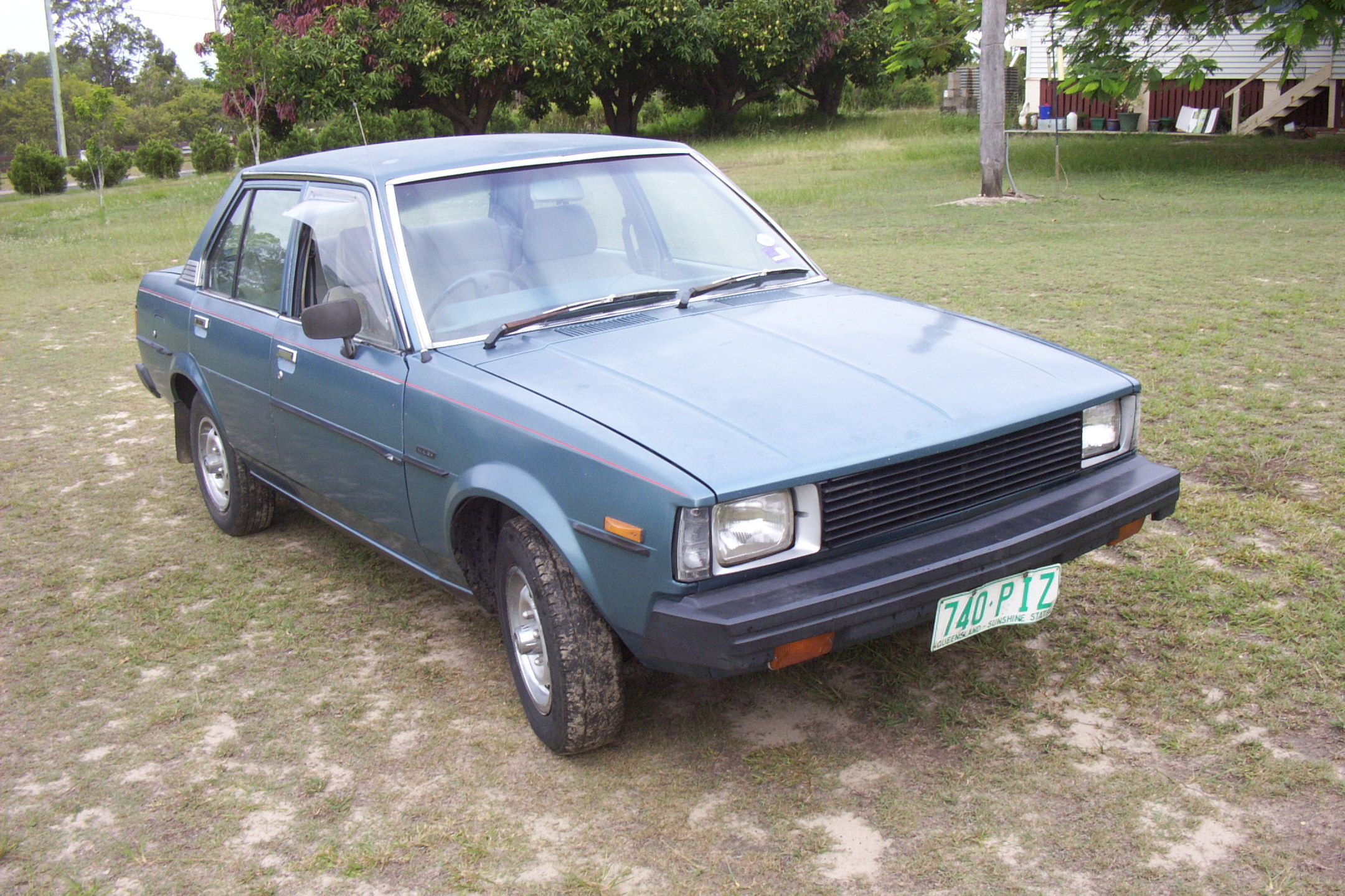

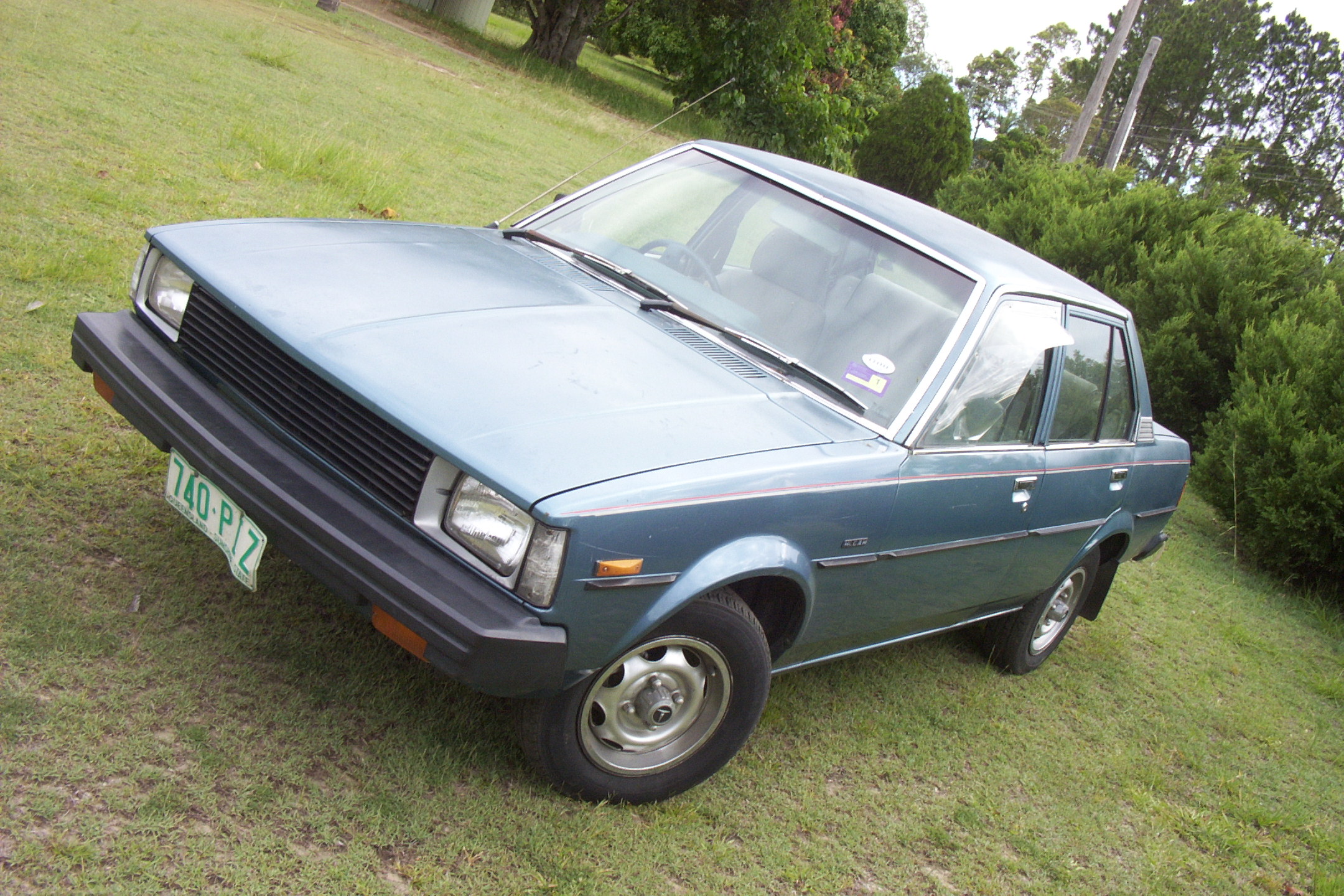

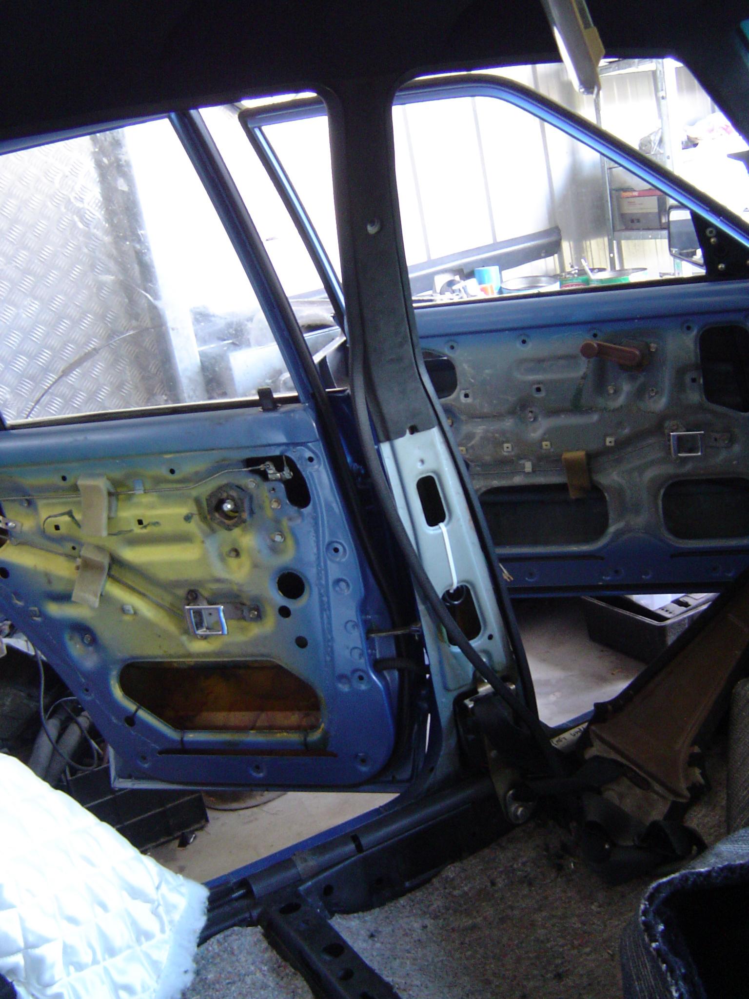

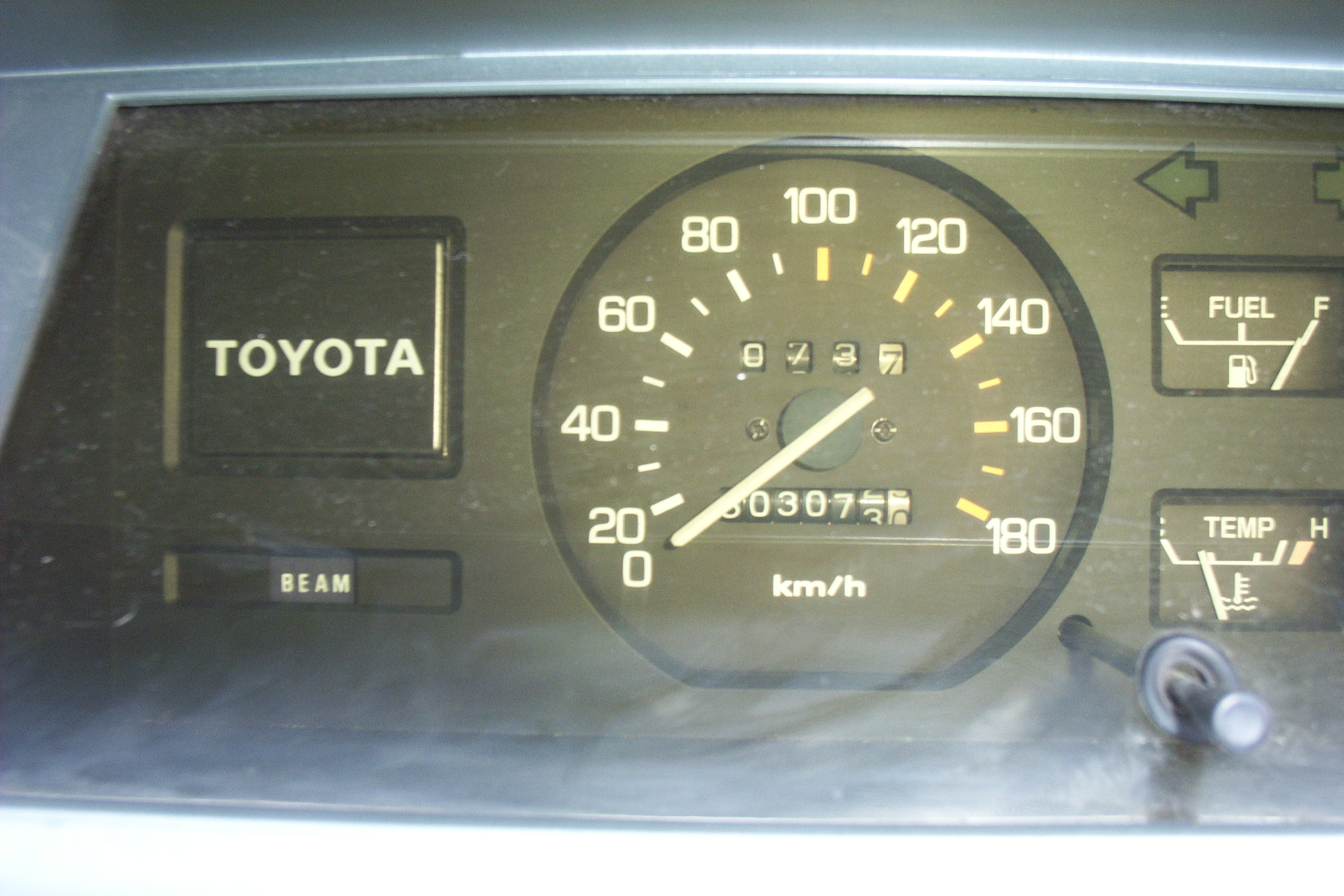

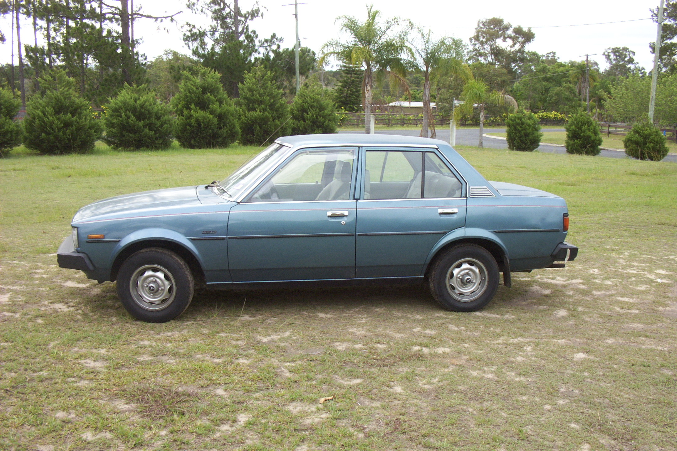

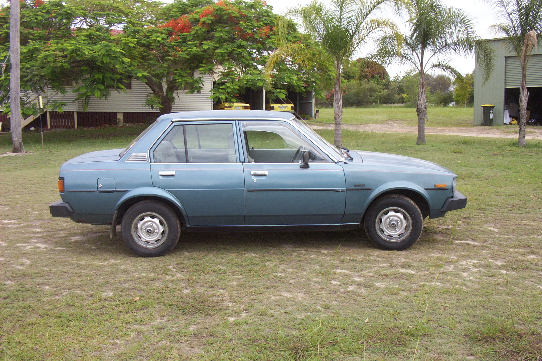

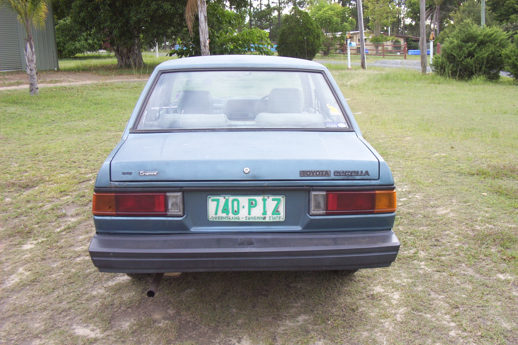

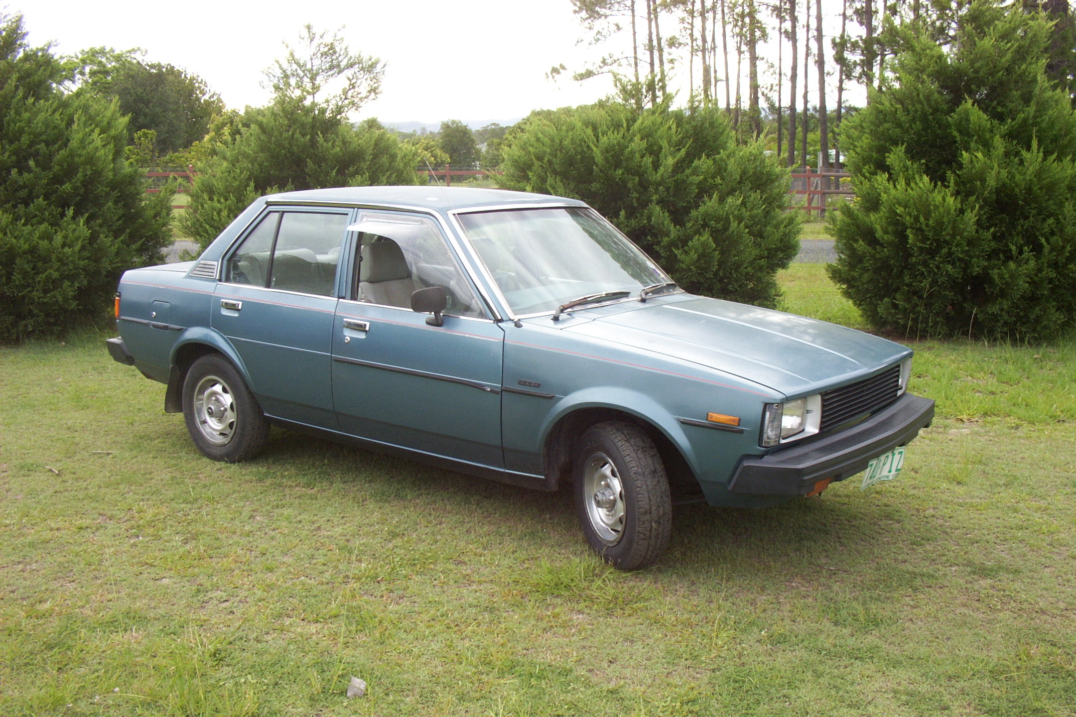

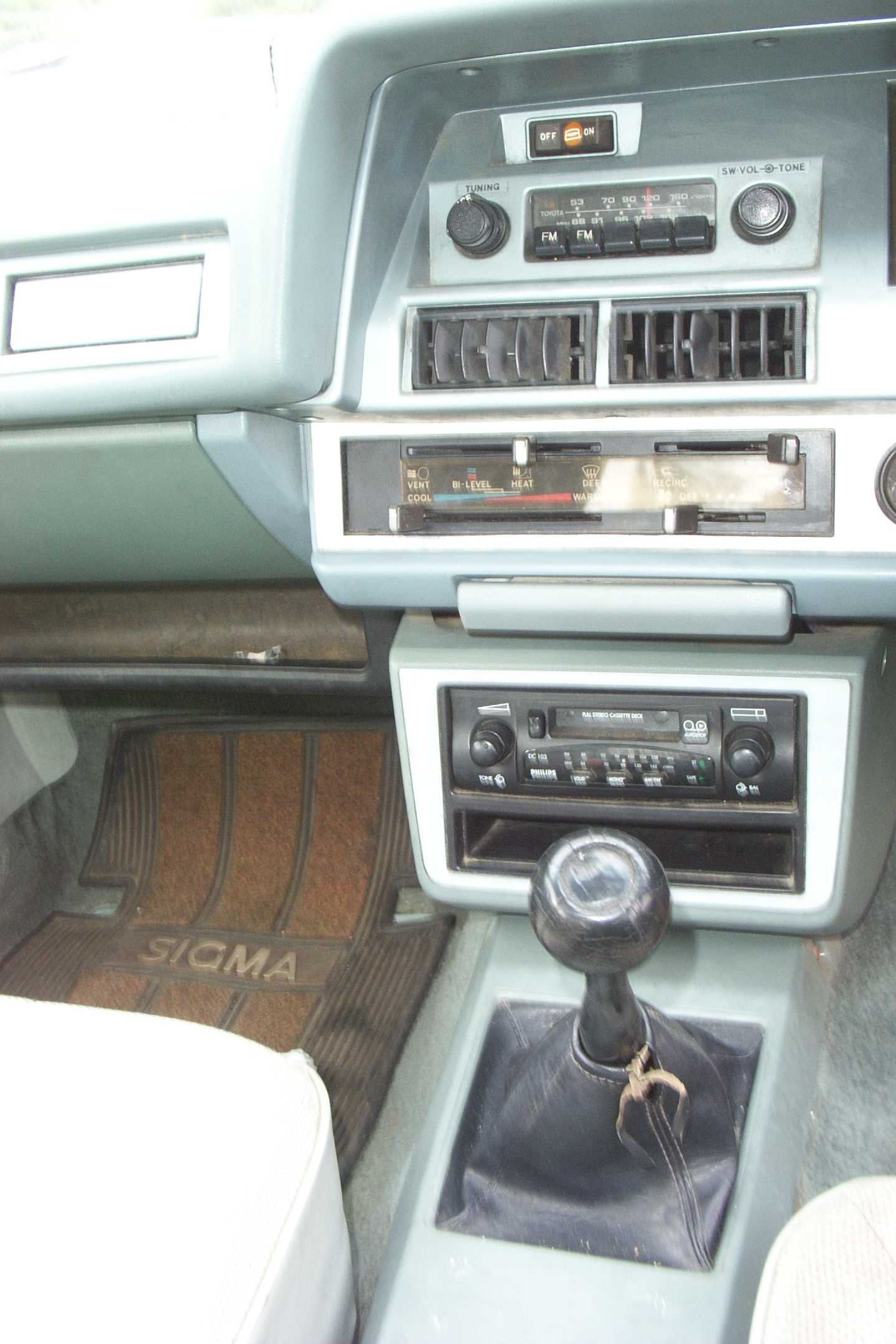

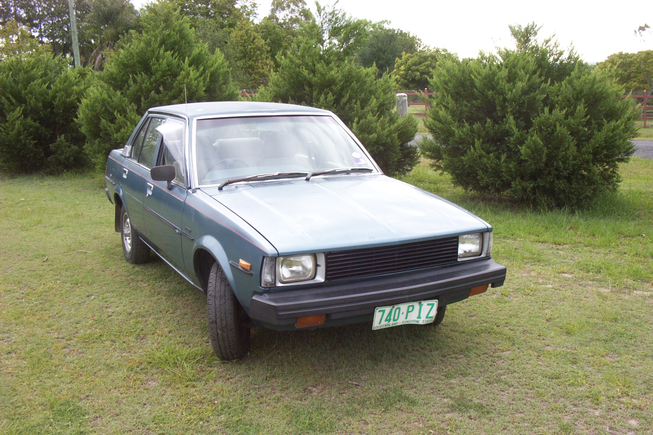

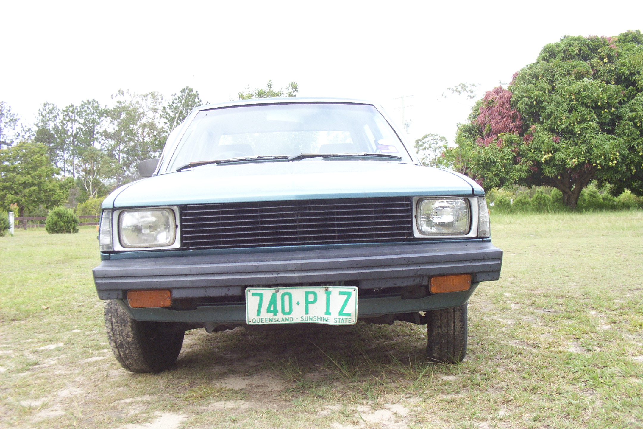

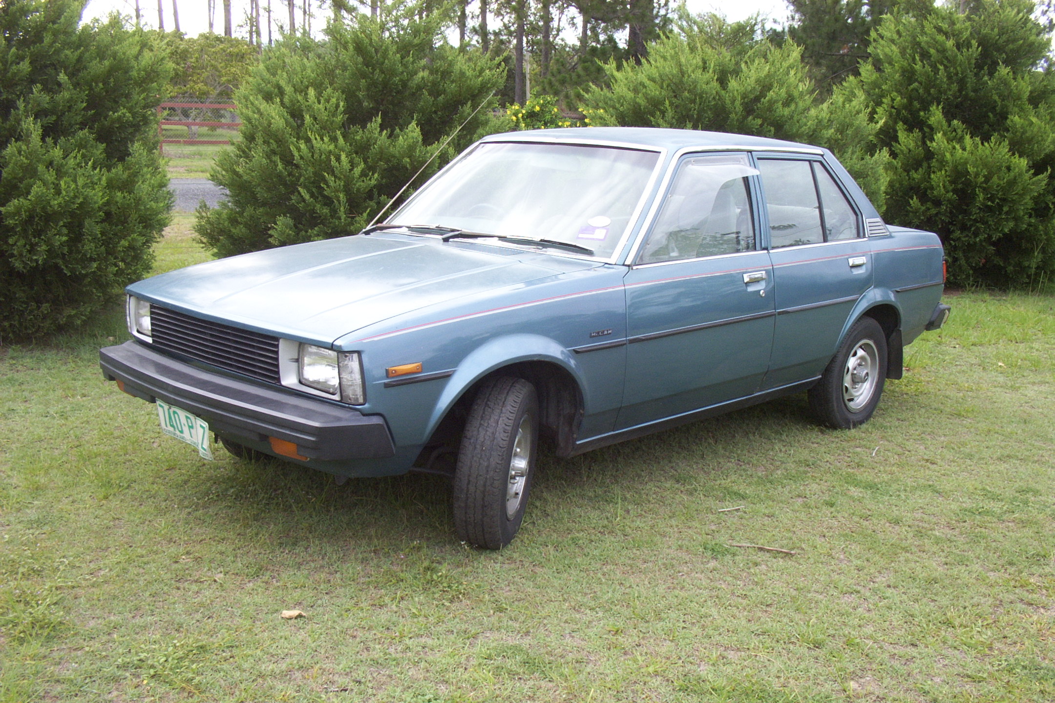

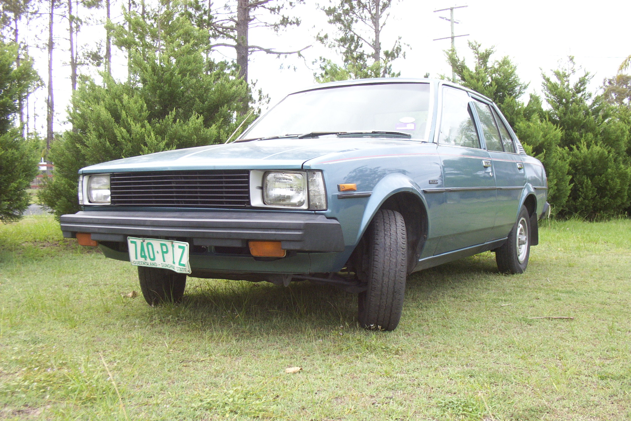

For History purposes, i have found some pictures when the car was first put into the shed.
December 2002 is when it rollered into the shed.
oh dear god.. its been a while. That means the car has been in a shed for a 1/5 of its life. lol
Enjoy :fuzz:
