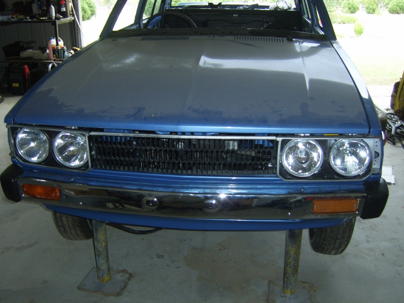

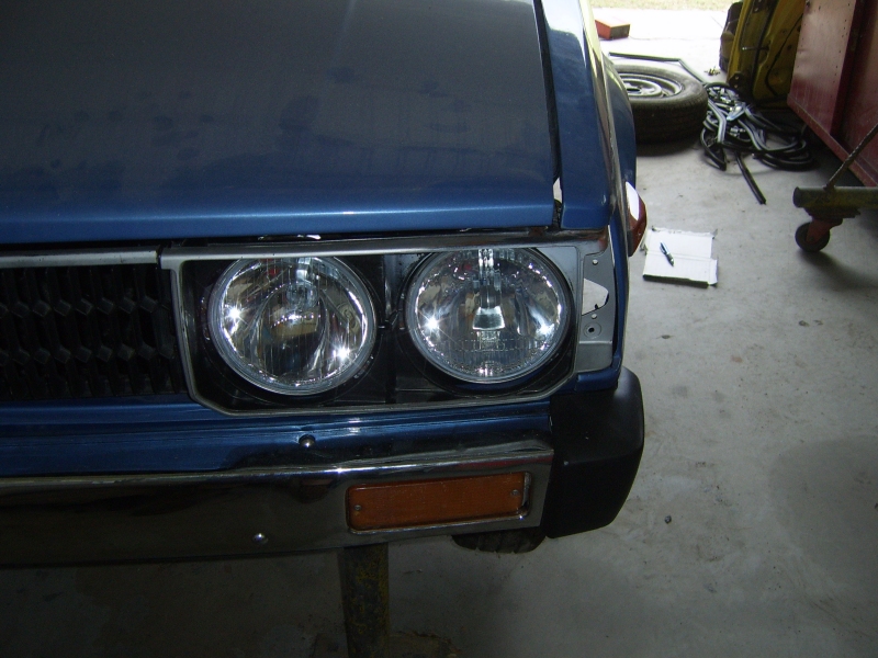

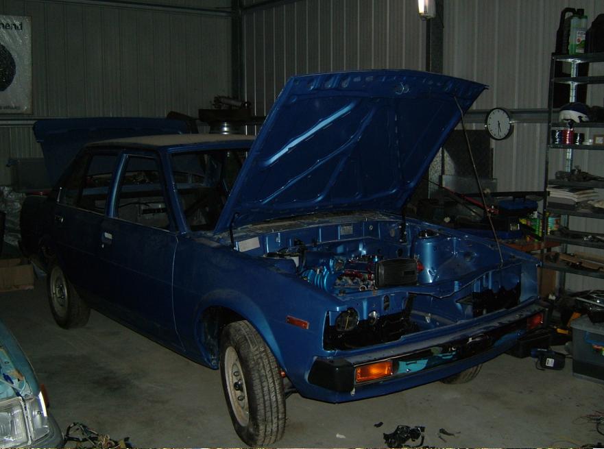

Medicine_Man Posted June 3, 2007 Report Posted June 3, 2007 New Hella lights went in on Saturday, Some slight modification needed to fit the inners. Accelerator cable is now back in place. Front wiring harness went in as well, also started cleaning up the air blower assembley. Quote
ancullen Posted June 4, 2007 Report Posted June 4, 2007 LOVING that twin-headlight and chrome bumper front end. So much better than the AE71 front, and it gives the impression that the car is wider than it actually is. Quote

Medicine_Man Posted July 25, 2007 Report Posted July 25, 2007 Yeah, Not much has been happening lately, Been trying to get the wiring sorted and ran into a few dramas. Hopefully this weekend will see some more work going into the old girl.. Quote

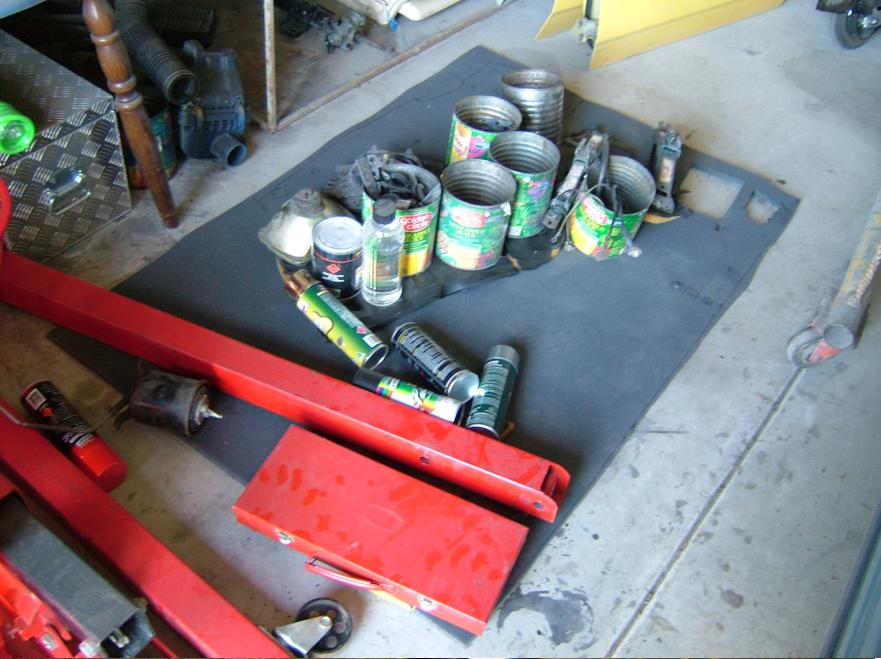

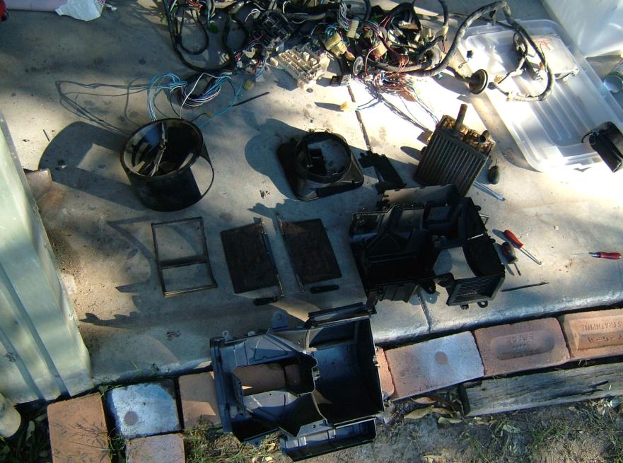

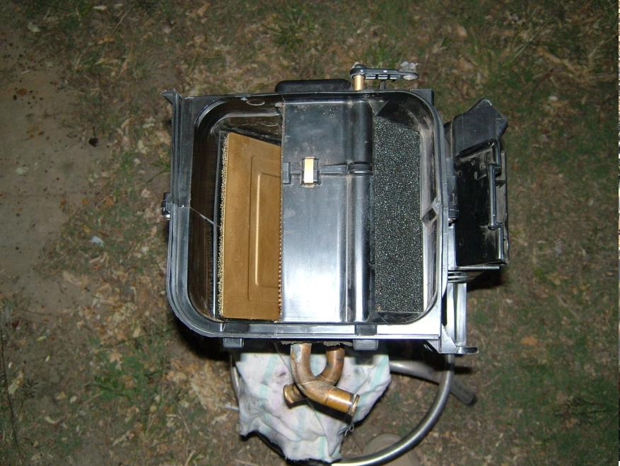

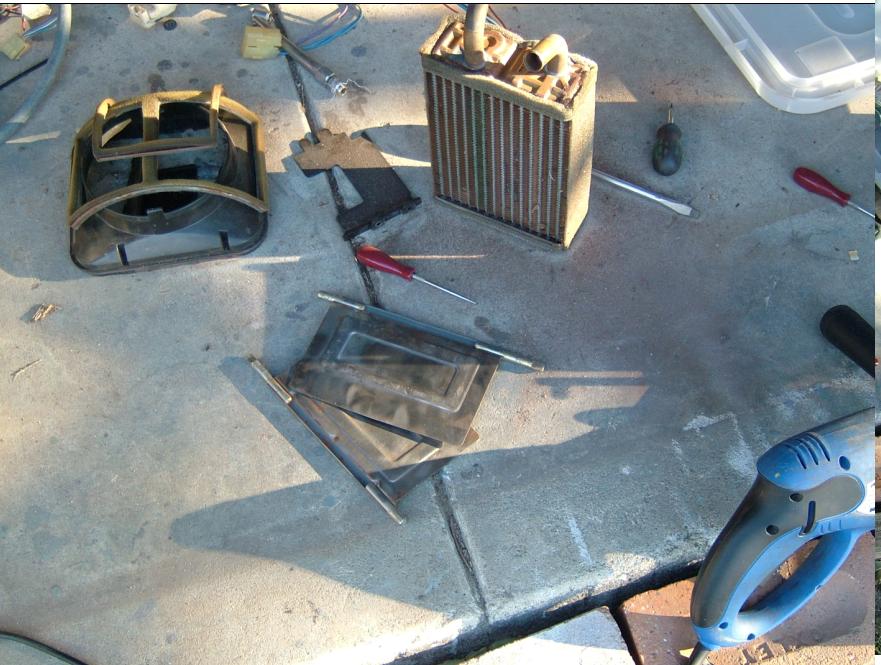

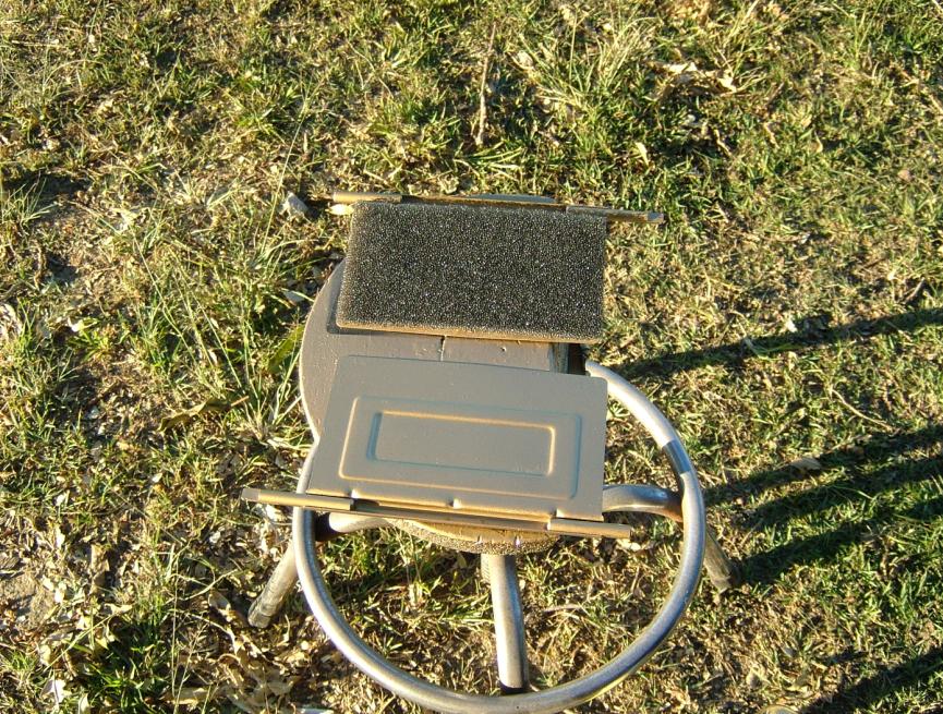

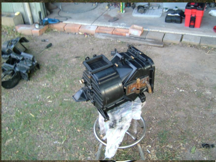

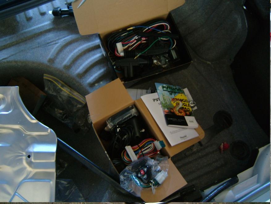

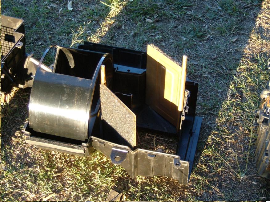

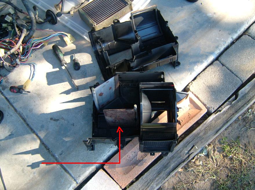

Teddy Posted July 29, 2007 Author Report Posted July 29, 2007 Due for an update, ey ? :D 1) Heaterbox - Stripped out, cleaned, washed, etc. No more dust - Removed and cleaned all old seals, foam, sealant. - Removed all clips, cleaned, Sanded & Painted *scratches head - what colour would look different - Gold Chrome ! ! * - Removed heater flaps, Wire wheel'd, Grinded, Down back to metal. Sprayed Chrome Gold - Cut new Flap foam, Glued on. Put new foam rubber seals on where applicable. - Re-Assembled box, Re-Aligned heater flaps. Adjusted - Blew out, Cleaned out core. No leaks found. Re-Assembled into box. - Box now re-co'd ! 2) Found original un-broken / sundamaged fire-wall matting. - Tested on car, still OK - Removed, Striped rubber from foam. Re-Glued with new contact adhesive. Left to dry. Installing Next weekend 3) - Alarm & Central locking kit :y: - See Pics. Justin had wiring harness striped out, testing all wires. Few electrical.. ugh.. problems. Ill let him do the talking haha. Quote
lappy Posted July 29, 2007 Report Posted July 29, 2007 Central locking is great best thing I did keep up the good work boys Quote
