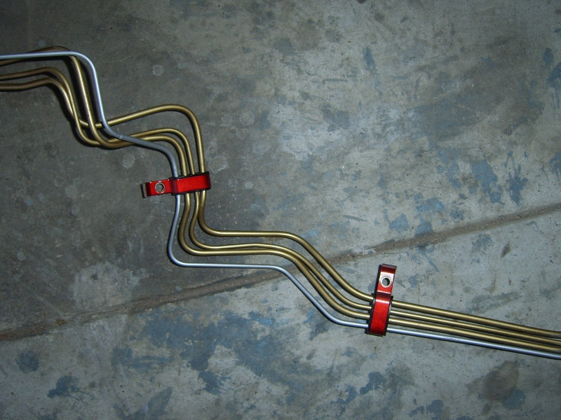

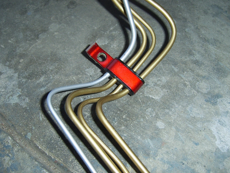

theres a good silver called GM steel wheels. its a good reflective silver, i used it on the frame of my TA22 lights.

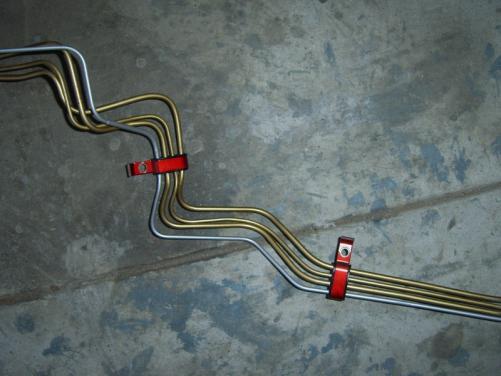

Yup, its lookin so good. Did you get a good shot of both lines together?
