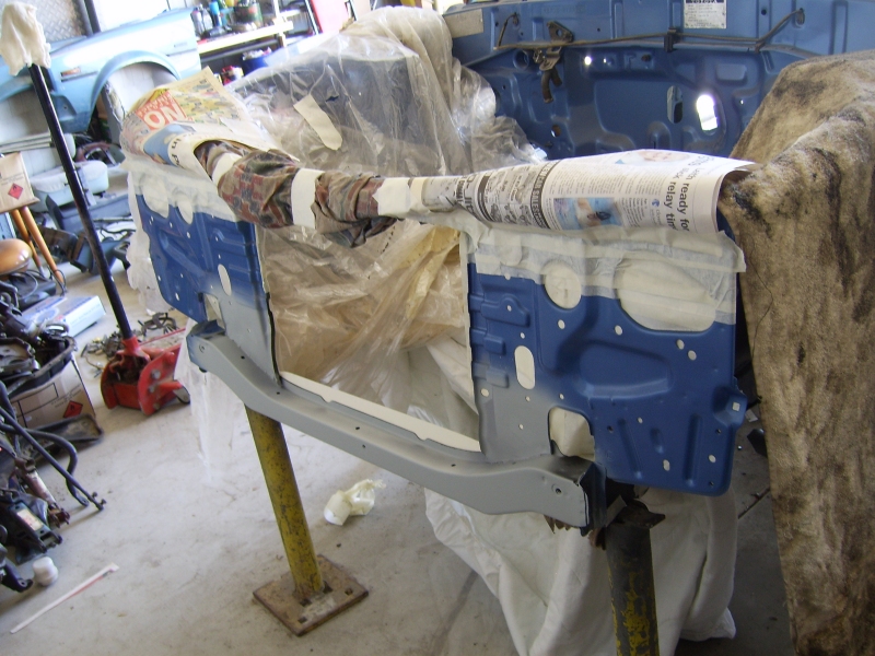

Medicine_Man Posted September 24, 2005 Report Posted September 24, 2005 Waiting for Matt to show up this morning, I decided to finish off painting the front end, masked it all up ready for blacking out.. Quote
