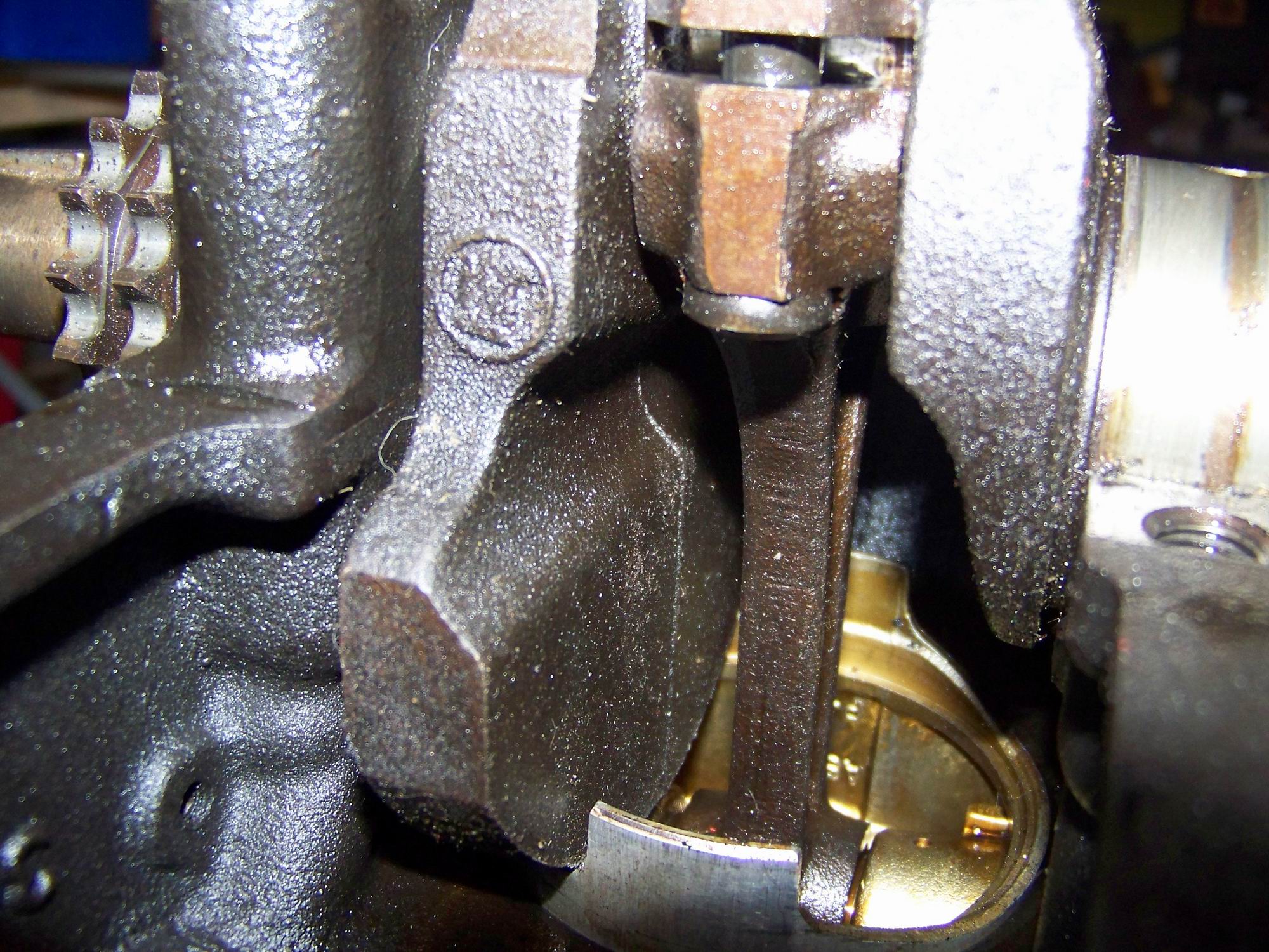

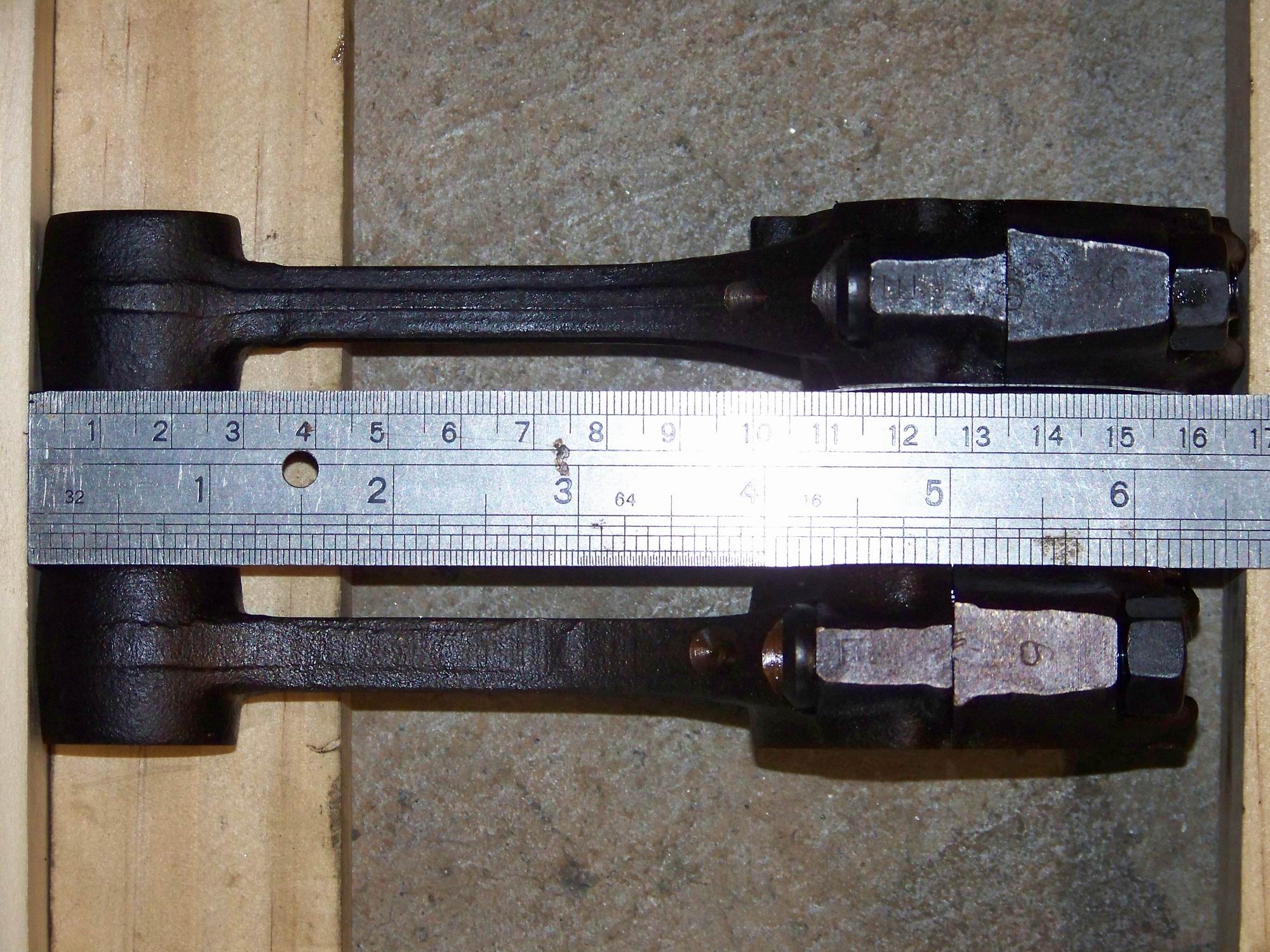

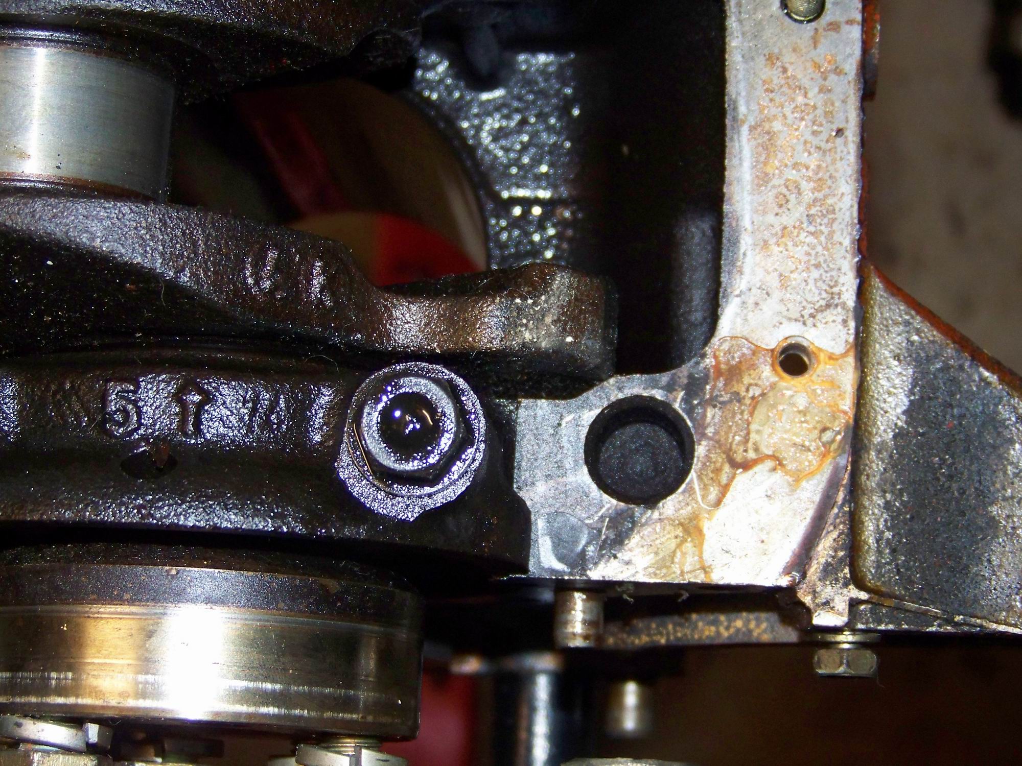

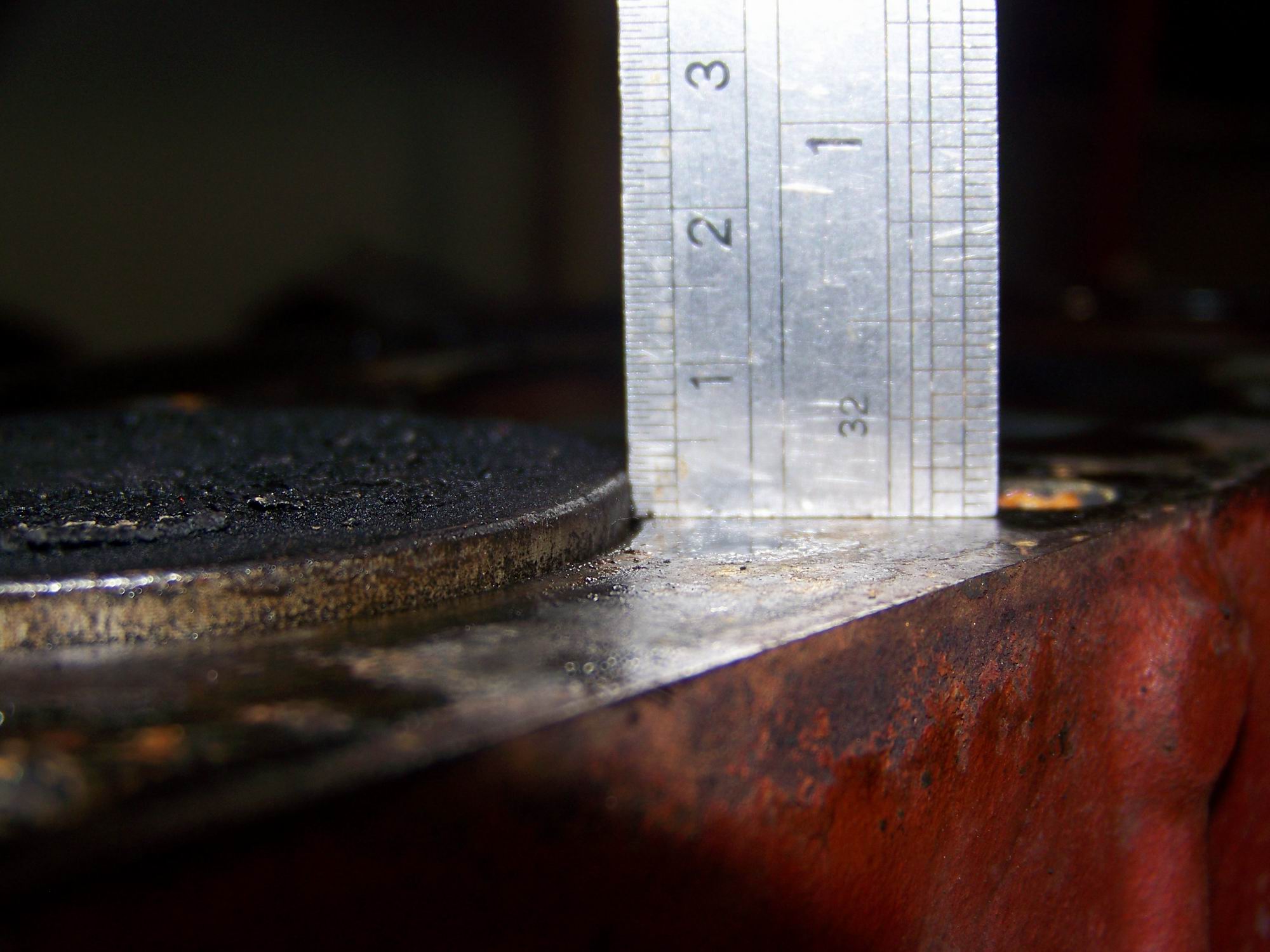

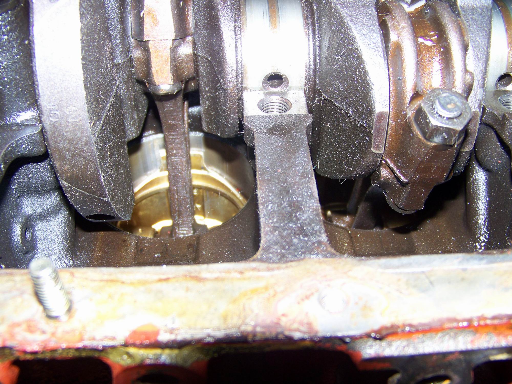

towe001 Posted October 10, 2010 Report Posted October 10, 2010 Pretty possible, all it'll need is either different rods or pistons. 3k-h block, rods and pistons fitted to a 4k crank. 4k rod at the top 3k-h at the bottom Back of the block Counter weight hits the piston towards BDC. As can be seen the rods cap can't be fitted Past that point the cap can be screwed down. But around the half mark number one rod jams up on something. I'm not sure what it is can't see anything hitting Piston sits about 3mm proud 1 Quote
GJM85 Posted October 10, 2010 Report Posted October 10, 2010 Using a 4k crank and 3k rods it could be as simple as having the crank lobes machined down a few millimetres and use shortened pistons. You could call it a 3k stroker kit. Quote

GJM85 Posted October 10, 2010 Report Posted October 10, 2010 Could but i'd think it'd defeat the idea of running the 4k crank but. Unless your talking about the counterweights. But i'd sooner just do the pistons. Should be able to find some 75mm bike pistons yeah i mean the counterweights... they contact the piston sleaves and a shorter piston may not rectify that issue. Quote
