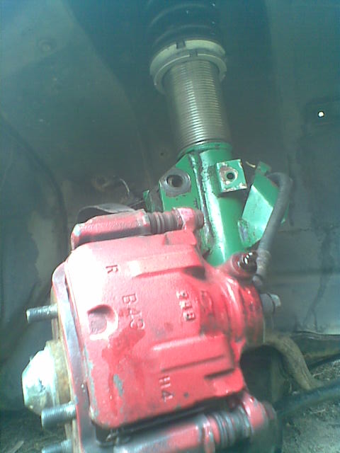

SLW42 Posted September 20, 2010 Report Posted September 20, 2010 (edited) they can be whatever tickles your prickle :cool: but IMHO why waste the time with springs and shocks :P, when coilovers are so much more awsome hahaha :P here is a pic of my setup s13 everything except the castor arm, sway bar and the strut tops which are stock ke70 Edited September 20, 2010 by SLW42 Quote
