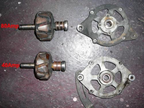

Evan G Posted September 18, 2010 Author Report Posted September 18, 2010 drop me a pm if your having troubles, don't forget the longer stator bolts! Quote
towe001 Posted September 18, 2010 Report Posted September 18, 2010 On 9/12/2010 at 9:25 PM, Hiro Protagonist said: Funnily enough, this has been in the FAQ for some time (although I don't recall the VL reference being there all the time) Rollaclub FAQ - K-series alternator True, but there's no write-up of how to do it. Its just a tiny Quote However, here's the beauty part. Bosch design all their alternators with the same rear housing, just with different front housings to suit the motor they are intended for. So you can buy yourself a 60A Ford Falcon alternator, or an 80A VL Turbo alternator, and rebuild it with a Bosch KE front housing and longer stator bolts, and whack it straight onto your K motor. If you want to underdrive the alternator (say you're bulding a big-rpm race motor) use a Mitsubishi Sigma front pulley. bit of what you do. Its a good write-up. You get my rep Mr E :jamie: Quote

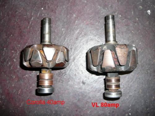

Evan G Posted September 18, 2010 Author Report Posted September 18, 2010 (edited) On 9/18/2010 at 10:14 AM, towe001 said: True, but there's no write-up of how to do it. Its just a tiny bit of what you do. Its a good write-up. You get my rep Mr E :jamie: However, here's the beauty part. Bosch design all their alternators with the same rear housing, just with different front housings to suit the motor they are intended for. So you can buy yourself a 60A Ford Falcon alternator, or an 80A VL Turbo alternator, and rebuild it with a Bosch KE front housing and longer stator bolts, and whack it straight onto your K motor. If you want to underdrive the alternator (say you're bulding a big-rpm race motor) use a Mitsubishi Sigma front pulley. in the FAQ it just tells you to change the front cover over to the vl alternator, THIS IS FALSE!, all the vl internals must be fitted in the corolla shell Edited September 18, 2010 by Evan G Quote
