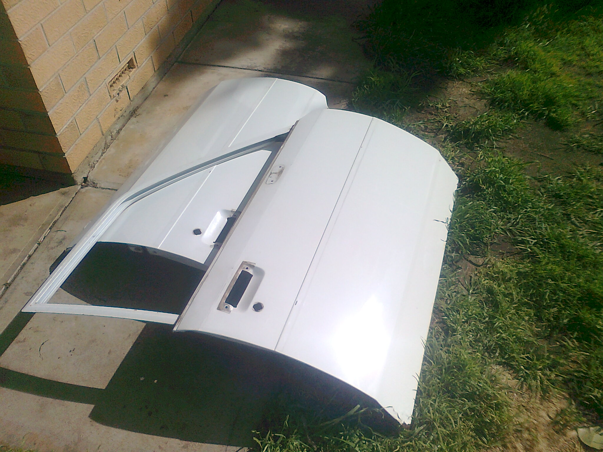

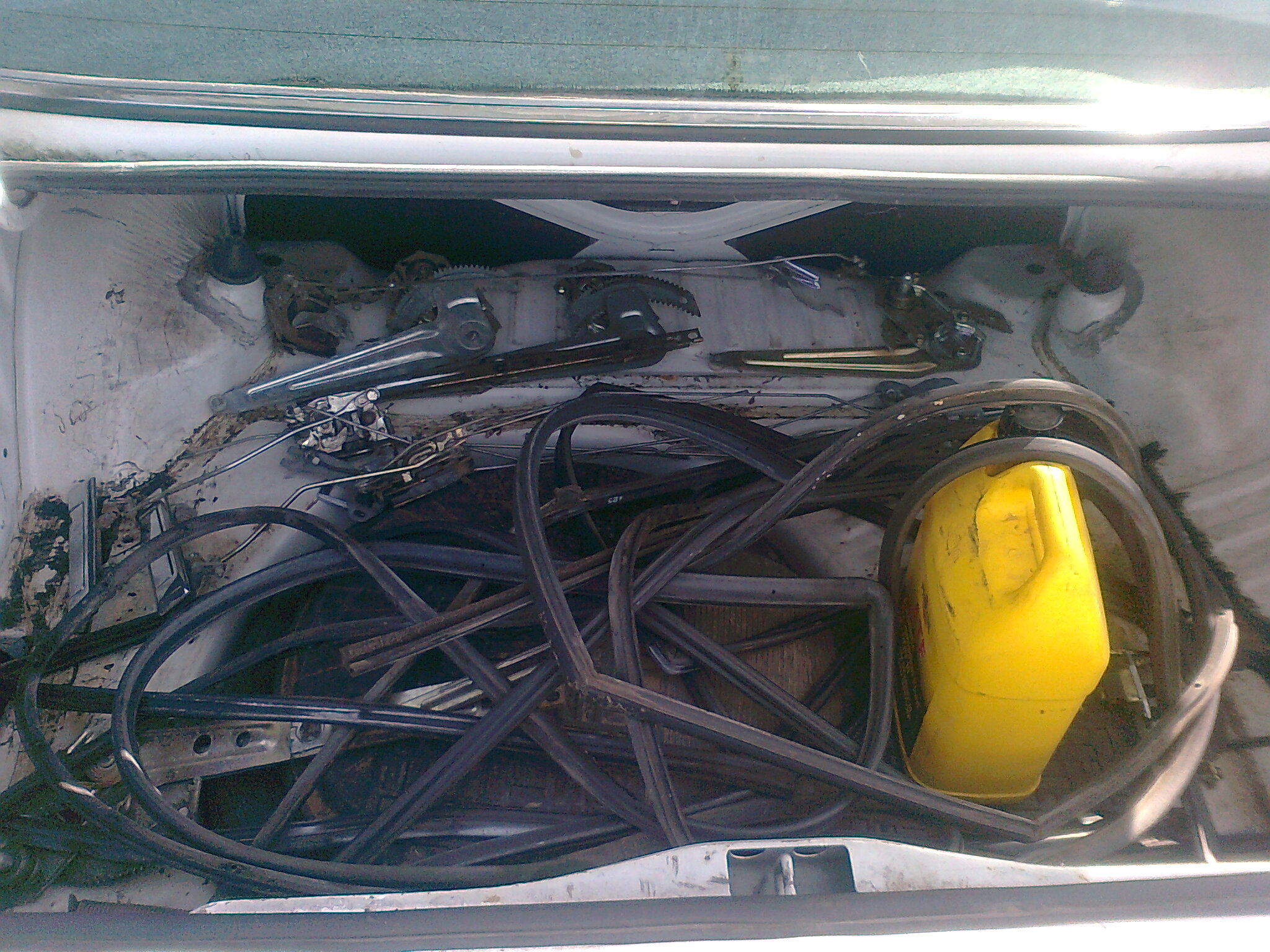

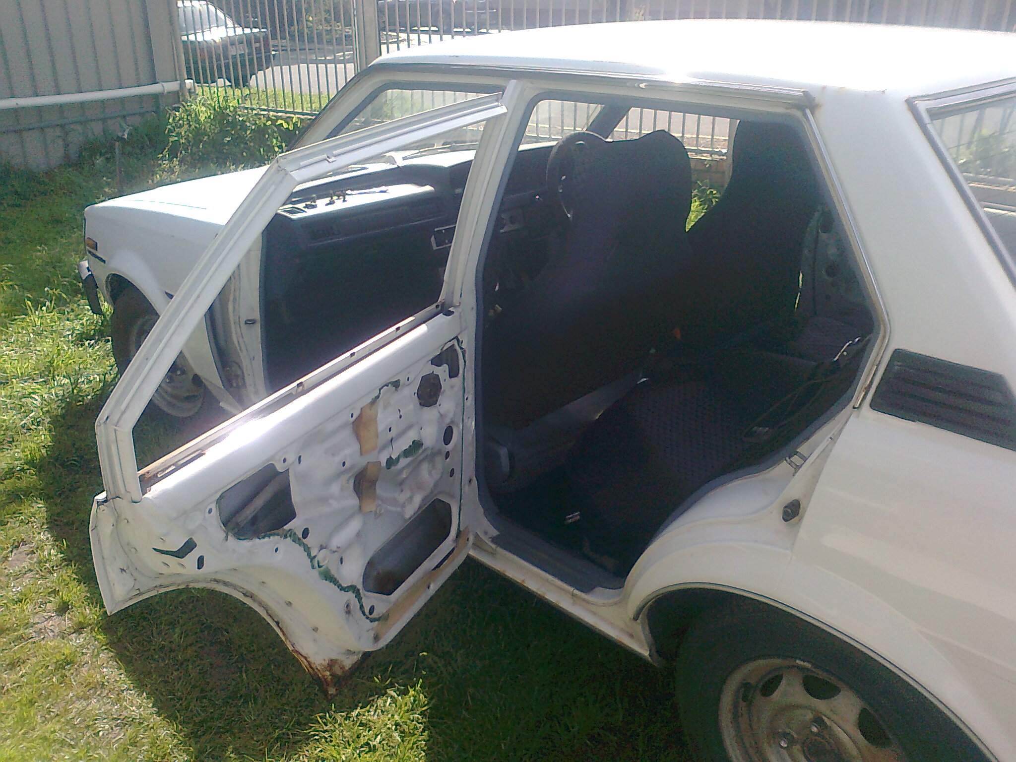

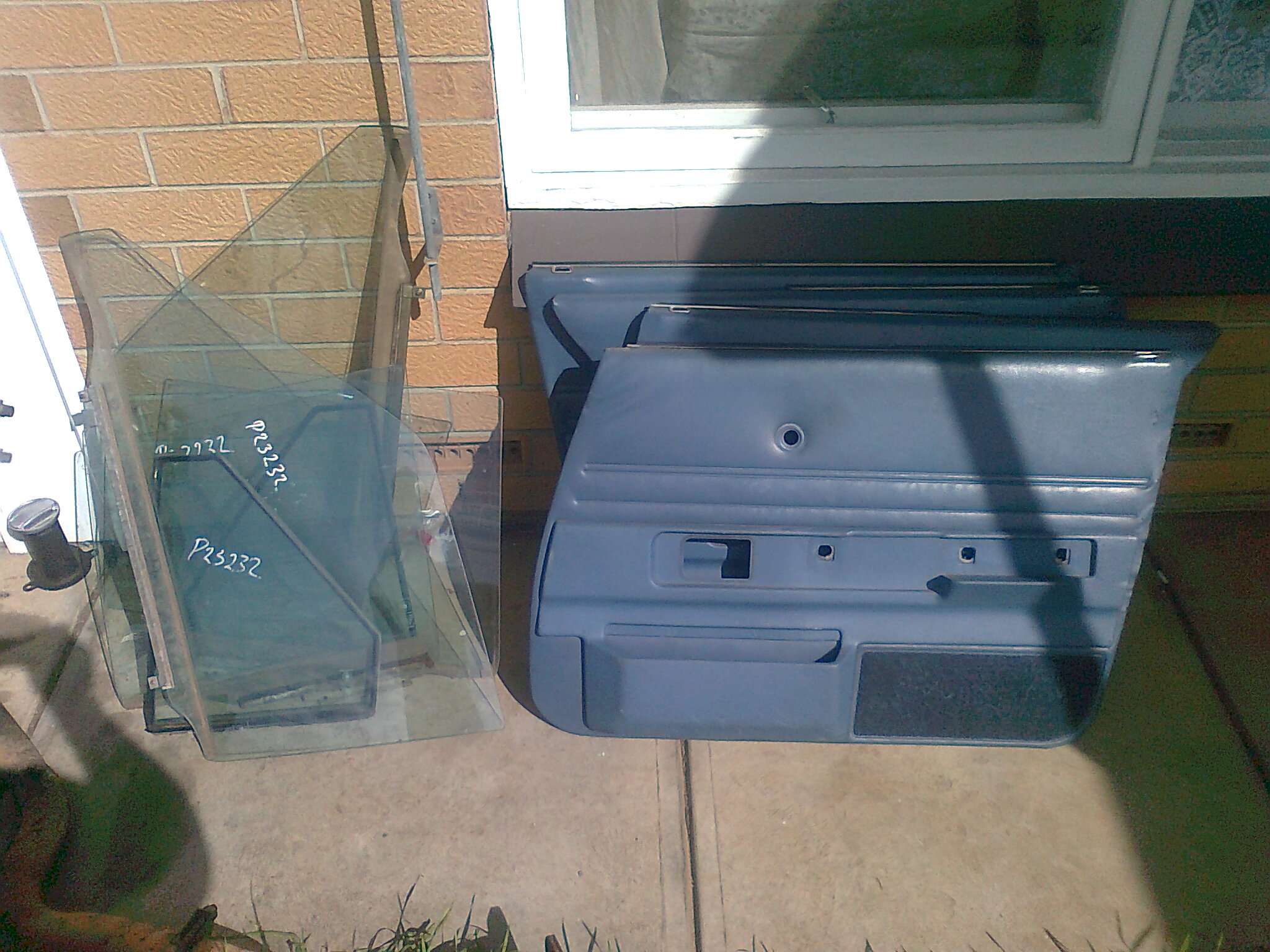

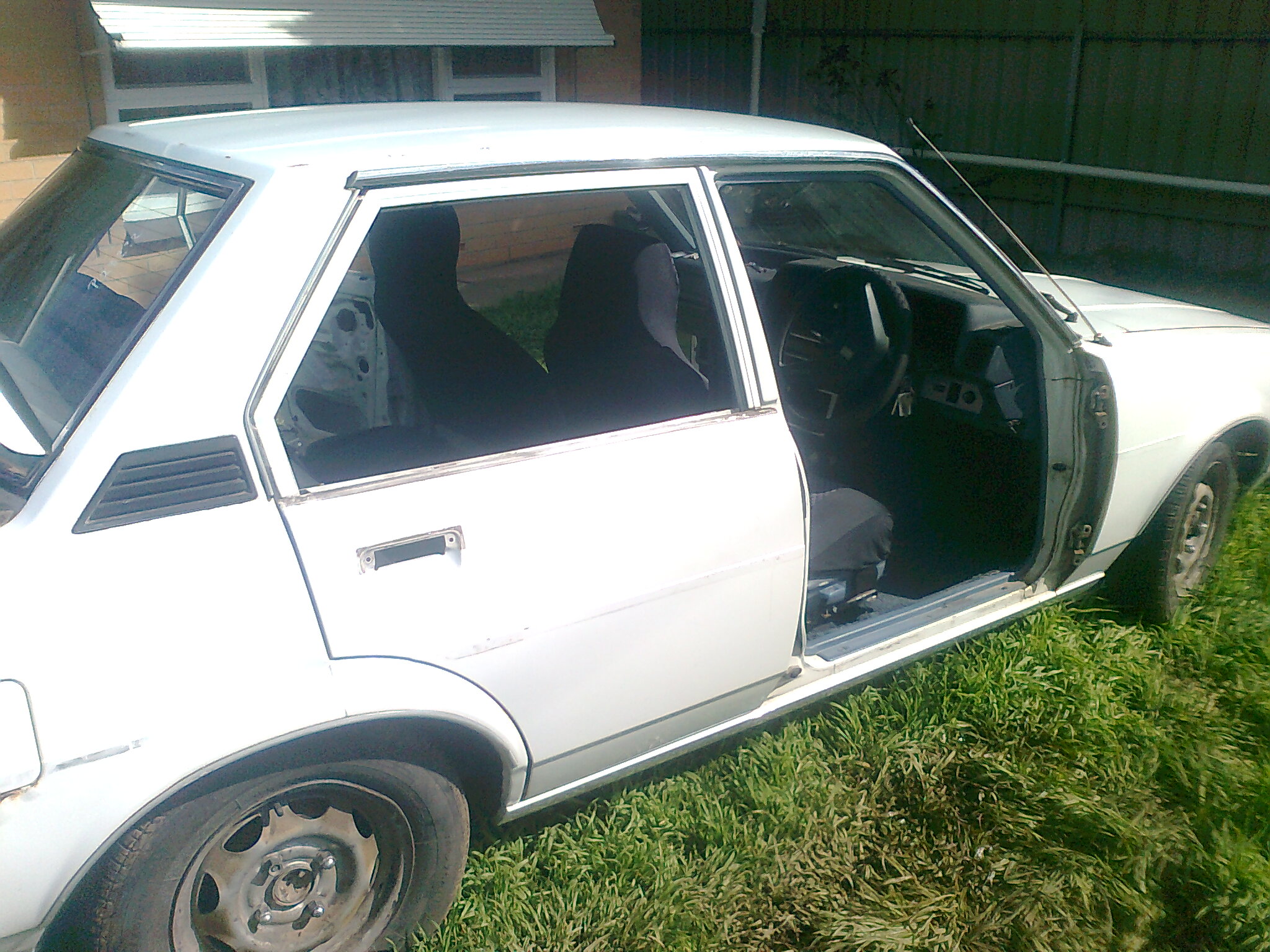

Fully striped the car of its doors today which was really easy but i decided
that rather then throw them out complete it was probably smarter to strip
them of all theyre goodies first. I took absolutly everything including the rubbers,
saves me having to buy more if i need them for the next doors i buy, plus if
a window breaks or a lock f@$ks up i wont have to mess about trying to get
it from a wrecker.

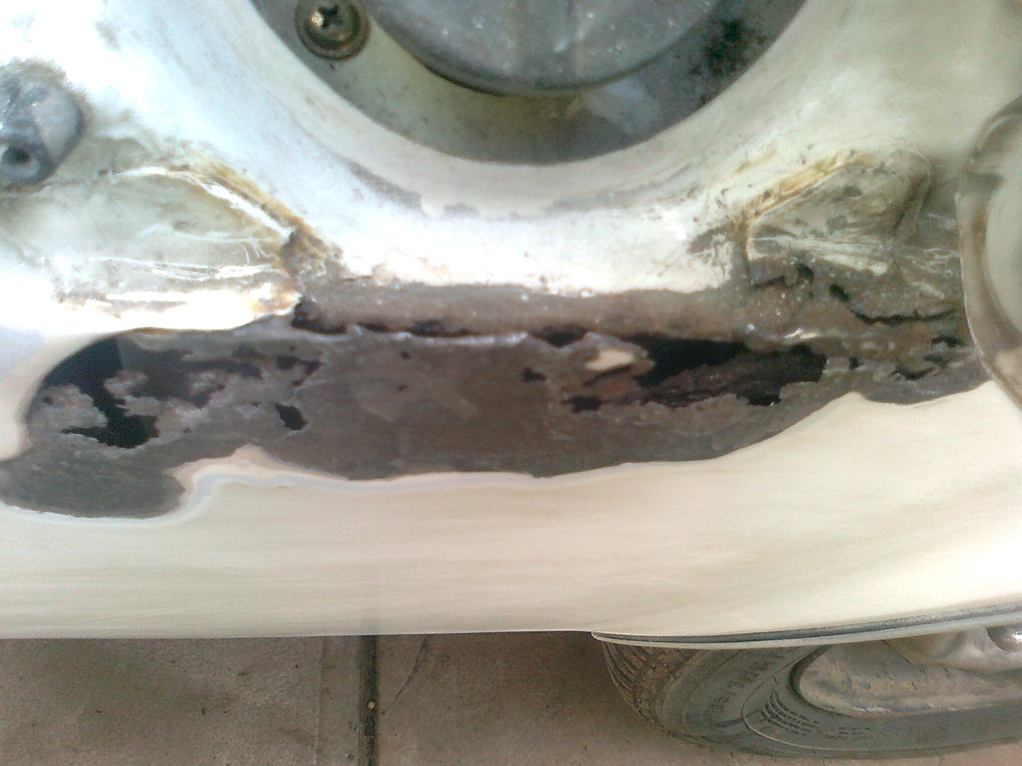

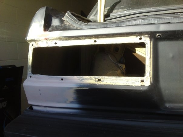

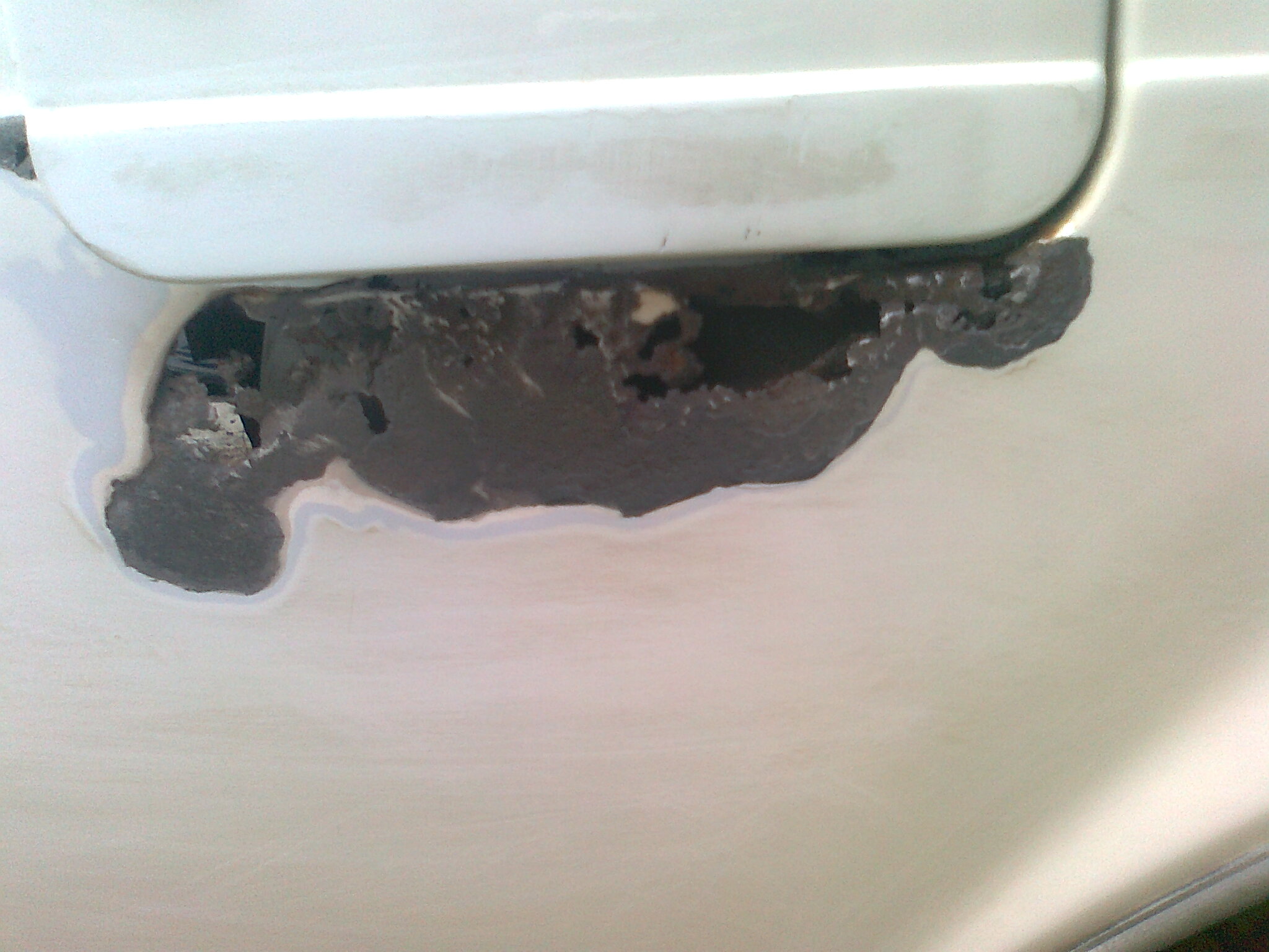

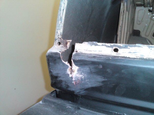

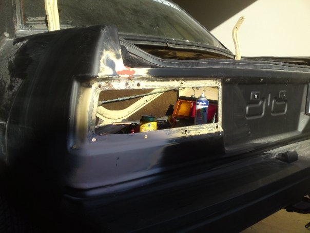

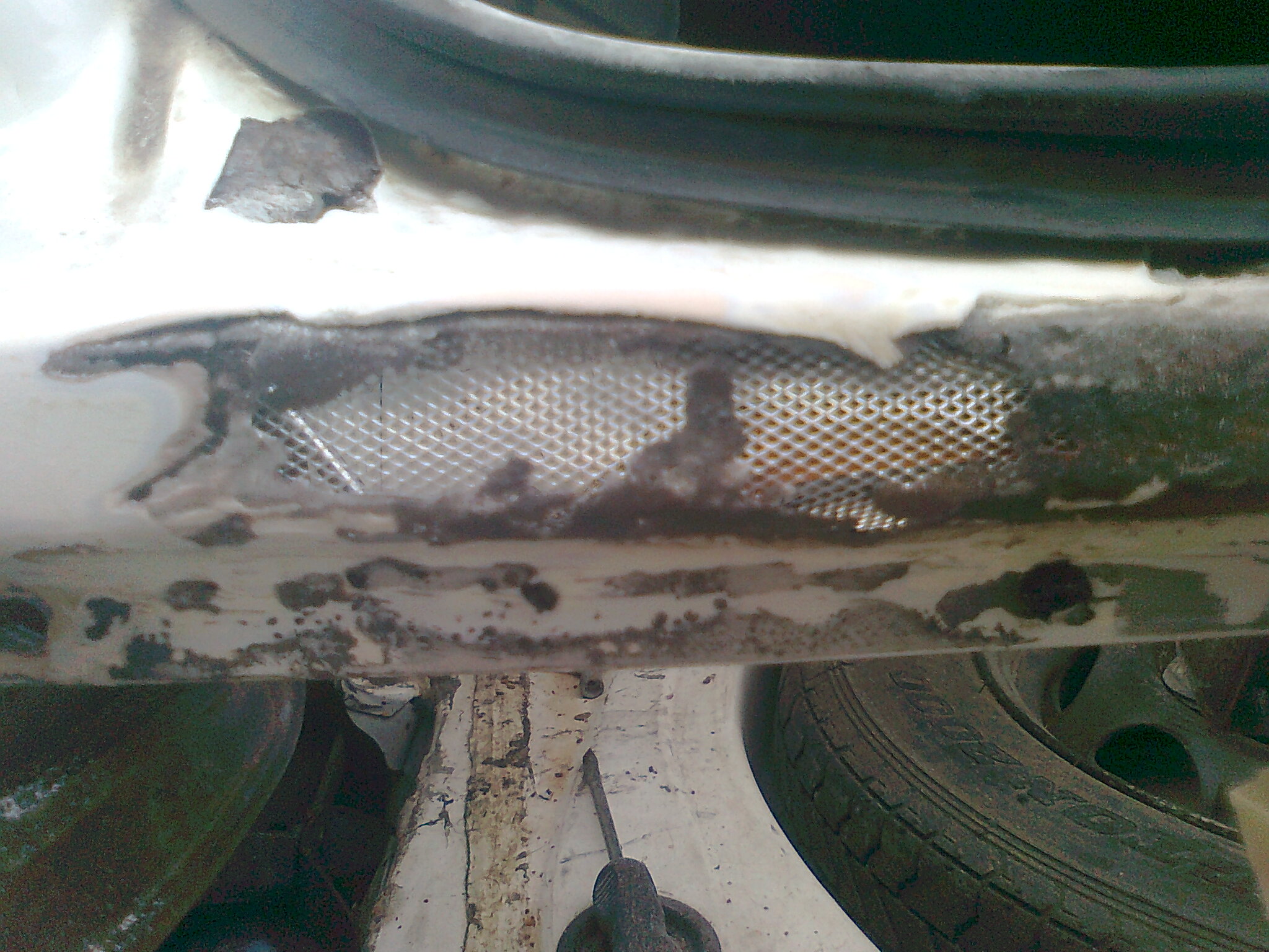

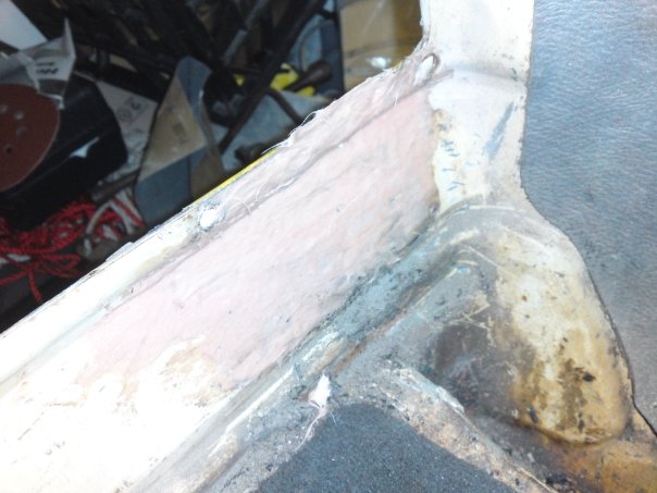

Ive sanded back the car now and have had a better look at the rust
between the boot and the left tail light and its pretty bad, i havnt
had much to do with body repairs at all and it looks like a pretty
awkward area to cut and weld a plate in, but then again mabye it isnt?
I just wanna cut as much as i can out and bog over it but what i wanna
know is how longs that gonna last before the rust comes back through?
If youve done this before od worse let me know how you did it,cheers :y:

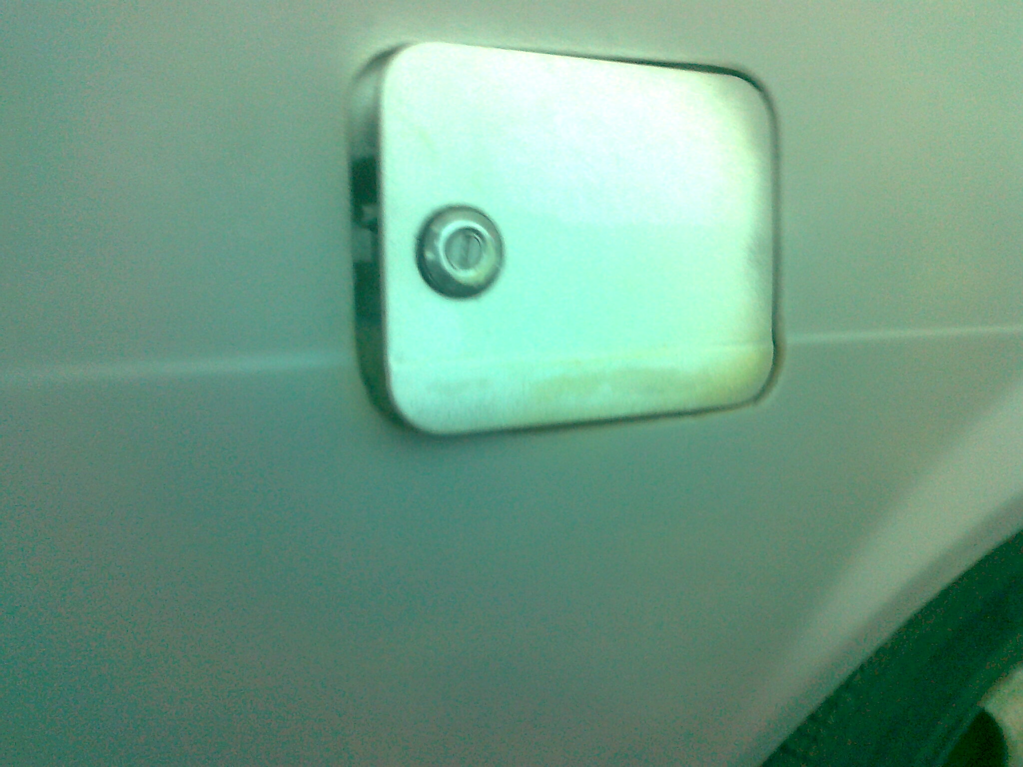

On the fuel filler part i've got rust in mine but all i did, was fill that shit up and sand it flat with the body again and then paint over it aye, but the other bit along the boot i can't help you my 70 doesn't have that much rust in it at all
I just bogged mine, its only meant to be temporary, but will probably be there for ever,
Just rust convert it get a good anti rust primer and use a fibreglass bog base.

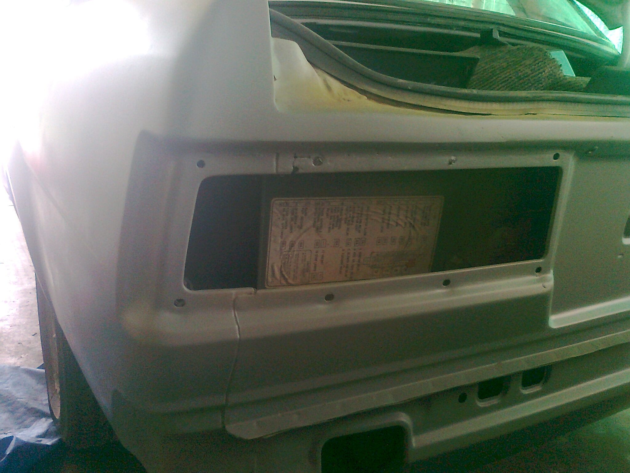

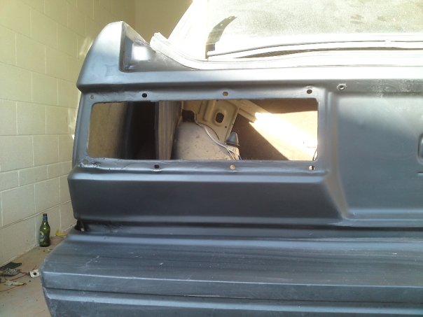

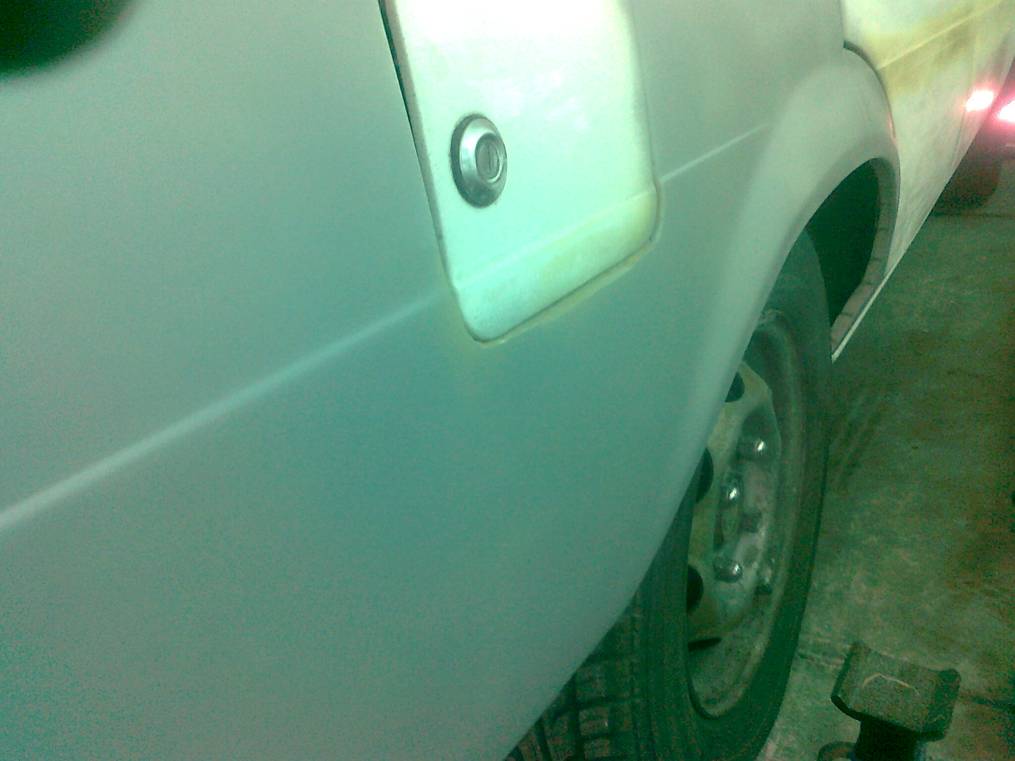

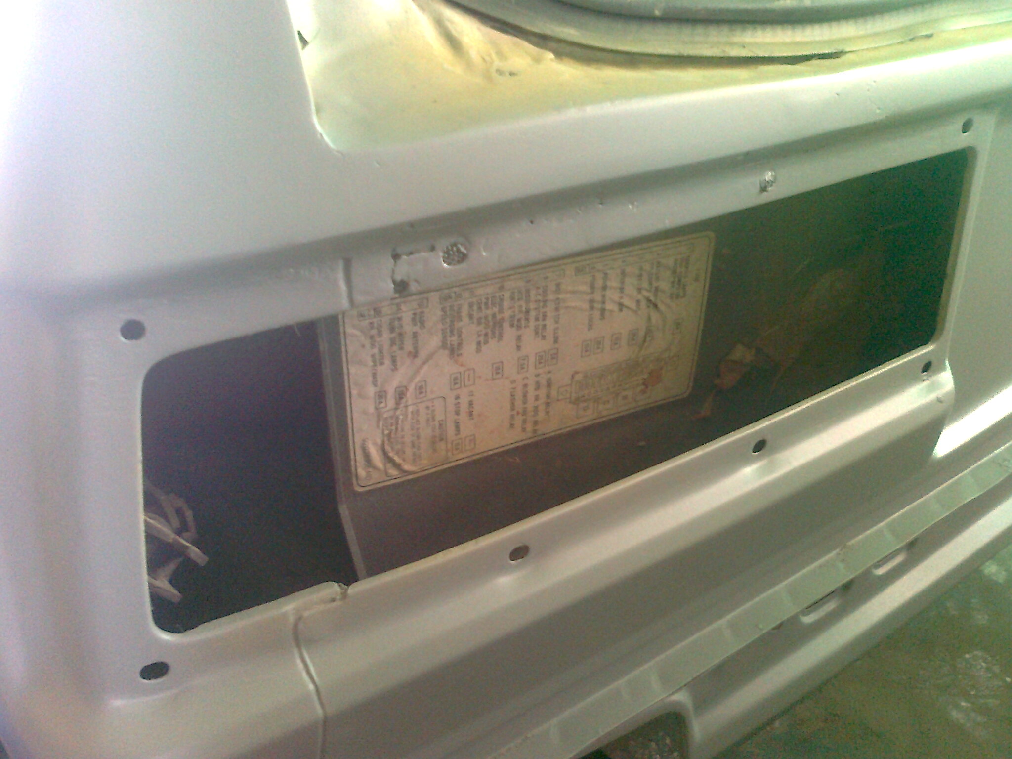

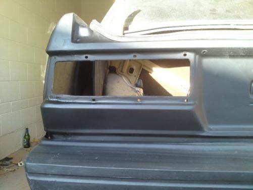

So today i finally got around to getting some primer and some
photos of the really bad rust spots which ive now fixed, its only ment
to be temporary, but I'm pretty happy with how it came out. Its my
first time trying to fix rust this bad, and too be honest repairing
it has been pretty f$#ked. Ive got a lot more respect for people
that have the skills and patience to restore cars properly now.

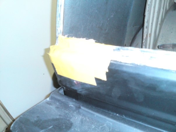

Agreed, the hardest part for me was getting some alloy
mesh to stick behind the holes, and both the fuel tank
and the boot seal were hard to get behind, The boot seal
was even harder cause there was pretty much nothing left
of the metal to stick to, oh well its done and its a temp
fix but at least its good enough to paint over now.

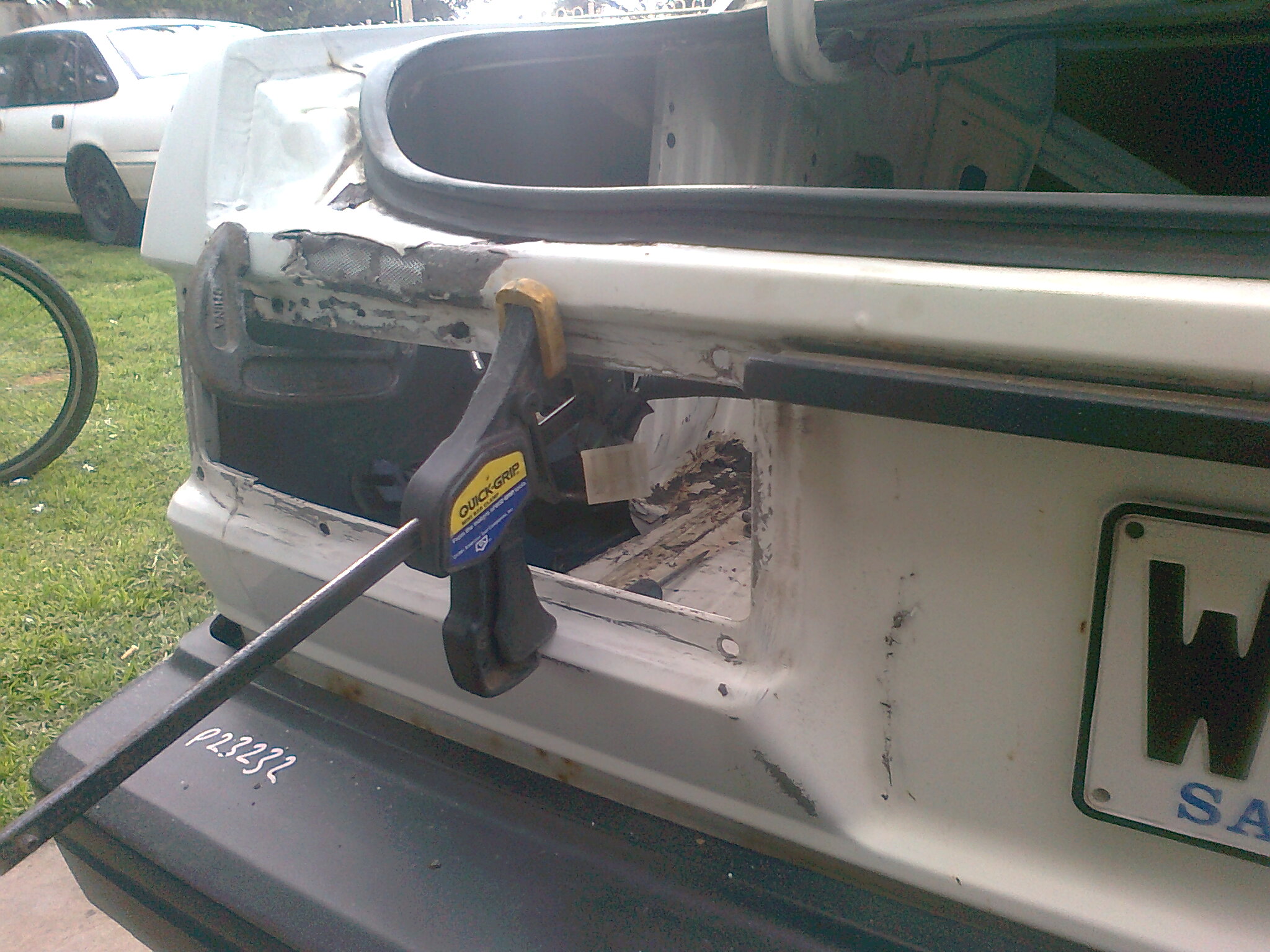

Hard as nails. Serious. Smear a little bit of that shit on and it isnt coming off in a hurry.:no2:
I used it to patch a hole once and needed to angle grind it out.
But like in my pics I just duct taped over the hole and ran fibre glass bog from behind then plastic putty on the outside.
lots of ways to do it. Just gotta be creative. :laff:

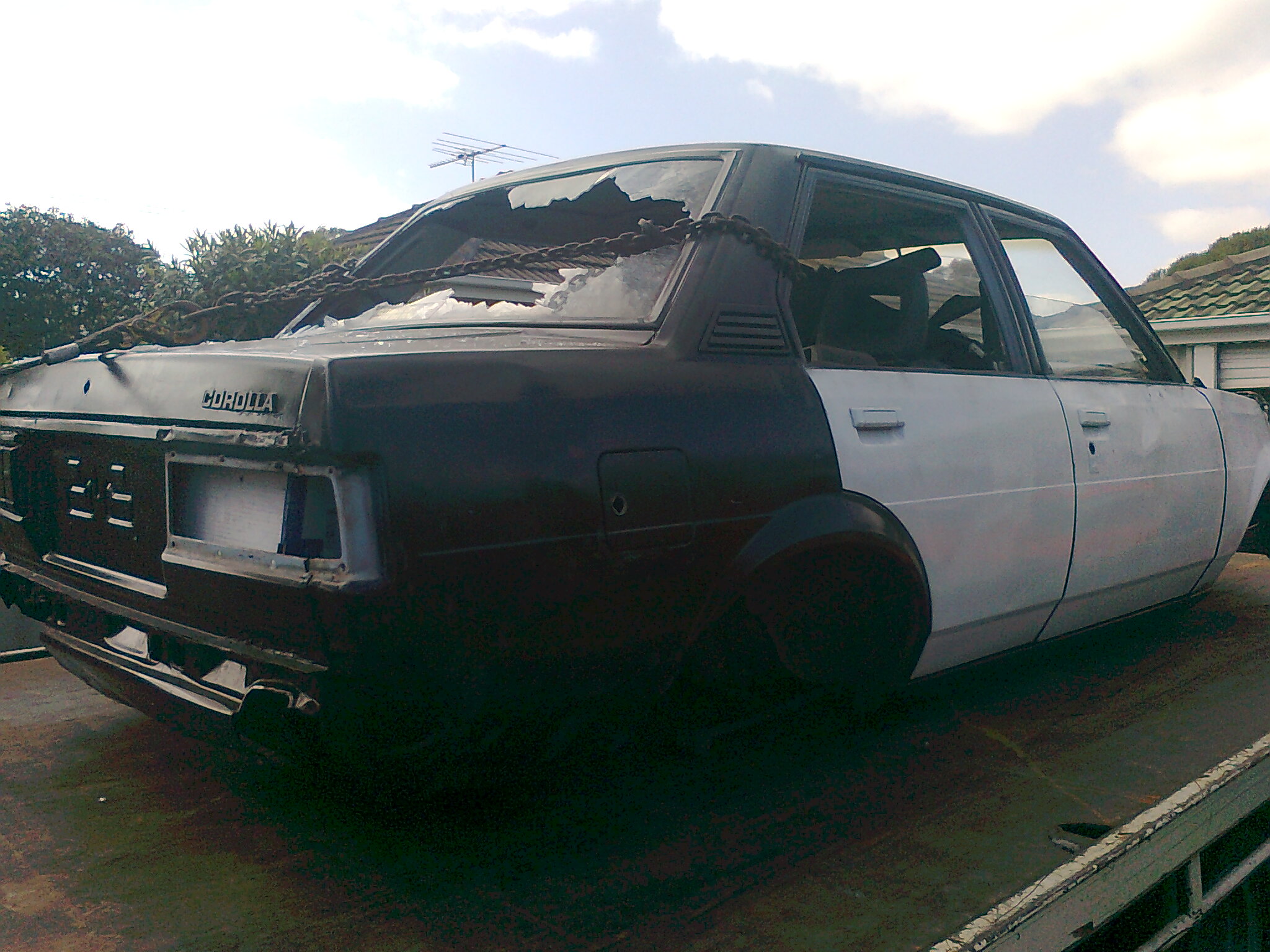

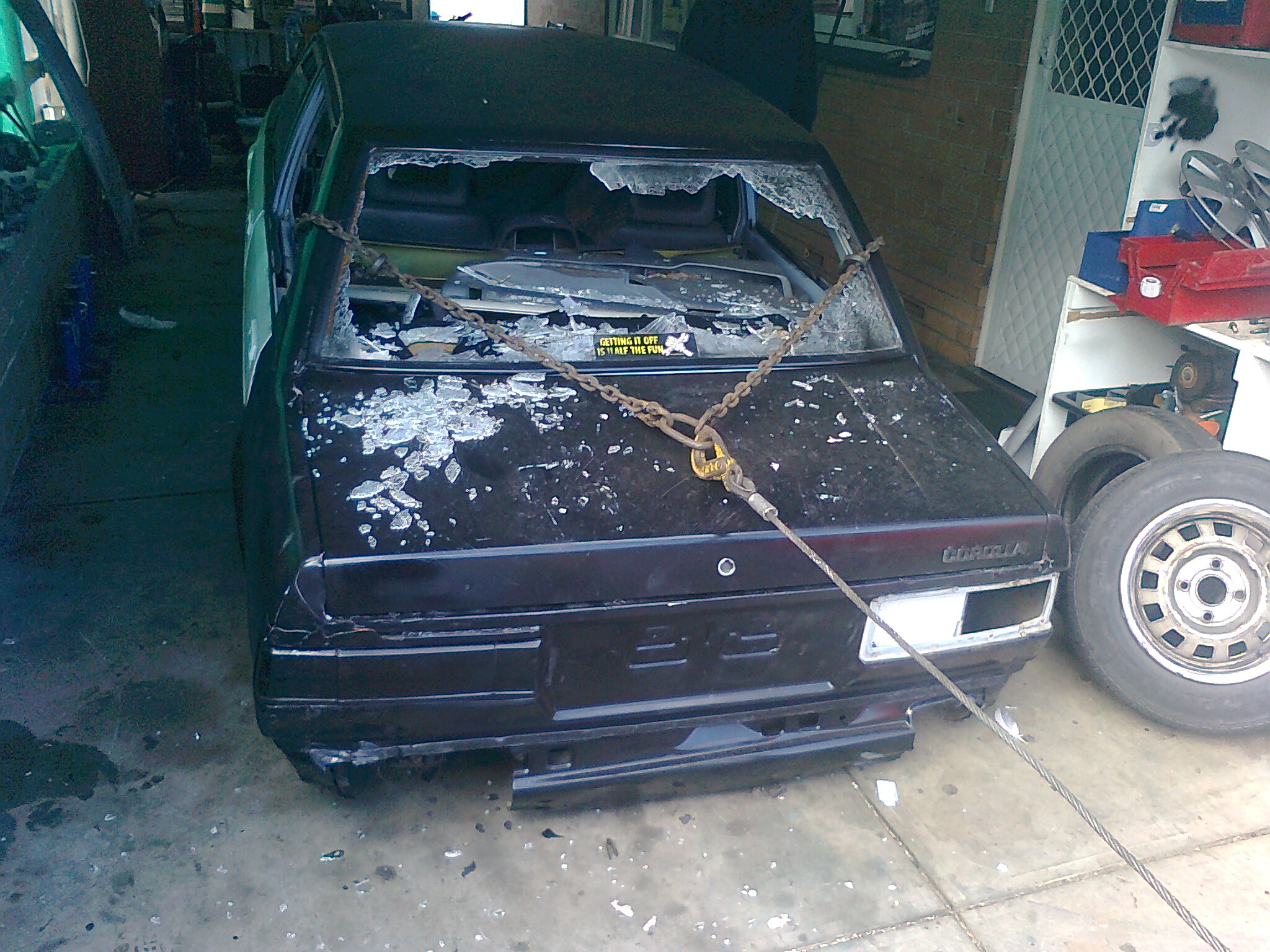

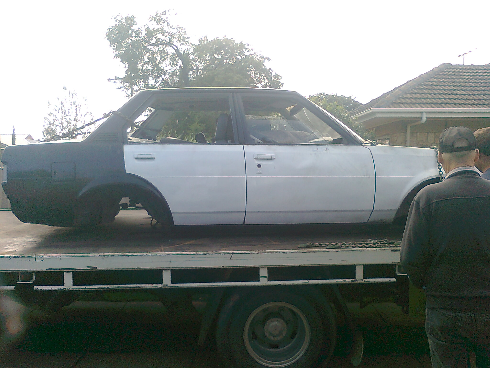

Plenty happenin atm, recently bought a donor car for my auto
to manual conversion, Totally stripped it of its drive line
and front end, there was no interior in the car as it was set
up as a burnout car. I'm planning to get this thing road ready
before the end of the year, seems like a long time but ive still
got a lot to do.

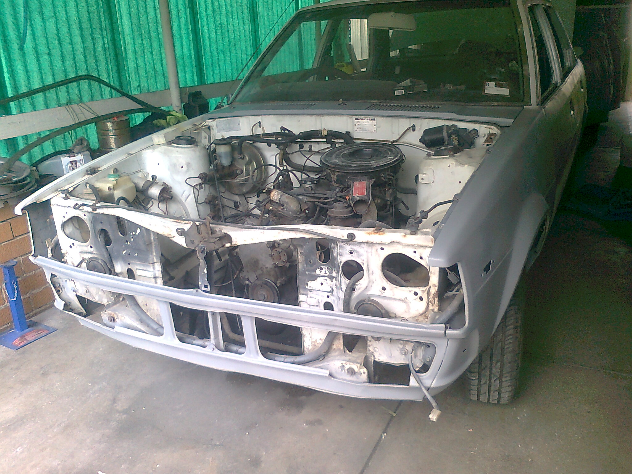

So far the car is in primer and all the rust has been repaired,
the next step will be to get some paint on it and get the manual
up and running, shouldnt be too hard, just a matter of time really...

I got the donor car last week on wednesday and pulled it all apart
then got rid of it this morning, bought it off Gumtree for a good
price-it was regency defected.
