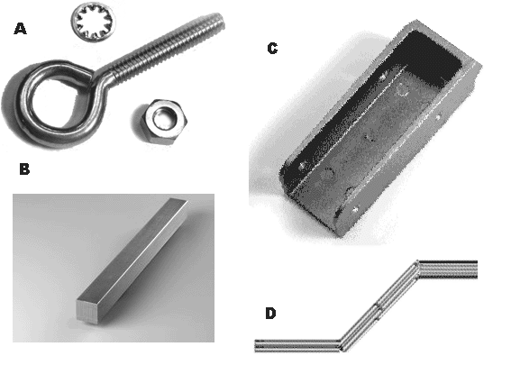

altezzaclub Posted August 31, 2010 Report Posted August 31, 2010 (edited) Ok, after the discussion about stopping a KE getting stolen here- http://www.rollaclub.com/board/index.php?showtopic=34210 I ended up thinking about this- You buy a ringbolt 'A' that will fit over the gearlever knob and wrap it with a bit of vinyl or foam to protect the gearlever boot. Then you weld it to a length of square bar like 'B'. ..or you make the ring out of the square bar, all one piece. Then you make a C-shaped section that fits over the square bar, "C", which is welded onto a lazy S piece of bar 'D' You bolt 'D' to the floor by the handbrake under the carpet. It stays there permanently with the C-section pointing to the gearlever. You put the car in reverse, drop the ring over the gearlever, slip the bar into the "C" section & drill through the C-section and the ring's square bar, and put a padlock through the hole. When you want to go somewhere you take off the padlock and toss the ring under the seat. To steal the car you either hacksaw through something or unbolt part 'D' from the floor. So you make it out of high-tensile steel and weld the "S" base to the floor... Will it work?? Can someone make them? Edited August 31, 2010 by altezzaclub Quote
KENut Posted August 31, 2010 Report Posted August 31, 2010 I have something similar to what you're thinking. D tab welded on gear lever, hi tensile chain bolted through floor beside seat/tunnel Lock in 4th or reverse, presto! No I did not make this. Looks hilarious, but chain hides away under the seat when not in use. It Definately works Quote

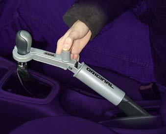

Evan G Posted August 31, 2010 Report Posted August 31, 2010 http://utvweekly.com/index.php/2010/05/rzr...eft-shift-lock/ more info Quote
altezzaclub Posted August 31, 2010 Author Report Posted August 31, 2010 Where's that from Evan, or what brand is it? That's the sort of thing my father-in-law modified, and I thought about it but reckoned the handbrake would eventually get hammered. Still, might be better than making one- Quote
Evan G Posted August 31, 2010 Report Posted August 31, 2010 Where's that from Evan, or what brand is it? That's the sort of thing my father-in-law modified, and I thought about it but reckoned the handbrake would eventually get hammered. Still, might be better than making one- i just googled "gear lock anti theft" and look in the pics. good idea but all i need is a hacksaw to get it off Quote

altezzaclub Posted August 31, 2010 Author Report Posted August 31, 2010 The problem with the steering wheel ones are that its easy to cut a steering wheel. That handbrake one looks a bit lightweight in the hinge area Evan, but I suppose it makes the car next door easier to steal. Its still the best of the three I think. The Bullock is too model dependent with different pedals, and the red one is just for autos as it holds the stick forward. Quote

altezzaclub Posted September 1, 2010 Author Report Posted September 1, 2010 couldnt you just unscrew the noob and pull it off??? possibly... I can remember a young lady in my youth I swear could do that.... :hmm: I do prefer my design, but that one does look a lot better! Quote
SLO-030 Posted September 1, 2010 Report Posted September 1, 2010 Chain link welded/attached to the shifter, locked to a chain attached to the hand brake. would work for both auto and manual. Car wouldnt be able to get into or out of gear unless the hanbrake is removed. Quote
