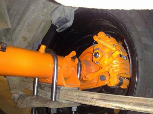

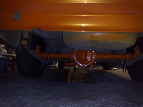

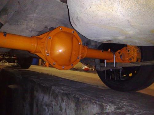

Davros El Davros Posted September 7, 2010 Report Posted September 7, 2010 I am not getting into the power/psi debate, cause that's not really my area of expertise, but I will offer my thoughts on the brakes. I would absolutely recommend a front brake kit from Hoppers Stoppers. I have the kit installed on my 4AGE KE10. The Hoppers kit was specifically designed for a KE20 (one of the guys who works at hoppers used his KE20 as the test car when they developed the corolla kit) and are really well engineered. I went through a few different variations of brakes before I decided to stop wasting my time and buy the Hoppers kit. You need to make sure you have the right master cylinder bore size to push enough fluid to the calipers and you have to run 15s to clear. Diff wise, I have a shortened R31 skyline diff in mine, currently with a standard centre. As RadRollaz said, the borgy diff suits the shape of the corolla body quite well. Plus the disc brakes are standard on these diffs, p[arts are cheap and a good range of LSD centres are available (although they are rather expensive..). I don't have a big power engine, and the car isn't running as yet but everything fits well. Sure it adds a bit of weight to the back end, but I think with a 710kg car I can get away with it.
