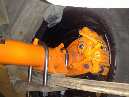

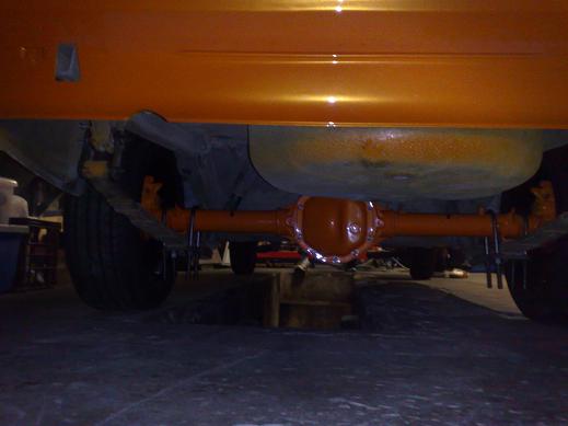

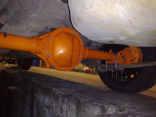

radrollaz Posted September 1, 2010 Report Posted September 1, 2010 I reckon go a hopper stoppers Commodore twin piston caliper conversion with 300mm rotors on the front and r31 skyline borg warner with factory LSD and disk brakes. Get the diff cut down and rebuilt which will be tuff enough for any 4agte and they suit the shape of the undercarrige in corollas better. The hilux diff while tuffer is heavier and will hit the floor if you lower the car as the housing is a totally different shape to the borg warner, ive seen a few tuff corollas making big power running borg warners without an issue. Diff will cost around $2500 and front brake conversion $1500 or there abouts. Good luck BTW i run a hilux diff in my Ke30 and even though it is strong, i had to fit disk brakes as they have drums from factory aswell as an LSD as they are rare with factory LSD, if i hadnt bought it already cut down to suit my car to begin with i would have gone Borgwarner and every time the diff hits the floor on a hard launch i remember that. Here are a few pics of Marty K's Ke30 with R31 skyline Borgwarner diff.
