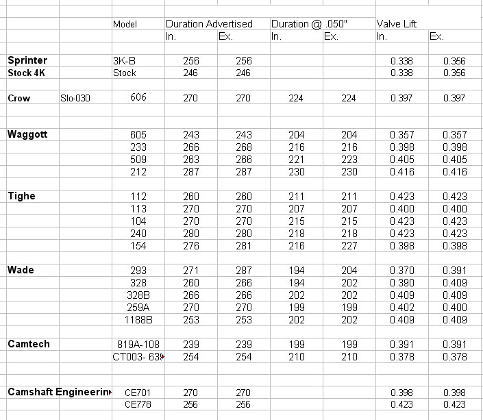

78corolla Posted August 23, 2010 Author Report Posted August 23, 2010 i don't mind having to run bp ultimate as i do anyway. its not my daily driver but i still want it to run decent. heres the mods i wanting to do -lighten flywheel (don't know how much i can do this) -skim head,port/polish, new valves (is their a size best used) -stronger head gasket (don't know which one is best) -cam upgrade -carby upgrade (was thinking weber) -extractors -2" exhaust with one muffler -thermo fan (remove clutch fan) is there anything else thats simple to do or is any of this not recommended... Quote

altezzaclub Posted August 23, 2010 Report Posted August 23, 2010 :jamie:.. Destroyer is right, unless you have a brilliant set of rings and bearings in the 4k, you might as well do up an average 5K and get a better motor. A couple of Kg comes off the flywheel, the 4K only weighs 8kg I think and mine is 6kg now. Changing valves is probably quite expensive, but a cleanup and a skim always works. I opened the ports up to match the Lynx manifold for the SUs, but the Webers work on the stock manifold so its no good getting too carried away. Head gasket- I'd use Toyota. Buy an aftermarket gasket set if they're cheaper (I'm sure they are!) but buy a factory head gasket. Same with oil filters. Cam- if its not a daily go for a mid-range to top end. Get some fun out of it if you don't need to crawl through traffic. Other guys on here will know some good cams, but here is the table I looked at. I picked a lift of 0.4" so I didn't have to chase new valve springs, but Holden 202 springs allow more lift. Look up the manufacturers as these are only the mild-mid range cams. Weber is the cheap option. It will be jetted to suit the chokes in it, but those chokes might not be ideal for your motor. Extractors are still being made, so you can get them new. ...and put a 2" resonator in it! You will be fedup with the noise and drumming after 6months and hating it if you don't. Thermo fan is a nice idea, on my list for 'one day...' Quote
