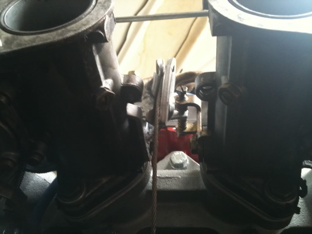

bAKER Posted January 8, 2011 Author Report Posted January 8, 2011 (edited) Update: Linkages made! Much easier than I had expected, Used the arm from the 4k carby. New week the clutch and Radiator go in, and hopefully a start up. :dance: Edited January 12, 2011 by bAKER Quote
