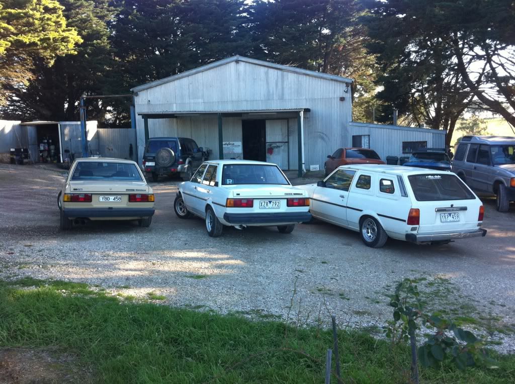

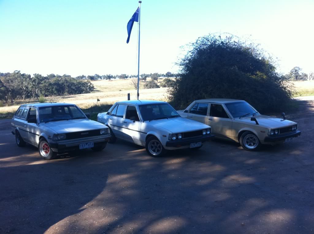

Ben-89 Posted June 13, 2011 Report Posted June 13, 2011 Nice one guys, hope to see all three at cars, coffee and donuts this sunday! Venetian looks tops :wink: Quote
bAKER Posted June 15, 2011 Author Report Posted June 15, 2011 Thanks mate, hopefully she'll be ready Quote
ke70project Posted June 28, 2011 Report Posted June 28, 2011 haha my old beige rolla, all the stickers and the mad house lip are gone. its so loud with the silencers out aye? Quote
BReNt Posted June 28, 2011 Report Posted June 28, 2011 On 6/28/2011 at 9:15 AM, ke70project said: haha my old beige rolla, all the stickers and the mad house lip are gone. its so loud with the silencers out aye? Very loud!! I love it though haha. Thought it looked better without the front lip cos you can now see the nice shiny white caster brace peeking out from under the front. :D Quote
bAKER Posted June 29, 2011 Author Report Posted June 29, 2011 On 6/28/2011 at 10:57 AM, BReNt said: Very loud!! I love it though haha. Thought it looked better without the front lip cos you can now see the nice shiny white caster brace peeking out from under the front. :D agreed :y: Quote
