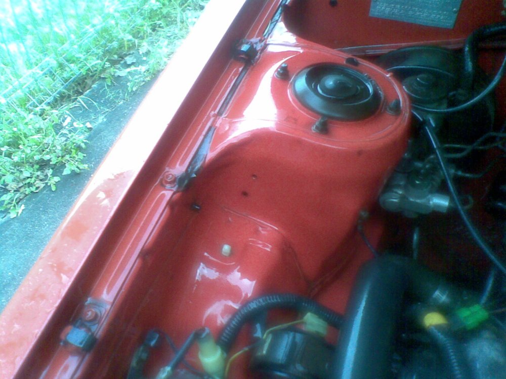

Trev Posted January 3, 2011 Author Report Posted January 3, 2011 (edited) On 11/23/2010 at 12:07 PM, Trev said: Went up and did a few things to it today like flush the radiator and check engine earths as once it is running for a few mins the temp gauge goes to hot and the fuel needle goes way past the full mark, the car does not seem to be getting hot so I will look over the dash earths. Now that it is at home I had a decent look over it and found a faulty thermostat that only opened slightly when hot, kinda weird as the radiator never felt overly hot but probably because there wasn't enough flow to push the hot water out and into the rad so I gutted the one that is in there until I buy a new one, also think that the fuel sender is just faulty from sitting around so I will take it out and see what I can do. Since I am registering as a SOHC I decided I should clean the engine bay up, I do not know what is over it but it is like soot so I got a sponge and started wiping but I am going to leave the rest for the degreaser and gernie. Cleaning comparison: Closer look: Closer look of the still dirty side: I am hoping that the engine bay isn't stained like most of them are. Edited January 3, 2011 by Trev Quote
