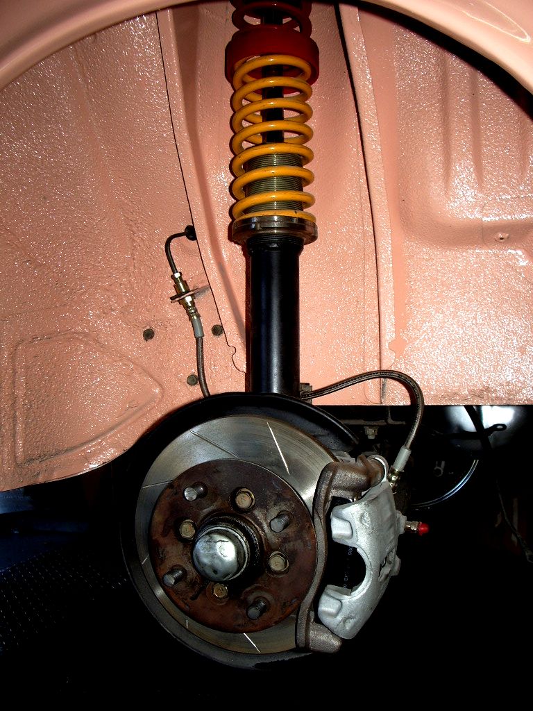

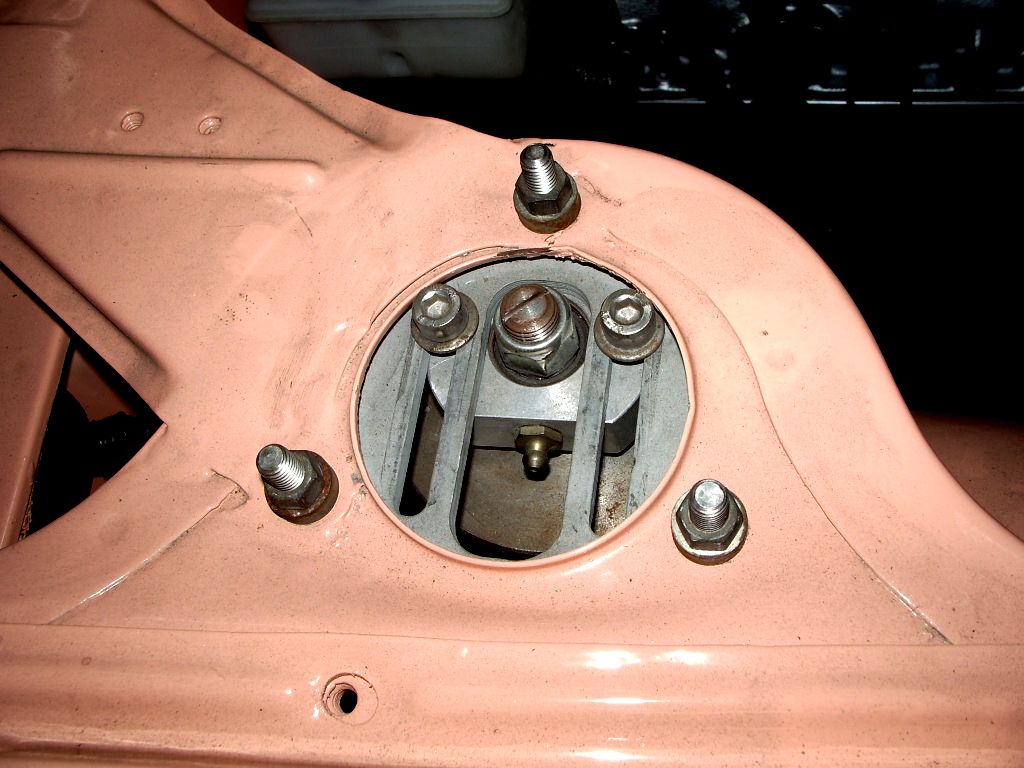

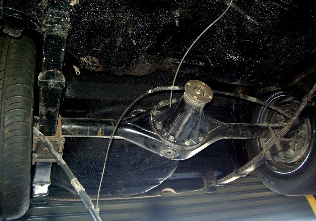

KEI069 Posted August 12, 2010 Author Report Posted August 12, 2010 thanks for all the kind words guys. yeah the supercharger is an sc14, it looks massive next to a k engine and with the extended snout. the torana in the background is a mates car, has an injected 5 litre, turbo 350 and 9" combo. its absolutely overrated and apparently was a top 60 car at summernats in 2004 or 05. anyway heres a couple more pics of peaches. a ta22 limited slip diff narrowed coil overs for the front with ae86 inserts. front brakes are ke70 slotted rotors and calipers on ke20 front hubs with nice braided brake lines. and adjustable top camber plates to suit. Quote

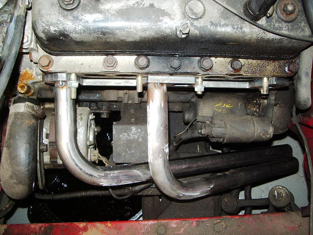

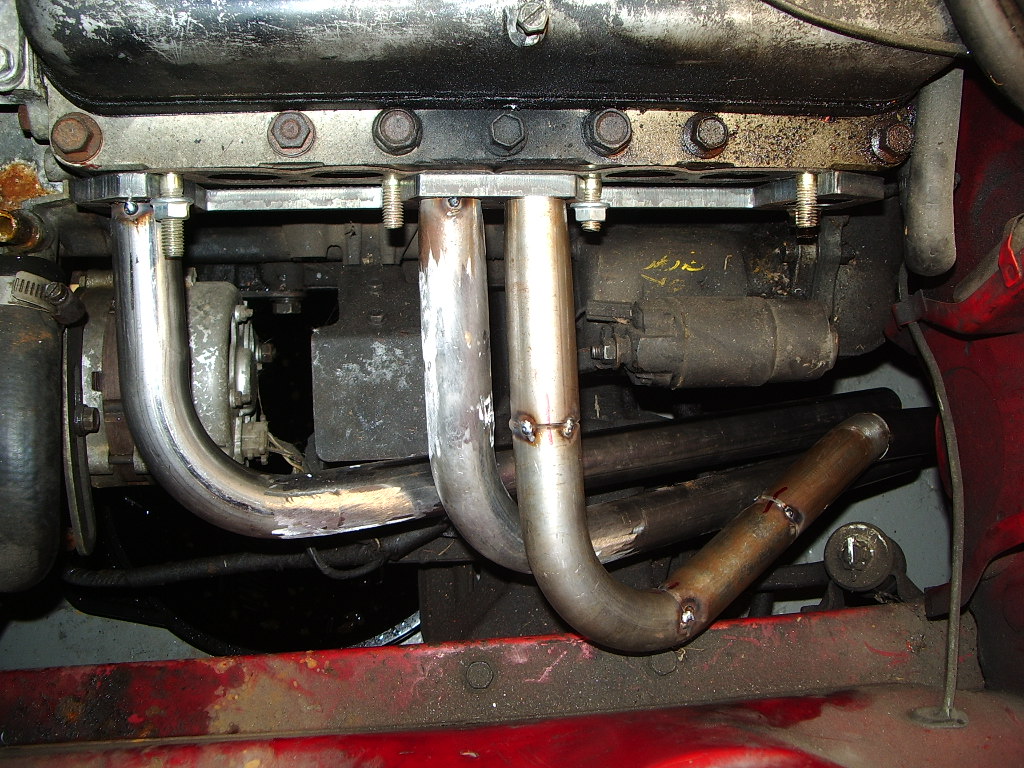

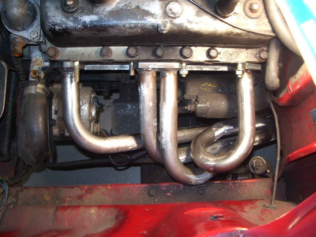

KEI069 Posted August 22, 2010 Author Report Posted August 22, 2010 ok so i have spent the last couple of days making some new extractors 4-1 1.25" pipes a bit different than the normal off the shelf items now just got to get them coated. another step closer to starting Quote
philbey Posted August 23, 2010 Report Posted August 23, 2010 this thing is sick. Really good job on the manifold. Just my two cents but how well have you braced it? with the belt tension as well as the extra weight of the blower on that manifold a simple brace down would be worthwhile! Quote

7FOUR7 Posted November 29, 2010 Report Posted November 29, 2010 what did you have to do to get the ke70 rotors and calipers onto the ke20 struts? Quote
TheNOBBLER[RL] Posted December 2, 2010 Report Posted December 2, 2010 The 70 upgrade is quite easy actually. Find yourself some ke3x - 55 backing plates and use them with the 70 calipers. If you already have disks you then use the existing hub setup on the 20 struts and bolt the disk on in place of your 20 disks. Brake lines should be sweet as well. Pretty simple stuff and it's the biggest cheap bolt on upgrade you can get for the earlies. JP Quote
