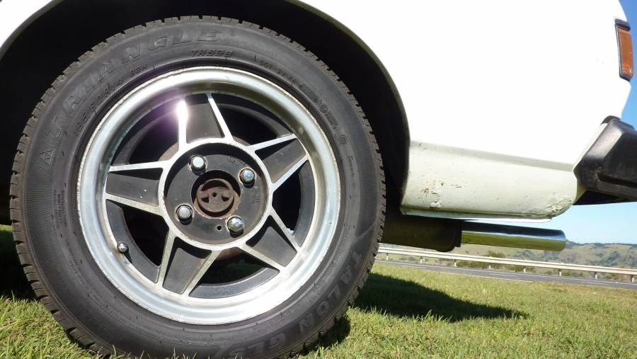

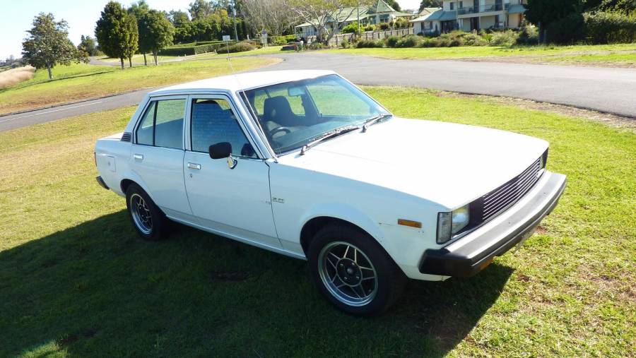

flamingheads Posted August 3, 2010 Report Posted August 3, 2010 I've had this KE70 for about 2 months and so far and I've only done a few minor cosmetic mods. De-stickered, old steering wheel I had, pool ball shift knob, monster tacho mounted dodgily in dash, seat covers & aluminum exhaust tip. The original tip was about 3" long after the muffler and the new one is about 7". It's just siliconed on for a bit of bling bling but it it actually made the exhaust a lot quieter. Current specs are: 4K engine with a cam of unknown specs. It gets power at 3000rpm Extractors 2" Exhaust 1.5" cut springs 14"x 6 Globe Rims E-gay bucket seat Here are some pics from when I picked it up. I picked up a 5K with a weber today that I'll be putting in in the next week or two. I don't have any real plans but dreams are opening up the 5K and getting everything balanced. Getting a front lip, having the small amounts of rust cut out and a cheap white spray job and getting some good suspension when I feel like what I've got is holding me back. More pics up tomorrow. Quote
doots Posted August 3, 2010 Report Posted August 3, 2010 cleeeeeeeeeean as. i think a lowering is in order. Quote
ke70dave Posted August 3, 2010 Report Posted August 3, 2010 thats a neat looking ke70. 5k should go well in it! i thought you said you de-stickered it...whats that UNIT sticker doing there!!haha Quote

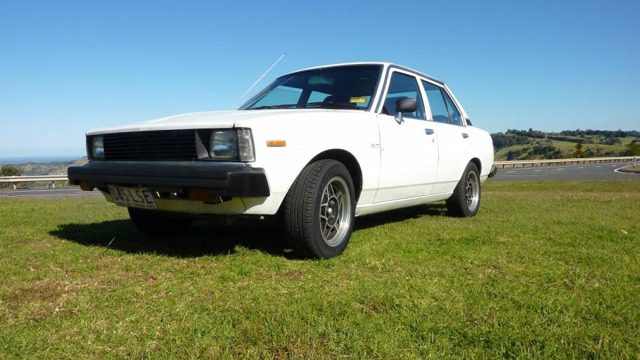

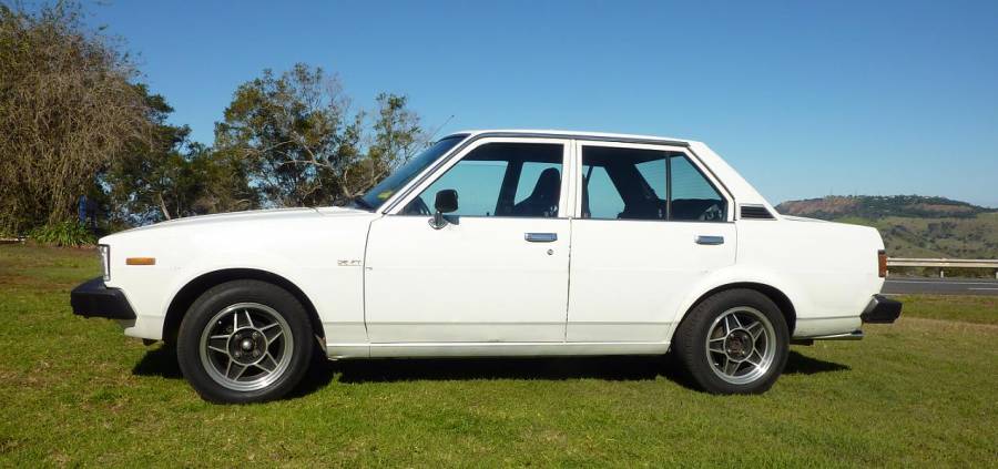

flamingheads Posted August 4, 2010 Author Report Posted August 4, 2010 This is how it looked when I picked it up. I was going to take some pics today but found the camera isn't here. Up close it's not too clean but there are no major rust or dents. Current pics up tomorrow hopefully. Quote

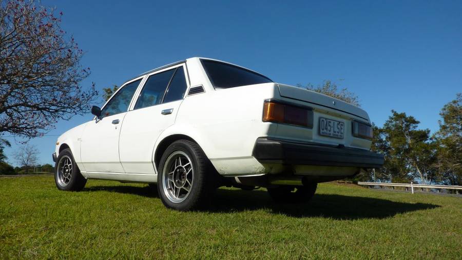

flamingheads Posted August 18, 2010 Author Report Posted August 18, 2010 (edited) Slightly later than promised: Next thing to go will be the drift stickers. They're a mission and a half to get off. Edited August 18, 2010 by flamingheads Quote

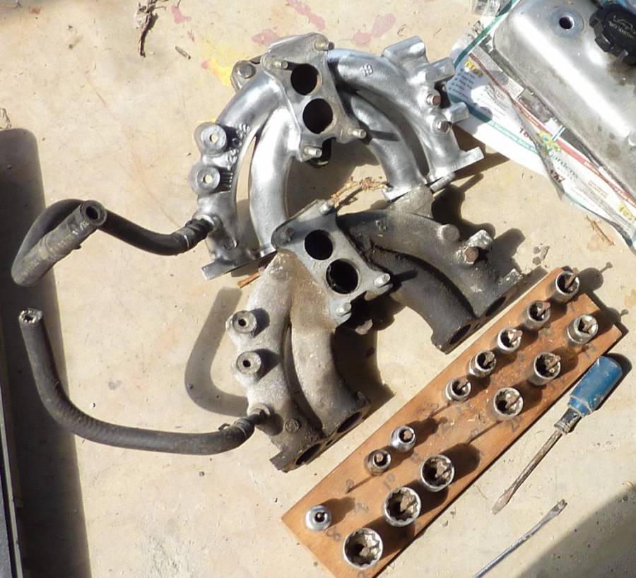

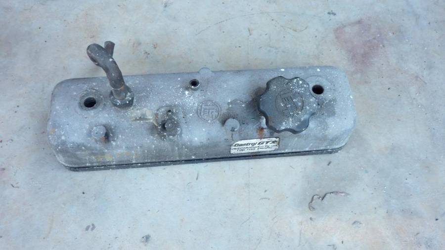

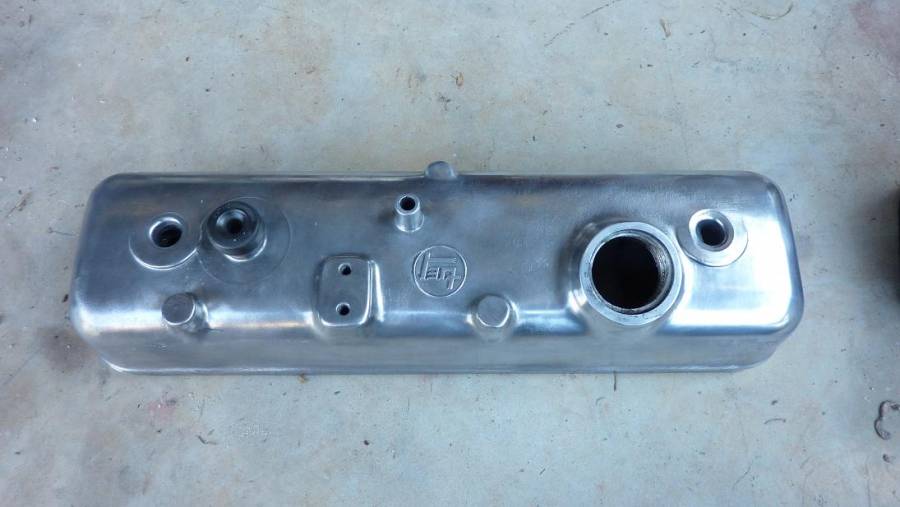

flamingheads Posted September 2, 2010 Author Report Posted September 2, 2010 (edited) Things have gotten in the way of good old fashioned mechanics lately so here are some shiny bits. I used a wire brush on drill to do the hard bit of the polishing then finished up with cut and polish then some mag cleaner. And a shinyd and unshinyd inlet manifold -> I've got the 5k together and hopefully it'll be going in tomorrow. See how things go. Edited September 2, 2010 by flamingheads Quote
Taz_Rx Posted September 3, 2010 Report Posted September 3, 2010 Wire brush wheels are good for cleaning stuff up, but I wouldn't use them again for polishing, you just create yourself more work as you need to sand out any scratches the wire put in the alloy. As an alternative, get yourself a sanding flapper wheel in about 80 grit to put in the drill (around $5 each for a toll supplier) and use that as the first clean up. You can then get some finer grit flappers to carry on. When I did my 7ke manifold I used 80, 120 and 240 grit wheels, then went to wet sanding. BTW - you can near double the grit of the flapper to know what sort of finish you'll get because they're in the drill. The 240 flapper gives you more of 400-500 wet/dry finsih if you used normal paper. :hmm: Quote
flamingheads Posted September 3, 2010 Author Report Posted September 3, 2010 I had some of that but it couldn't do around the raised bits and I was feeling lazy. I guess I could've used wet and dry paper for the fiddly bits but I was feeling lazy. The cut and polish did a pretty good job of taking the worst of the scratches out though. Quote
