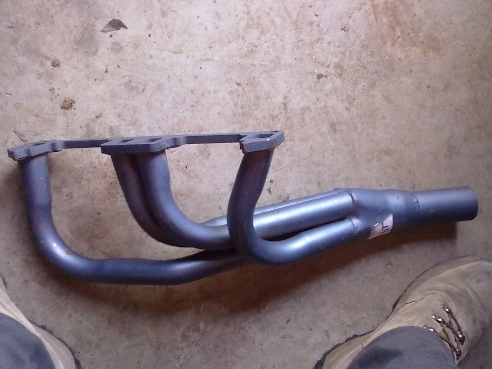

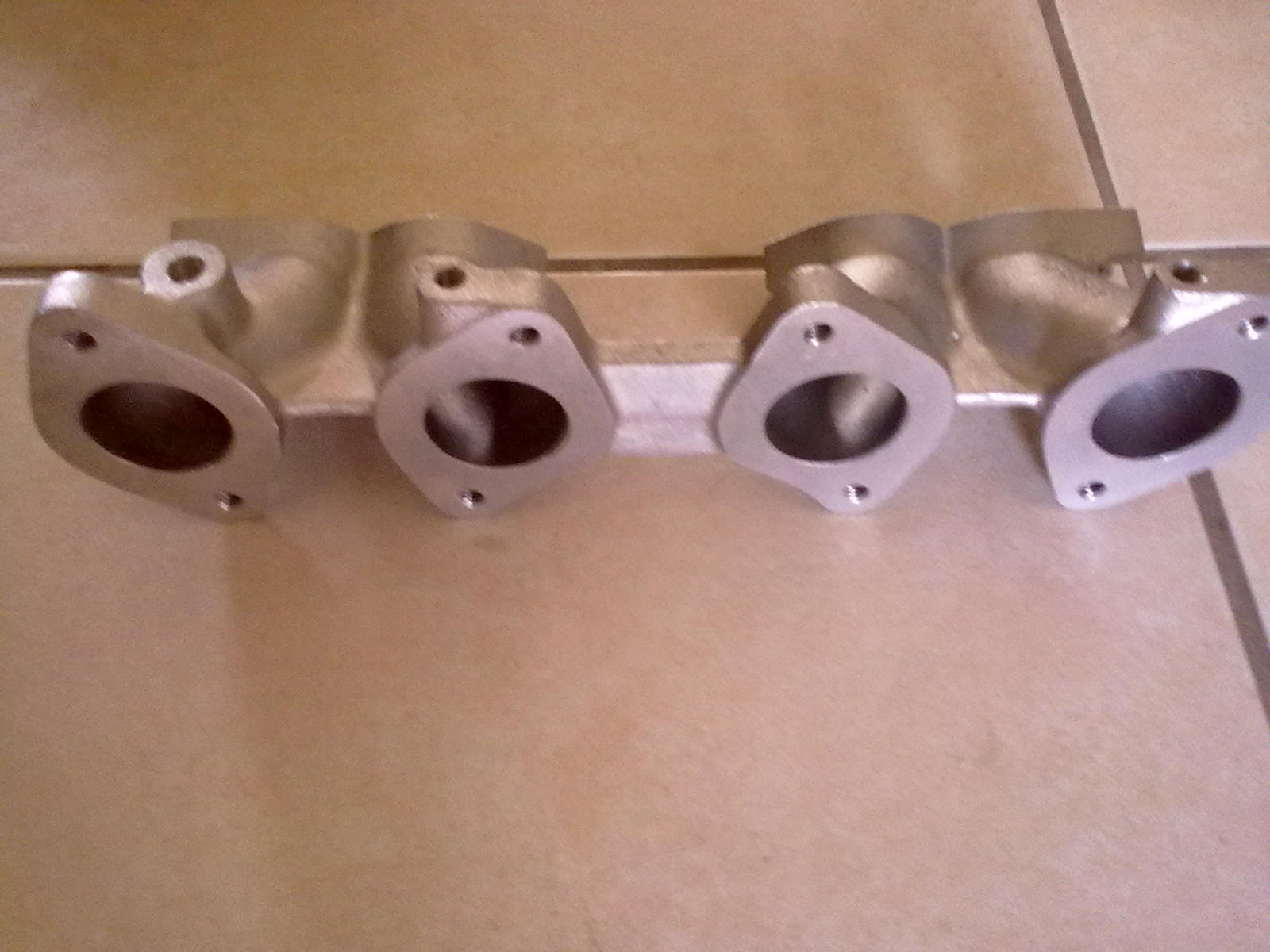

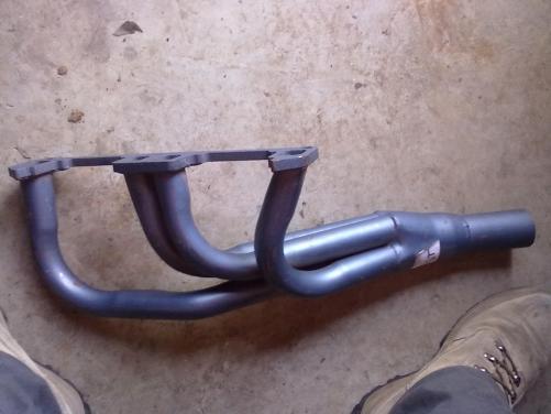

GJM85 Posted September 7, 2010 Author Report Posted September 7, 2010 (edited) Got the holden lifter in yesterday. We worked out the pushrod length with the venier caliper. Not sure on the overall length of a 4k pushrod they need to be cut down 31mm. We tried on one rod by hacksawing it down then milling the pushrod ball out of the off-cut. They appear to be spot welded in..... They will all be cut down, oxy heated, ends pressed in and then silver solded. Sweet as. Today, I went past Moss Street so I stopped in to Autobarn and I ordered a redline twin dcoe manifold and a BBR clutch. Sweet. Then I dash directly over the road to Right Price Exausts and enquired about some extractors. They just so happened to have a set of Hurricane short 4-1 extractors on shelf. New old stock, so they are a little scratched up, but that means 25% off!!! Perfecty Sweet! Edited September 7, 2010 by GJM85 Quote

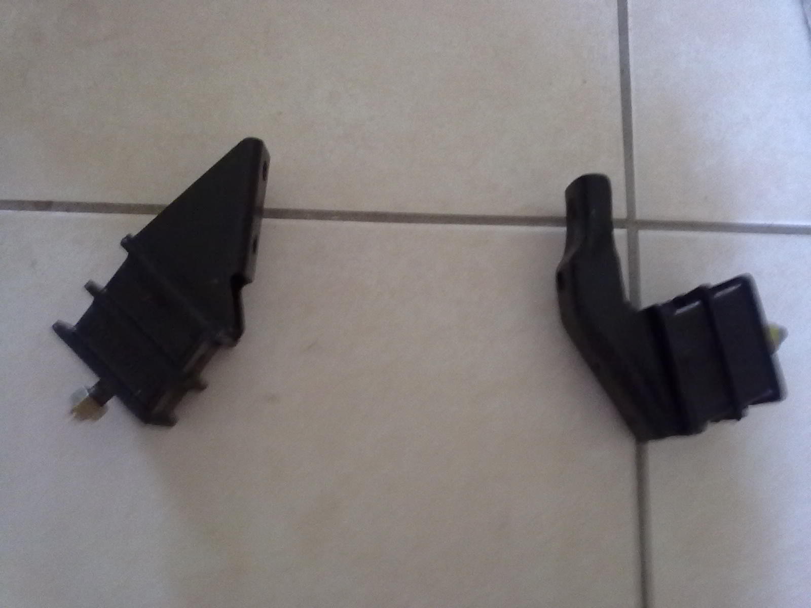

GJM85 Posted September 9, 2010 Author Report Posted September 9, 2010 Picked up some more stuff today. One step closer. Quote
