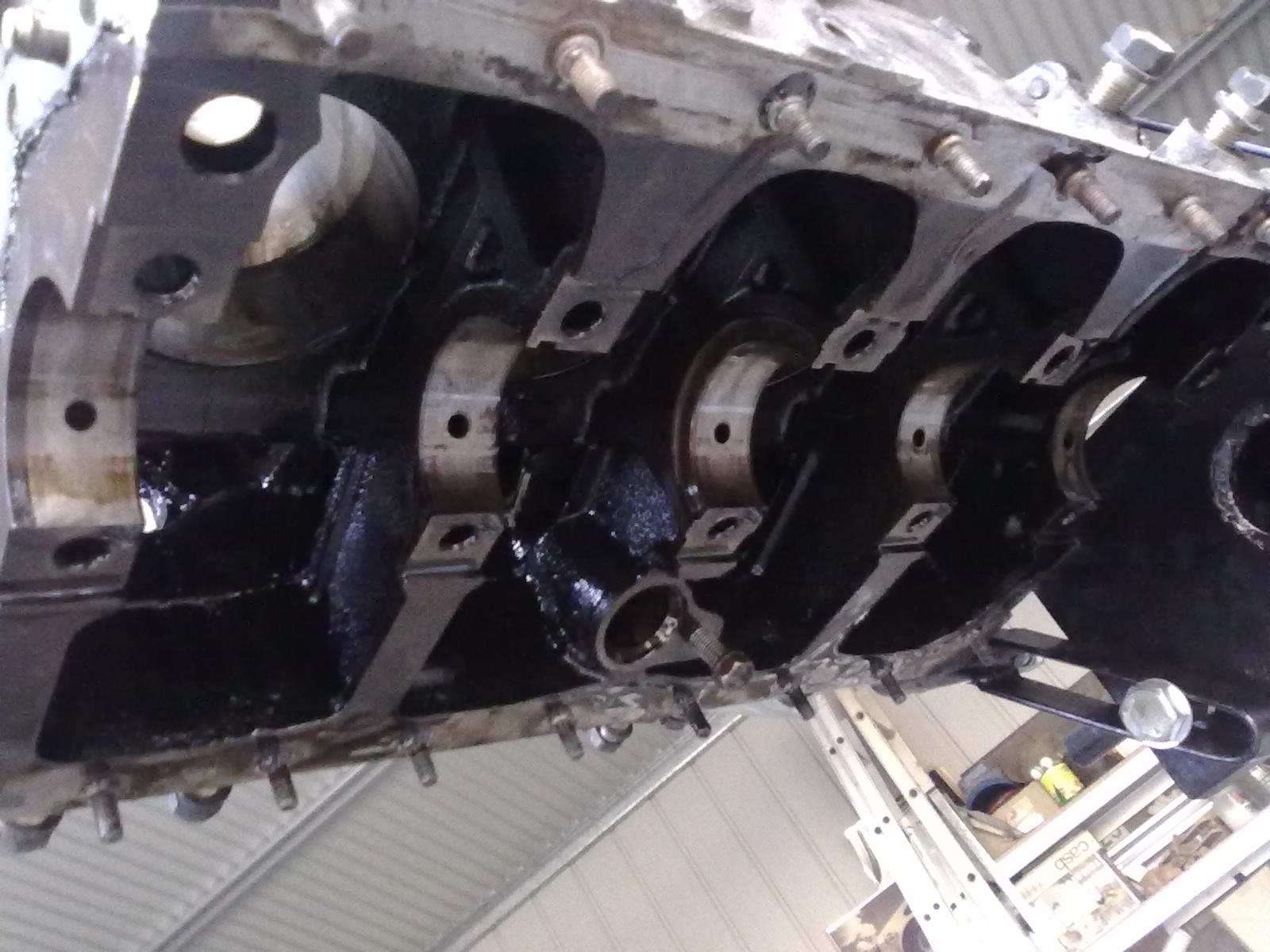

GJM85 Posted August 17, 2010 Author Report Posted August 17, 2010 (edited) Another productive day. I ran the front quarters down to MSR Kustoms. They haven't started the 20 yet.... :D Then when I got home I called the tow guy and organised to get the 55 donor down from Caboolture. Low & behold he was flat today, so he headed up to get it. In the mean time, brother Keiron, who might I add is not a toyota fan hepled me with the 5k. We pulled it down to a block in 2&1/2 hrs. So a few discoveries toay, the '3k' I pulled out of the 20 originally is actually a 4k with all the 3k gear on it & the 5k does not have solid lifters. So from the information I gathered, correct me if i'm wrong but, if I use 202 red motor lifters and datsun 1200 pushrods with the 4k adjustable rocker gear I should get away with it. I'm not entirely sure if a cam and machined head will upset that mix???? Finally as we were packing up the donor arrived and we had a few minutes to give it a quick look over before the missus called stamping her feet. It's obiously been used in a homegrown motorkhana but it's still pretty good. Not running due to a missing negative terminal. It's going to be difficult to take it to pieces. It'll be like a heart donation out of a live patient.... Here's some progress pics. Cheers. PS. It gets hard to keep track of mulitple photo uploads.... the rocker gear photo with the red ignition leads is actually of brother JP's 4k when I was comparing rocker assembly. Edited August 17, 2010 by GJM85 Quote

GJM85 Posted August 18, 2010 Author Report Posted August 18, 2010 SLW42 said: Is your 5k getting fully built? Or are you just doing the solid lifter conversion and porting the head? well I did an assessment today on the block and lower end gear. The pistons are good, i'd estimate they have done no more than 20,000km and they are ACL's. So as it stands the bottom end will go back together with a full bearing kit and a set of quality rings. From ou measurements the bore stands at 80.55mm and the pistons are clean other than the carbon build up on top, so no it won't be a full rebuild. I priced thhe rebuild kit today and it's around 570$. To get the head reconned with a port and polish i'm looking at $200-$500 for recon and $106/hr for the port job, so I'm probably just going to get it milled 10thou", buy some di-grinder bits, port it myself and put and VRS kit through it. I picked the 5k up from Southport Autorecyclers and it's come with new leads, oil filter, plugs and plug sleeves. THe dizzy looks clean and the cam and lifters have no wear. The waterpump and all bearings look clean as, so I'd say it's been rebuilt recently. There isn't even any corrosion in the water jackets. The ke55, I bought as a doner has made me all confused and discruntled. So far, everyone who has seen it has told me i'ts too good to part. I have too admit. It's totally grannyspec and orginal. It just needs some panel work but other than that she's sweet. It even kicks over first turn. Runs smoothly, quiet and with no smoke until it starts valve bouncing.... oh sweet JESUS!!!!! I feel like a murderer. I'm gonna need a couple of days think this over.... Did the block today, so here's some picks.... Quote

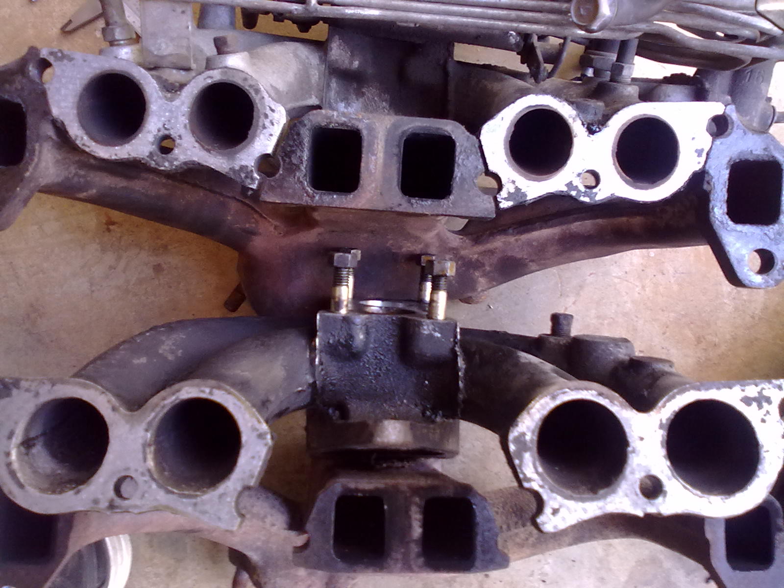

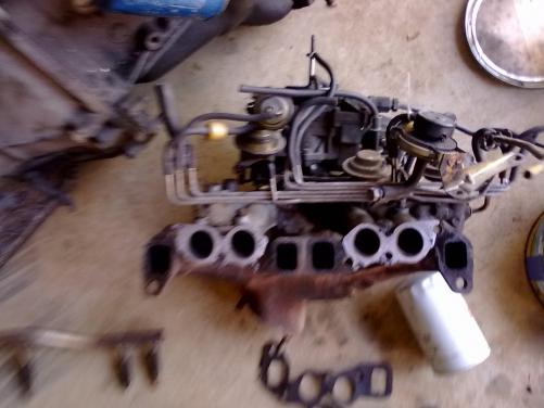

GJM85 Posted August 19, 2010 Author Report Posted August 19, 2010 (edited) Too start off this post i'd like to give a big thanks to Rockinrolla..... Good advice = Money saved. Running with a 4k head and rocker assembly now using the 5k valve springs. Lower compression for an engine that would of ended up with a 20,000,000:1 compression ratio.... Again, another disorientating day. The intake manifold I pulled off the 4k from the 20 is a 3kb manifold. Which got me all tingly inside. I pulled the 5k head down and found the #4 intake valve is bent and all the exaust valves are in pretty bad shape... I had the head and manifold in the car ready too go to the shop tomorrow. Now i'm goin with the 4k head so tomorrow i'll pull one down.... I got a call from MSR Kustoms about the ke20. They've done the arse end neat and straight with a new valence panel and started on the sides. They blew back around the weather channels and they just.... fell off.... :D They've asked me too come in tomorrow and assess the situation. I'm upset now because it's becoming easier and easier too ditch the ke20 and run with the ke55 I got for donor parts..... :D ;) ;) I have reached a critical and pivotal point in the build process.... the 20 has already touched my soul. Here the pix.... Edited August 19, 2010 by GJM85 Quote
