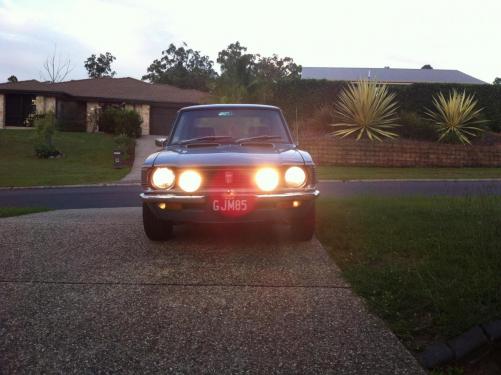

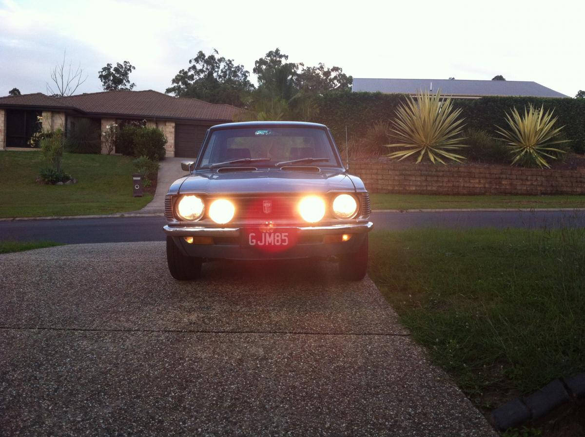

GJM85 Posted April 6, 2015 Author Report Posted April 6, 2015 (edited) New tune. No vac advance at all. Just 10 degrees base timing. Carb is tuned with 55/55 idle, 165/160 air & 150/145 mains. Idle mixture is turns out and idle speed is 1&1/2 turns in. Idle is lumpy but relatively even with moderate manifold vacuum at 1000rpm. I think the camshaft could have been fitted with about 2 degrees advance instead of just fitting it straight up but maybe next time. Today I fitted an old set of 6" Monza spot lights I've had for years. One lense is cracked so I'm on the hunt for another set. At least the wiring is done now. With the on set of winter and dark morning runs to work on Kangaroo hazard roads I could do with the extra visibility. Edited April 6, 2015 by GJM85 Quote

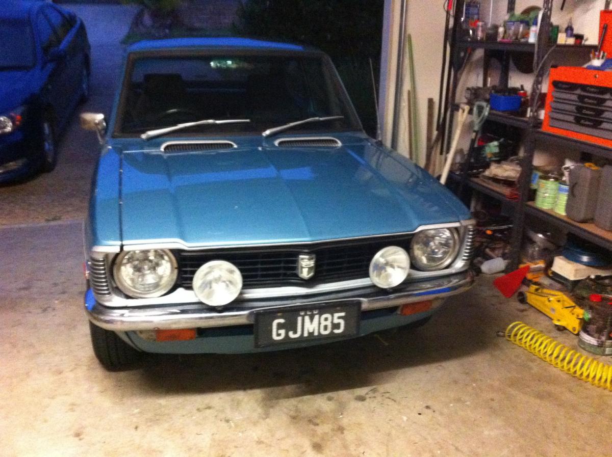

GJM85 Posted April 7, 2015 Author Report Posted April 7, 2015 (edited) They're just a cheap 160mm 100w h3 lights. I had them on my ae92 seca about 8 years ago. I'm gonna swap to the Narva 150mm spot beams as soon as I can. Keeps it looking tidy. Options are quite limited with space restraints on front bumper. I'd like a spot and spread beam combination in a 6" pair but they just don't make them. Any smaller and there's no real lighting gain. Any bigger and they interfere with grill and you can't tilt them up enough. LED's are an option but the price isn't right and they just don't look the part. It's been recommended the I get the headlights on relays to brighten things up also. Edited April 7, 2015 by GJM85 Quote

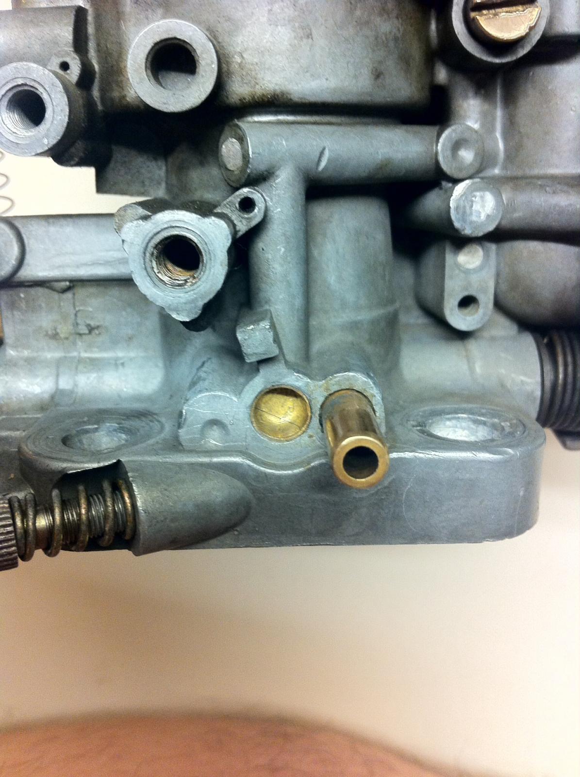

GJM85 Posted April 12, 2015 Author Report Posted April 12, 2015 So after a week of trying to find a mischievous fuel leak from the carb. I discovered a crack in a brass plug in the idle circuit. This leak has been a nasty bitch of a thing, leaning out my idle/progressive fuel mixtures, vacuum leak, fire hazard... I swapped all the bits over to the spare weber I have. The issue is the throttle shafts are worn pretty bad so I'd like to fix this plug. Can I just drill it out and make my own plug or is it more complicated? Quote
Clapped out Posted April 13, 2015 Report Posted April 13, 2015 I'd say drill and see, weber's are so basic. just my 2c. Surely a welsh plug that small should be able to be acquired to replace? cheers! Quote
B.L.Z.BUB Posted April 13, 2015 Report Posted April 13, 2015 Lay it on its side and fill it with solder. Quote
GJM85 Posted April 14, 2015 Author Report Posted April 14, 2015 (edited) So I ended up drilling it out. It's a 7mm plug. I'll just turn some brass on the old mans lathe when I get the chance. On another note, I received the relay harness, Blzbub put me onto. I decided to integrate my own ground wires into the loom to the battery instead of using the earth ring things the supply for each light. As was said noticeably brighter light. But I think running the 100w spot lights off the same relay as the high beams could possibly be drawing too much current as it fried the 15 amp fuse within 5 minutes. I've fitted a 20 amp fuse. I'll see if I get to work tomorrow with out it popping. Edited April 14, 2015 by GJM85 Quote
