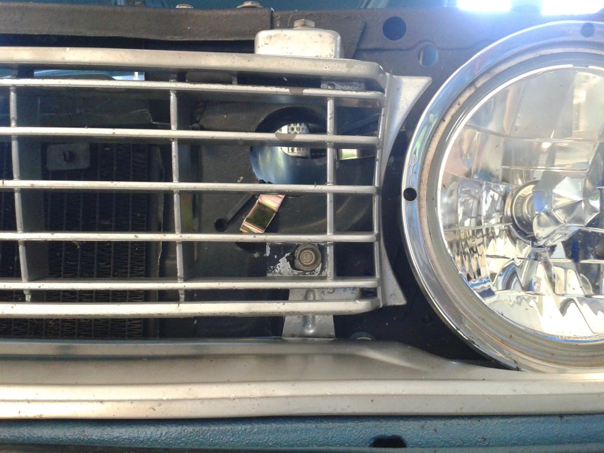

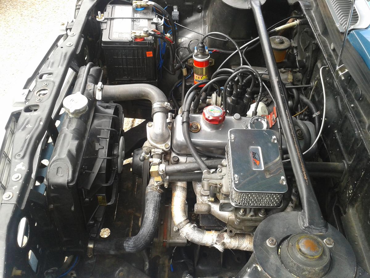

GJM85 Posted January 2, 2013 Author Report Posted January 2, 2013 (edited) The fan was a gift from the inlaws. And it moves a shite load of air. I paid for the wiring, relay, mounting strap things and the coolant. You can get decent ones off egay pretty cheap. Edited January 2, 2013 by GJM85 Quote
GJM85 Posted January 4, 2013 Author Report Posted January 4, 2013 (edited) Chrome arches. I really need the centre caps for the superlites. Edited January 4, 2013 by GJM85 Quote

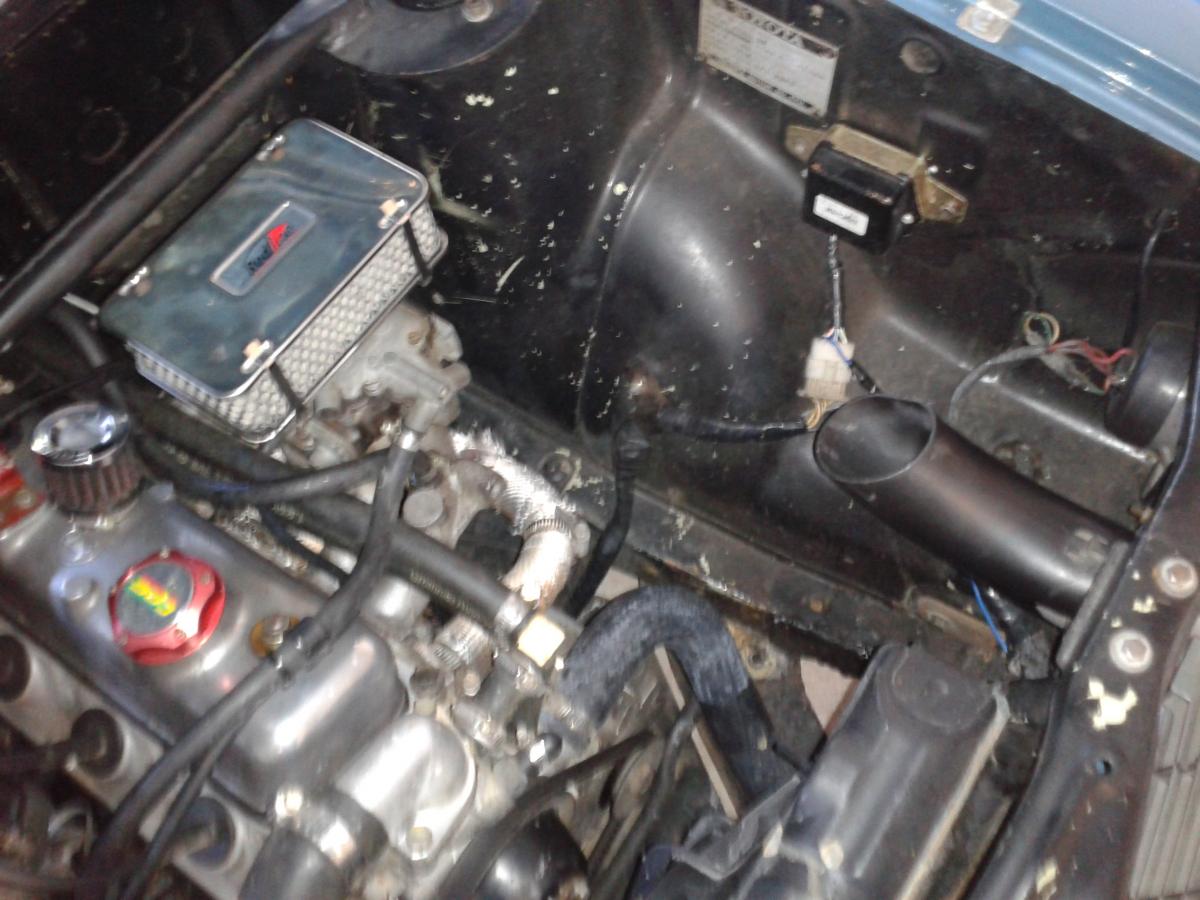

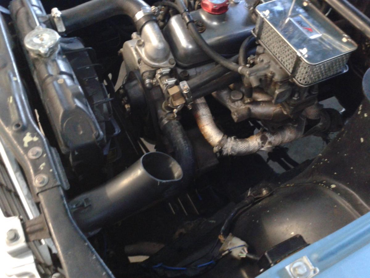

GJM85 Posted January 10, 2013 Author Report Posted January 10, 2013 (edited) Since installing the thermo fan, i've noticed engine running temps are down, while engine bay temps are up due to the fan operating full time. So to give my little weber some relief I developed this... Its a restrictor pipe from an Holden Astra's air box strategically placed where one of the horns used to reside. It looks a little like some type of sex toy... Edited January 10, 2013 by GJM85 Quote

Taz_Rx Posted January 12, 2013 Report Posted January 12, 2013 You need to get the fan on a thermo switch as they don't really do anything above 60 kmh. You can get some nice simple inline one that have prescribed on and off temps. They just screw into one of the end tanks. Quote

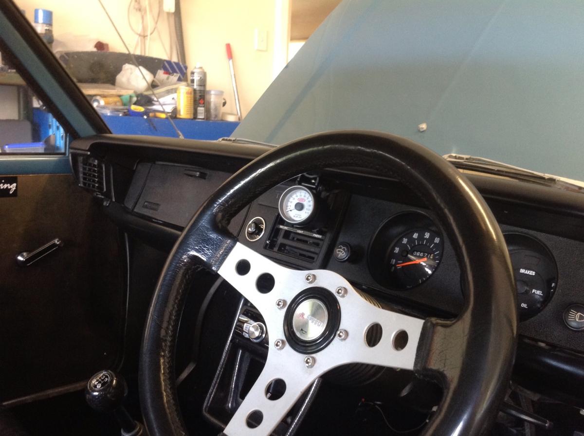

GJM85 Posted March 9, 2013 Author Report Posted March 9, 2013 (edited) Taco taco man! Edited March 9, 2013 by GJM85 Quote
Mark90 Posted March 9, 2013 Report Posted March 9, 2013 Nice! I have mine mounted on top of my steering column but that looks a bit nicer out of the way :) Quote

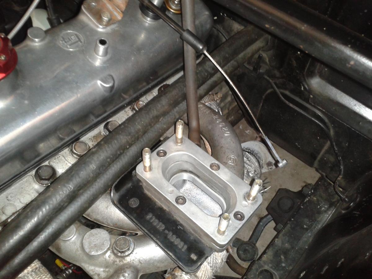

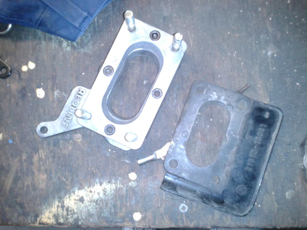

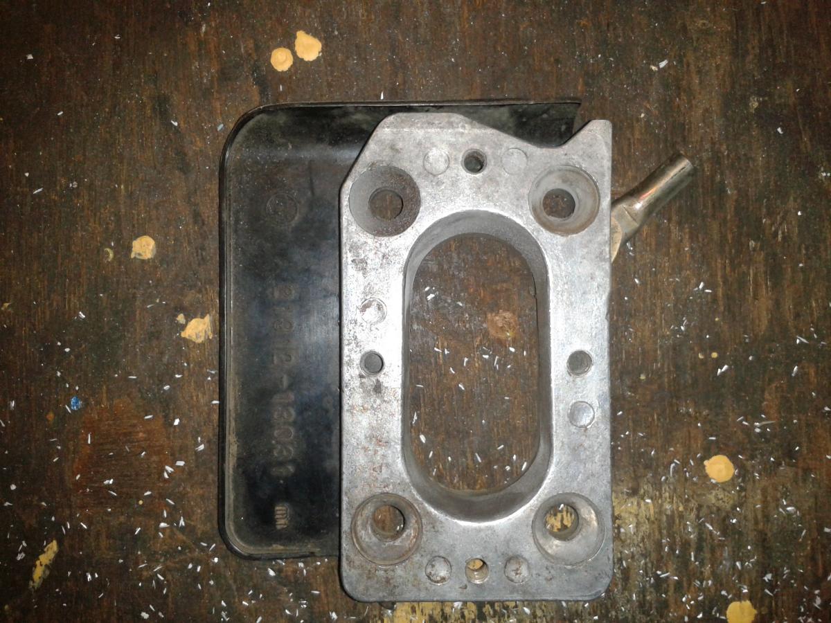

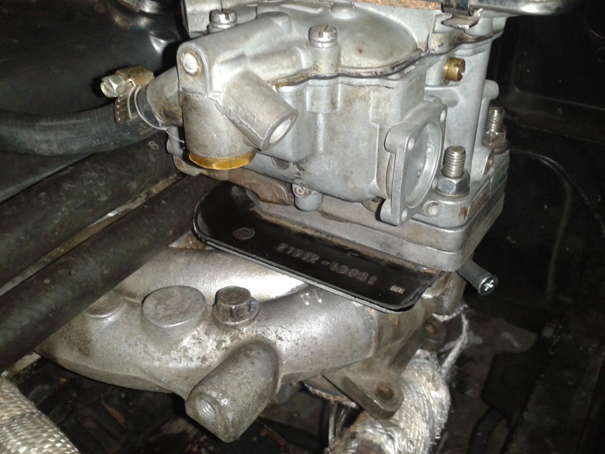

GJM85 Posted March 29, 2013 Author Report Posted March 29, 2013 (edited) So I put a kit through the weber and its made a big difference in respone and economy. Happy with that. I had some electrical issues last week which have been sorted. Today I modified a standard bakerlite base plate from a stock carby to fit between the manifold and the adapter plate. Why, you ask? To reduce heat tranfer to the weber, which in theory should reduce fuel evapouration, increase economy and increase performance. It was easy enough and seems have yielded good results with the fuel bowl feeling cool to touch after a 5km drive. I can also now use the original pcv ventilation system running to the base plate instead of the no.1 intake runner. I machined out the bakerlite plate to suit the manifold and removed a few areas off the lower plate of the adapter to clear the pvc stem and the heat shield. Edited March 29, 2013 by GJM85 Quote
