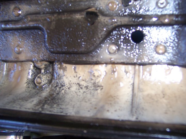

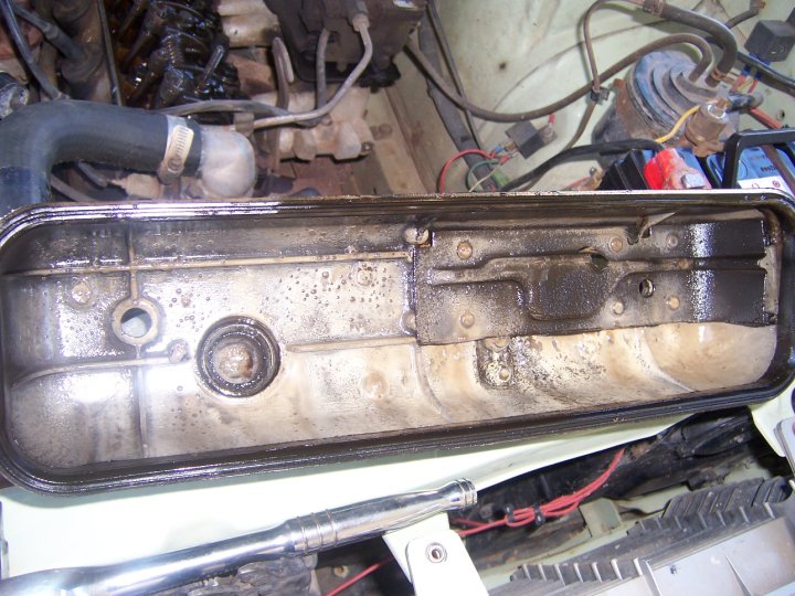

madKE35coupe Posted July 22, 2010 Author Report Posted July 22, 2010 ok guys pulled the tappet cover off this morning, and all over the inside was 'mayonnaise' as most call it, so there is definitely water in the motor. talked to my local mechanic, and he ordered a head gasket and vrs kit for 50 bucks which is pretty cheap i thought? it should be here either tomorrow or saturday morning. hopefully will be running like new by sunday! and don't worry i am taking a heap of pics today and will put them up tonight, including the residue under the tappet cover, for those who havent seen it before. Quote
snot35 Posted July 22, 2010 Report Posted July 22, 2010 Be careful with that. It really depends why there is water in the oil, do a decent amount of investigation if you can. It may be corrosion somewhere, it may be a BHG, and depending on what happened when it went, things may need a skim so that it all seals properly when reassembled. If you don't mind maybe blowing the $50 then just whack it in and see what happens. Otherwise I'd spend a little more time checking everything is OK before putting it back together. Quote

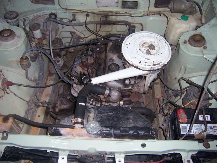

madKE35coupe Posted July 23, 2010 Author Report Posted July 23, 2010 well there seems to be a bit more oil than usual near the head gasket, so i assumed that it was the problem. got the pics uploaded so see if i can put them up now. Quote

ke70dave Posted July 23, 2010 Report Posted July 23, 2010 very straight looking car! as for the head, once you have the head off, drop it at your local machinist get it checked out. they'll pressure test it and prolly give it a skim. if your keen get them to take a bit more off, get some extra bang for your buck;) Quote
