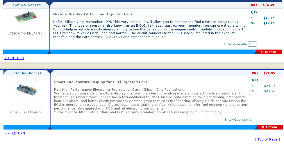

Evan G Posted July 11, 2010 Report Posted July 11, 2010 http://autospeed.com.au/cms/title_InCar-Ai...32/article.html check that out, Mixture Display Kit for Fuel Injected Cars (Silicon Chip/Jaycar) Price: AUD$14.95. Quote
altezzaclub Posted July 11, 2010 Author Report Posted July 11, 2010 (edited) Yes, I started out with that idea Evan, then I learnt more... So, what do we need for that? The $20 kit, a sensor, and.... do we need a controller like the Jaycar $80 one I posted up on page 1? Some cabling that I can cut out of a car at the wreckers with a wideband sensor on the end?? Any ideas on which model of car would do this? Edited July 11, 2010 by altezzaclub Quote

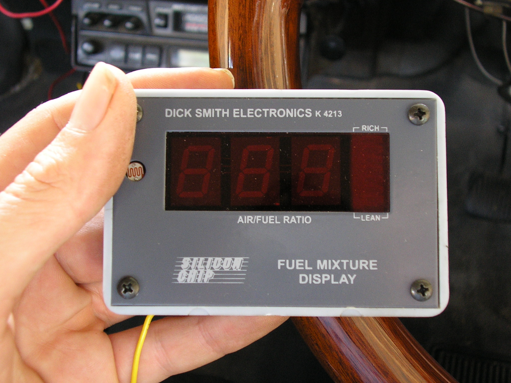

Felix Posted July 12, 2010 Report Posted July 12, 2010 (edited) Trev said: Don't know what that has to do with it. Maybe he means that seeing as carbs are an analog device, and the motor is not boosted, a wideband is not a necessity. I put a narrowband in my ke15 with one of those Jaycar FMD's. Cost... $100 all up (about 6 years ago). Shitloads better than stumbling in the dark. The numbers may not be exact, but you have a definite guide as to which way your tuning changes are going. Once you have it set up it is a simple task to upgrade to a wideband o2 sensor and to fit the wideband controller. Anyway, personally I'm thinking of getting one of those LM-2 Kits at a later stage. Edited July 12, 2010 by Felix Quote

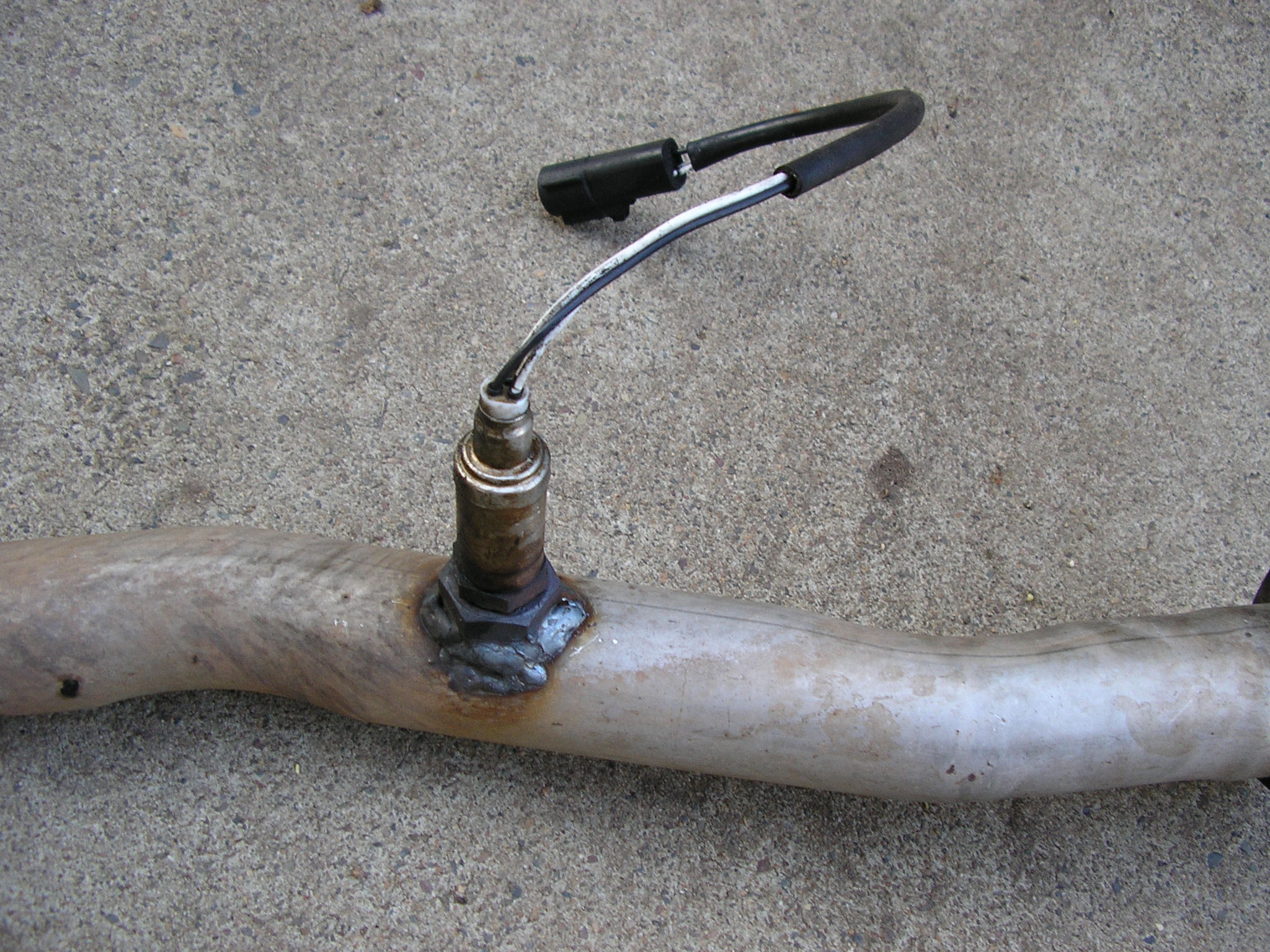

Felix Posted July 12, 2010 Report Posted July 12, 2010 (edited) The kit I used was an older Jaycar/DSE narrowband FMD kit (DSE was the one I used). I got an M18x1.5 nut and ground it to suit the outside of the exhaust after the extractors. Got it drilled and welded for a 6 pack. Used a second hand EB falcon heated 3 wire o2 sensor. Edited July 12, 2010 by Felix Quote

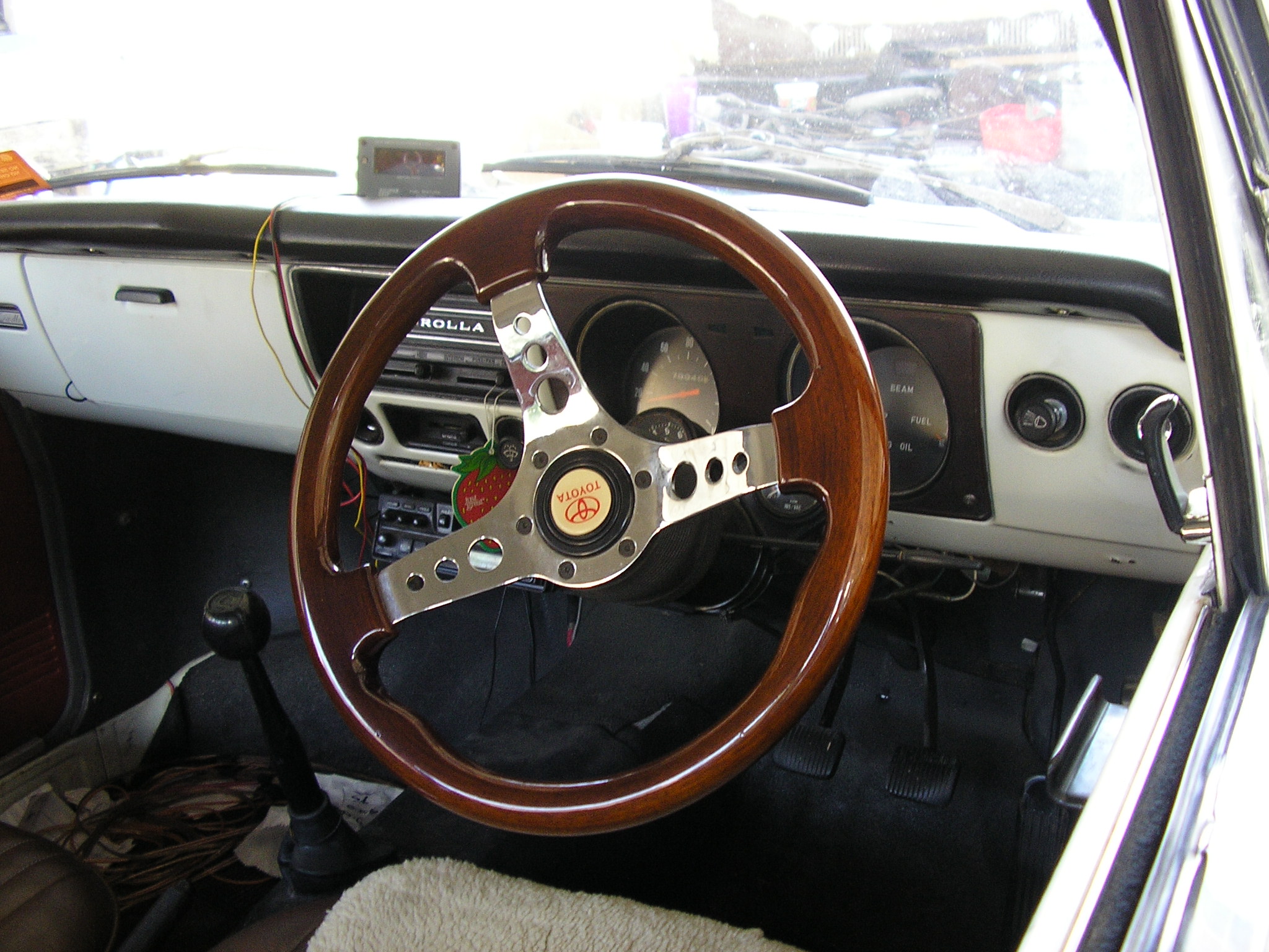

Evan G Posted July 12, 2010 Report Posted July 12, 2010 your last picture of your ke15 says rolla LOL! Quote
altezzaclub Posted July 12, 2010 Author Report Posted July 12, 2010 Felix you're my sort of mechanic! :( So, wreckers for three-wire EB Falcoon sensor to start with... If I can get a narrowband setup working I might broaden it to wideband later. Thanks for that! Quote
