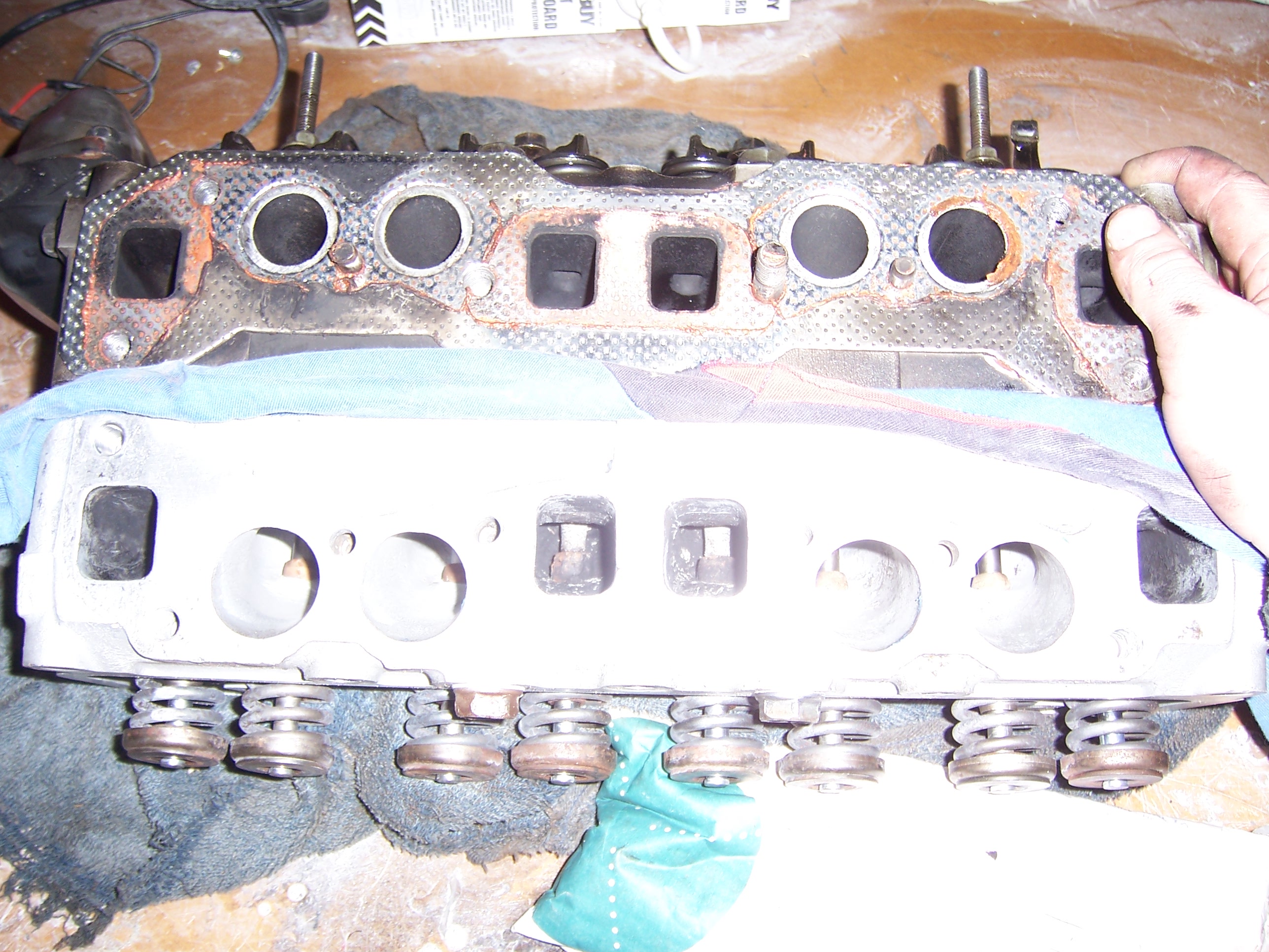

Taz_Rx Posted July 14, 2010 Report Posted July 14, 2010 Thanks phatke30, but can you elaborate? How can I tell it's a 4k setup after removing the oil cap? Couple of different ways: 3kbp's have an o-ring around the top of the valve stem as a stem seal. 4k's have a much nicer seal which clips onto the top of the valve stem guide. Also the top valve retainers are the easiest way to pick them. The 3kbp ones curl around the top of the spring a bit and down the sides slightly as seen in below pic (bottom head). You can't see the 4k ones all that well but the top retainer is flat and doesn't curl around the side of the spring. Quote
Nostalgia Posted July 14, 2010 Author Report Posted July 14, 2010 So a 4k with a 3kbp head will have the head with the o-ring seals? But the valve springs from the 4k head? Sorry, I'm just starting to learn about porting etc! Quote
