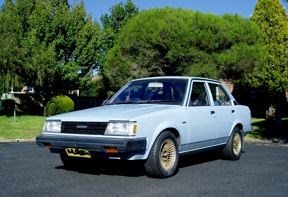

altezzaclub Posted March 23, 2012 Author Report Posted March 23, 2012 Wheel nuts! Don't talk to me about wheel nuts!! The ones I need don't exist! When I bought the Datsun over from NZ in bits I had saved 4 Datsun factory rally mags from the dozen I had. Then I sold things like the rally suspension to a guy building a Southern Cross Rally replica 180B, and he swapped the works mags for a set of ROH. Having never got the Datsun on the road here I hadn't driven on them, but figured they would gear the KE70 up on the trip to Cairns. 13" KE70 wheels have a radius of 265mm, the 14" ROHs have 285, so that's 7.5% decrease in revs, compared to a 4.6% difference in changing diffs from the auto 4.3 we have to a manual 4.1. Its 260rpm at 100kph... say 3610 down to 3350rpm, suddenly closer to 3000 than 4000 for cruising 10hours a day! So in my endless search for the ideal wheel nut I headed down to Cowra this morning. 'Down' is the word, Orange is at 850M altitude and Cowra is at 300M, although there are many ups and downs. The tyre change killed the sparkle it has around town, it takes more to get it moving, and it has knocked it back to stock when hitting a hill! As soon as 3000rpm is reached its down to 4th instantly. Cruising is fine though, I think I'll still end up sitting on 3500revs, but just go faster. When we bought the car I was quite happy with burling along at 90kph... now I expect ti to do 100kph everywhere! Quote

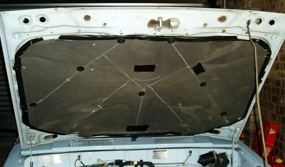

altezzaclub Posted March 23, 2012 Author Report Posted March 23, 2012 I also grabbed a par of stock rear springs to try and soften the ride for the trip, and although they are one coil higher and lift the car an inch, the ride is very much the same. So in that photo above the nose is an inch lower and the tail is stock height. The other thing from the wrecker was a Commodore bonnet insulation sheet, which now sits above the mighty 4K! I think its a tiny bit quieter, I can hear the wind noise around the driver's window more! Quote
snot35 Posted March 26, 2012 Report Posted March 26, 2012 Like the mags, I've got two sets at the moment slowly working their way to getting mounted on the khana car. They just need a tidy and some paint! What rear springs did you have before? I grabbed some stockies on the weekend as I want to soften the rear as well, but I'm not sure if it's actually going to work, they're a heavier gauge coil then I expected. Quote
altezzaclub Posted March 26, 2012 Author Report Posted March 26, 2012 Those lowered springs came out of the donor brown car, so I don't know if they are cut stockies or something else. The wire diameter is 12.2mm on both the short & stock springs, the shorts are one coil lower, (7.3 coils against 8.3coils) but they are also a fracton larger in spring diameter, 132mm stock, 134.7 short springs. Maybe that's within the factory tolerance & they are just stockies with a coil cut off. Measure the stud holes in your ROH mags and let me know. Mine are 17.2mm, impossible to find nuts for, and everything else in the world has 18.4mm holes & nuts... I'd drill the suckers but the drill bit is $55 to buy & I'd hate to get them off center! Quote
