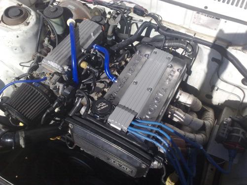

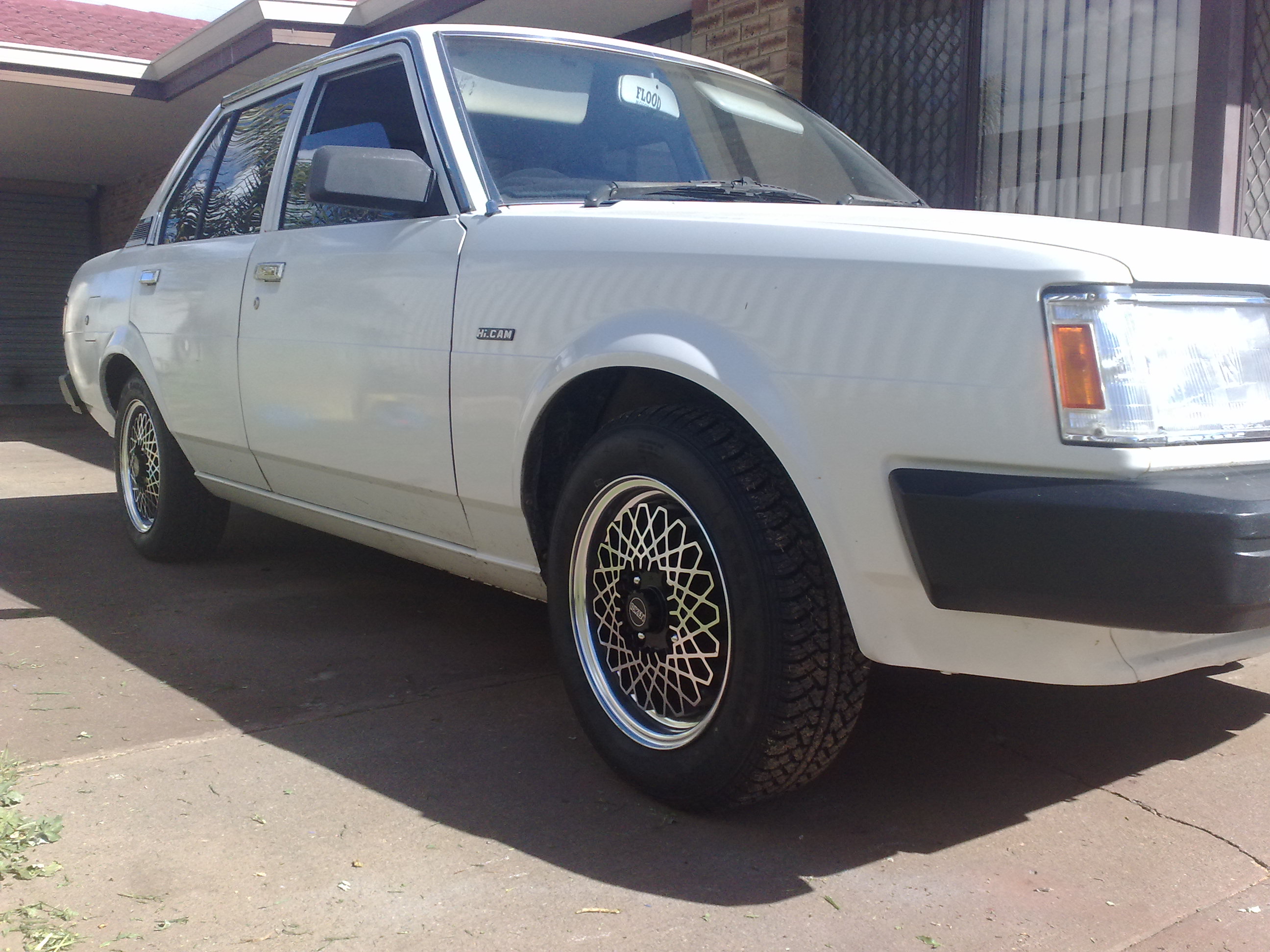

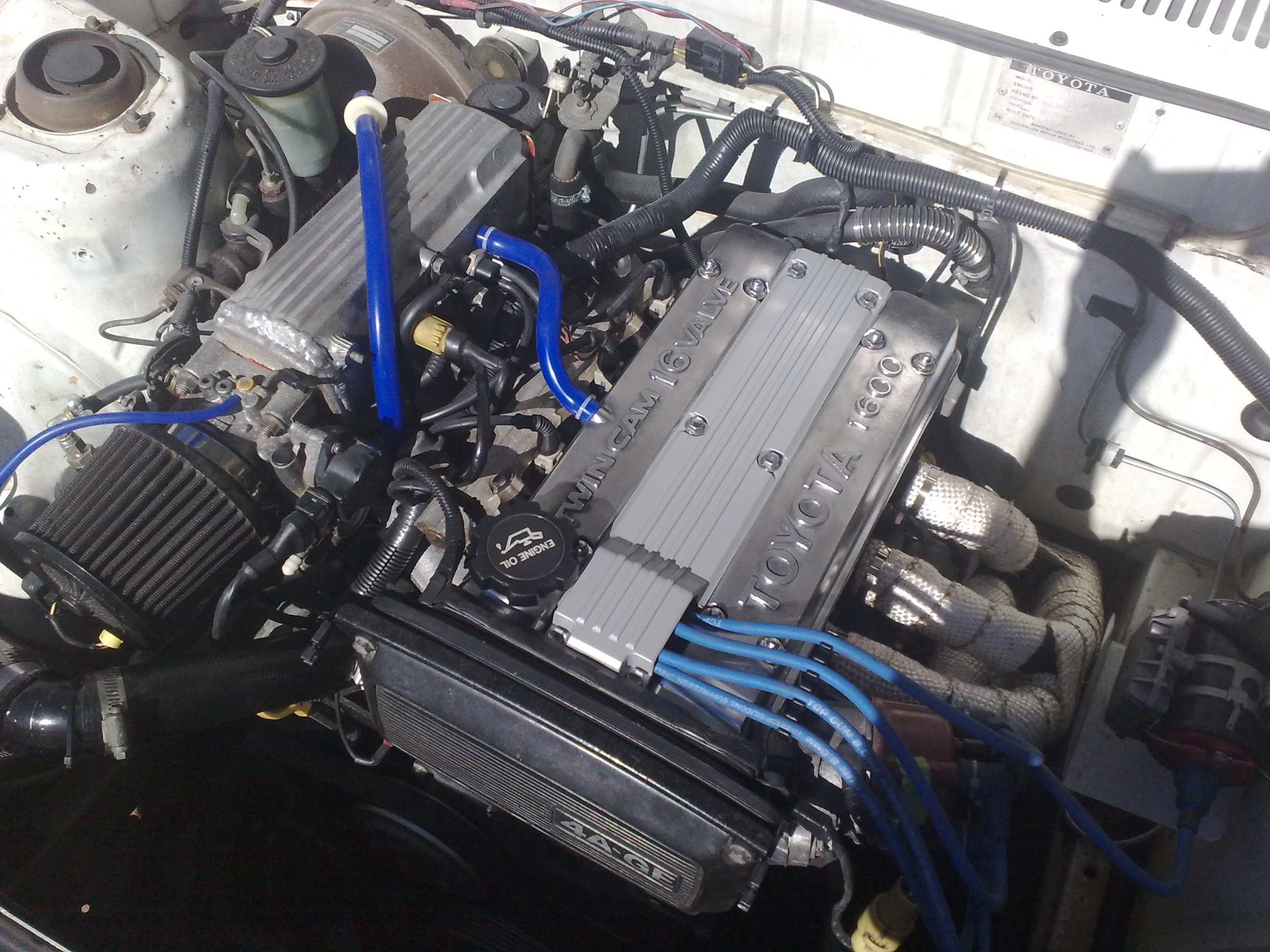

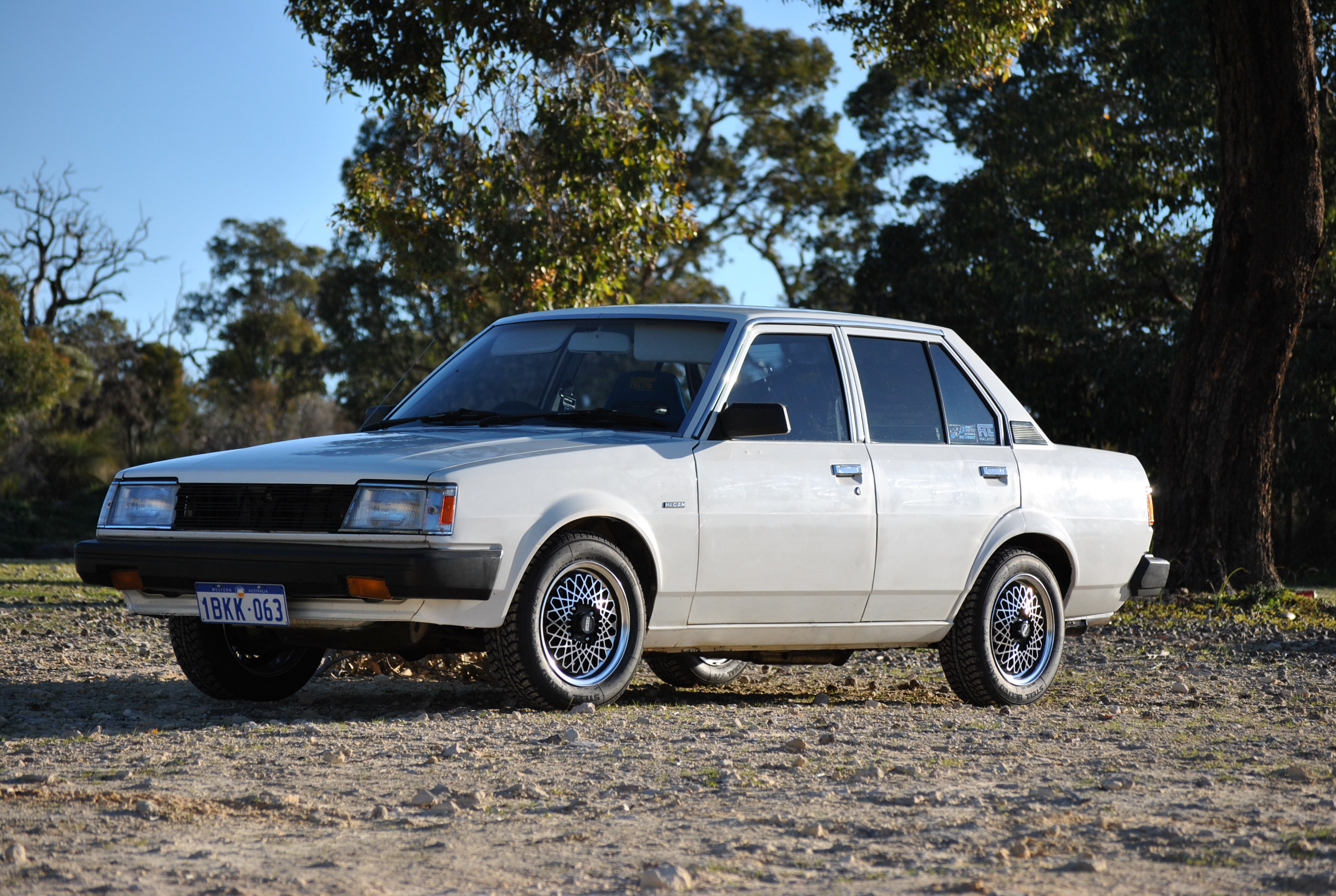

imprezd Posted June 9, 2010 Report Posted June 9, 2010 (edited) Ok some of you guys might know the car as i bought it from Kiahn.. I cleaned it up a little and took it over for pit inspection and it passed first go with oil leaking into rocker valley lol kiahn did the conversion useing a 3 rib bigport that needed too much work to bring it back to life so instead of rebuilding it again i gave that to my mate for him to play with and i replaced it with a 7 rib smallport.. its running a modified smallport intake with all the bigport throttle body and sencors and bigport injectors lowered pedders springs adjustable pannard rod 13 inch alloys (unknown brand) K&N air filter Dunnydoor ally radiator tinted windows NoS brand sports seats suede sports wheel Edited August 22, 2010 by imprezd Quote
danman Posted June 9, 2010 Report Posted June 9, 2010 Looks clean and straight mate. :) Fuels my inspiration to get mine on the road. Quote
white_sandshoe Posted June 9, 2010 Report Posted June 9, 2010 That was a damn score... Good to see it's getting a strong 7 rib engine. Will be great to see this burning rubber. Quote

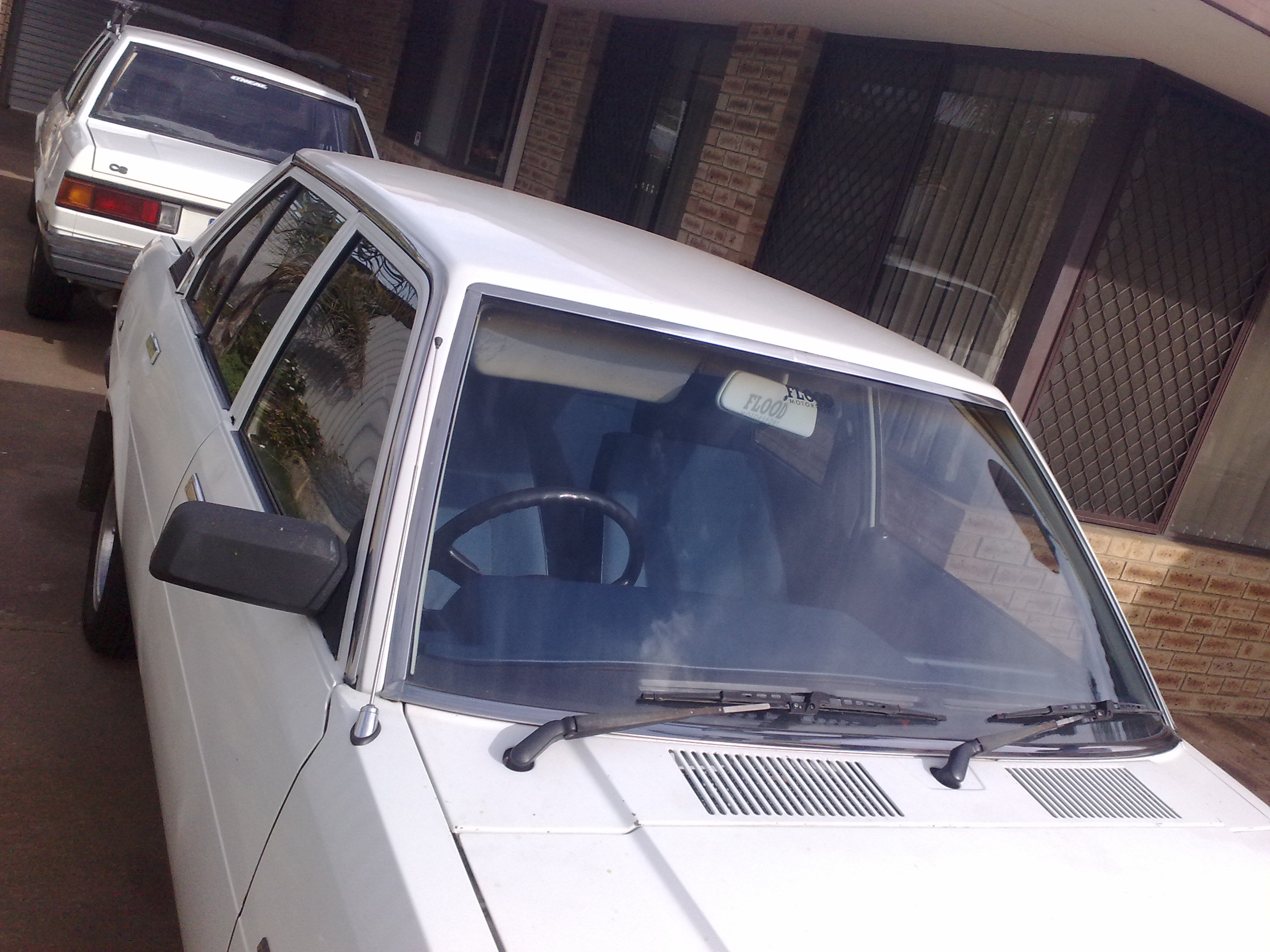

imprezd Posted June 11, 2010 Author Report Posted June 11, 2010 Added some tint today looks a bit better now Quote

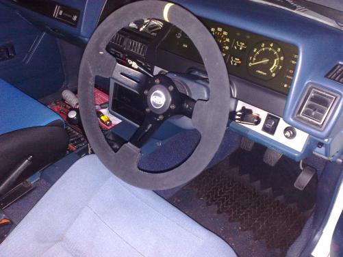

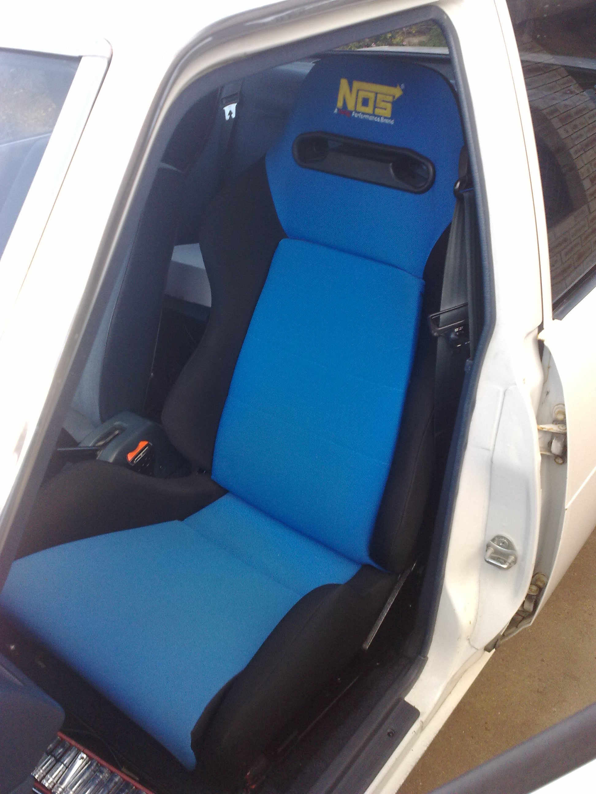

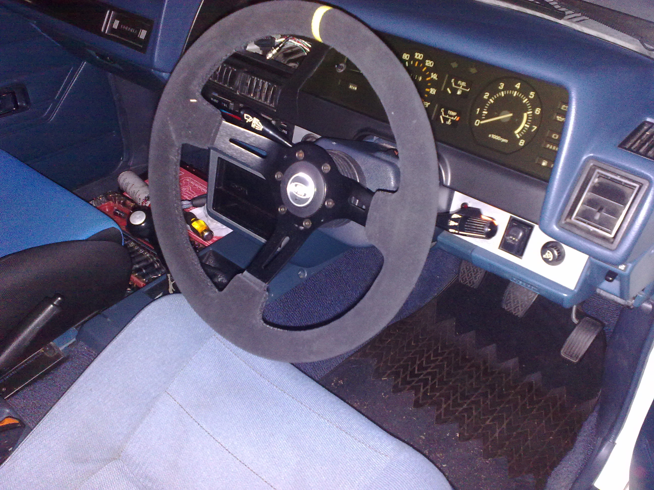

imprezd Posted June 16, 2010 Author Report Posted June 16, 2010 (edited) fitted one of the seats today sits in there quite nice Ooops almost forgot the new suede sports wheel.. Edited June 16, 2010 by imprezd Quote
Corey_wwv Posted June 16, 2010 Report Posted June 16, 2010 hey first i would like to say neat ride :lol: i noticed the work you had done to the engine just wondering if all the internals are stock like cams, pistons, conrods lso the compression ratio? I'm also mildly new to some of the lingo and was wondering what you mean by 'rib' like 3 rib and 7 rib thanks, corey Quote
imprezd Posted June 16, 2010 Author Report Posted June 16, 2010 Corey_wwv said: hey first i would like to say neat ride :lol: i noticed the work you had done to the engine just wondering if all the internals are stock like cams, pistons, conrods lso the compression ratio? I'm also mildly new to some of the lingo and was wondering what you mean by 'rib' like 3 rib and 7 rib thanks, corey thanks man if you look on the side of the block there are streight casting lines running verticaly across the block from front to rear of block they are about 1cm wide the stronger blocks have 7 and the other ones have 3... I hope that makes sence and helps Quote
ae824ate Posted June 16, 2010 Report Posted June 16, 2010 Toyota brought out a few different designs of 4a-ge. 3rib block, 7 rib block, big port heads, small port heads, 20 valves, GZE's, MAP sensored, air flow sensored etc. Have a looksie (http://www.billzilla.org/4agstock.htm.) Very informative for people wanting to learn about toyota goodness. Thanks, Luke. Quote
Grand Master of Awesome Posted June 16, 2010 Report Posted June 16, 2010 wheels look like work 03 copies? looks good anyway. maybe more low :lol: Quote
Ben-89 Posted June 17, 2010 Report Posted June 17, 2010 This is a wolf in sheeps clothing, preety much standard on the outside but gets up and boogies. Nice job mate. Quote

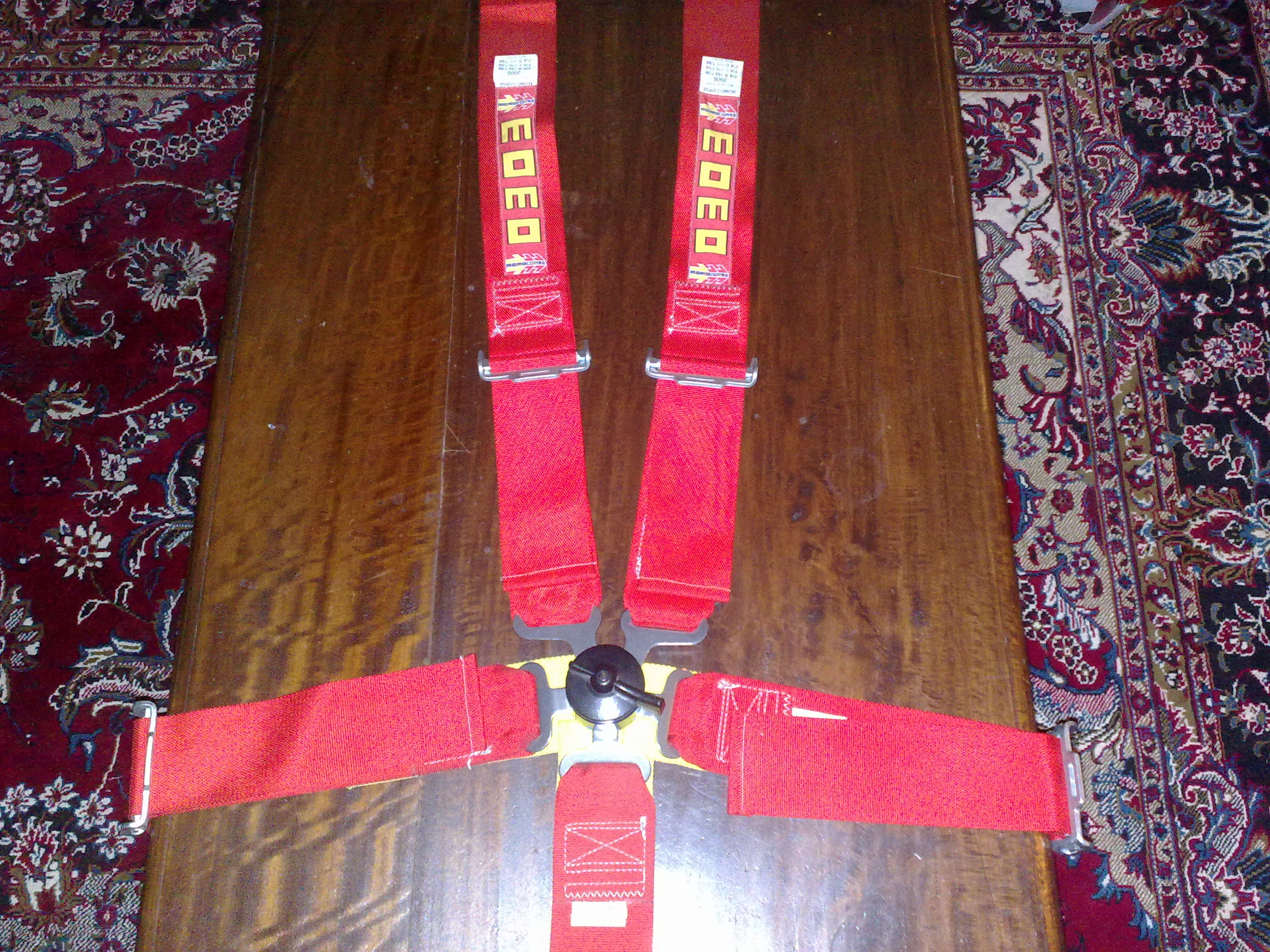

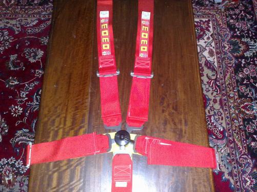

imprezd Posted June 17, 2010 Author Report Posted June 17, 2010 got these for free today no complaints from me lol Quote
