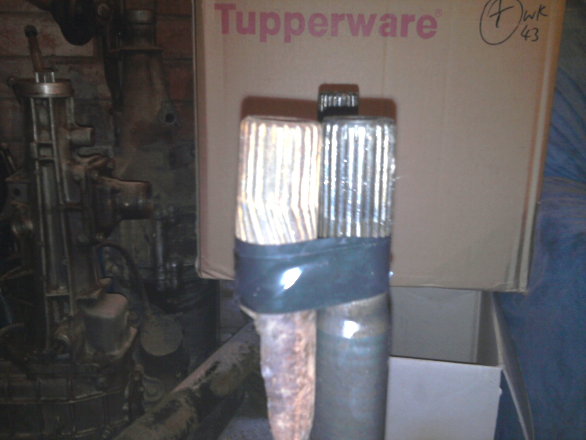

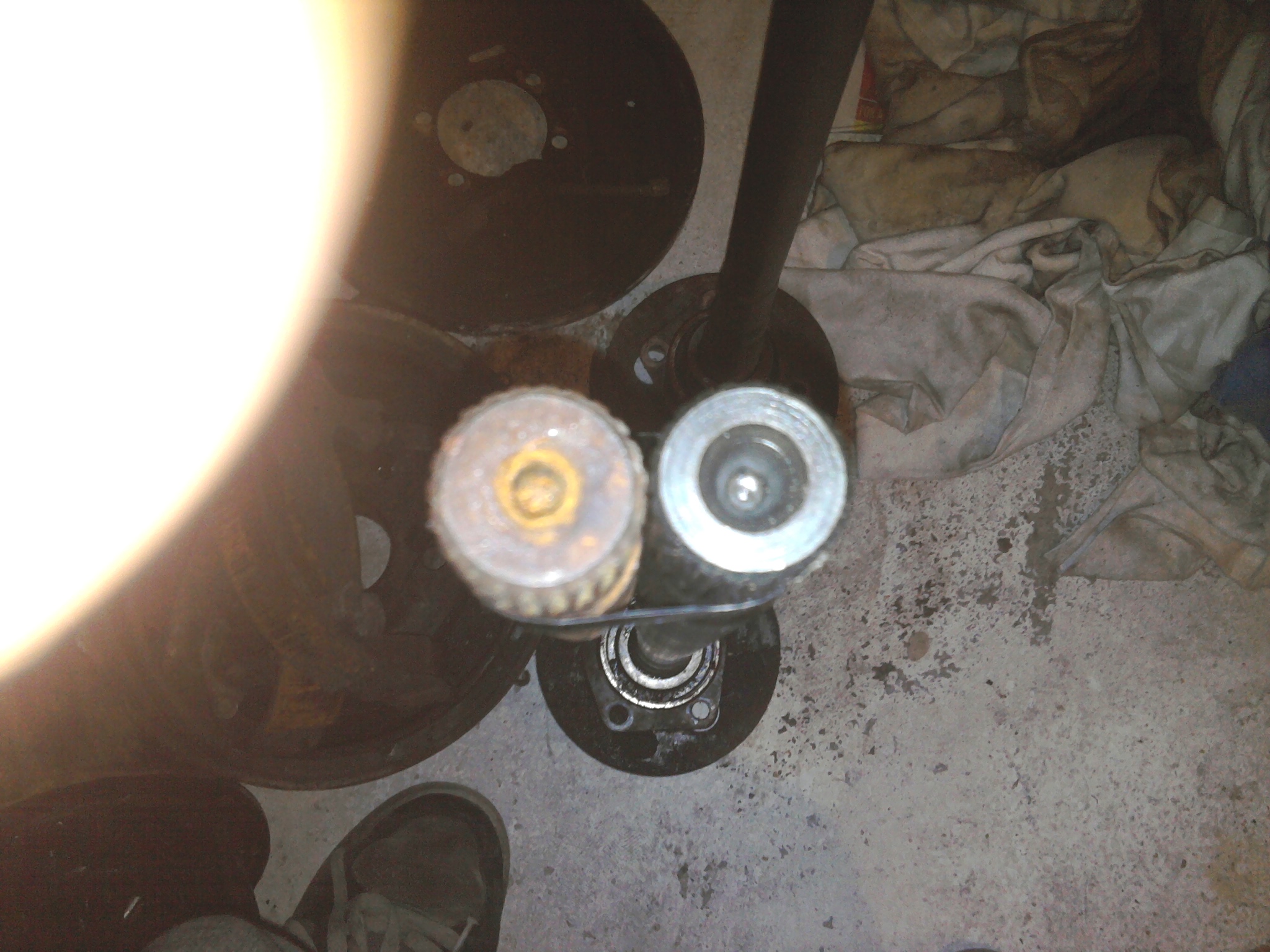

Taz_Rx Posted June 8, 2010 Author Report Posted June 8, 2010 (edited) corollaart said: Maybe like philbey said it might have finer splines ,than the 55 .interesting to see though ,i have a ra40 and the axles look weak as piss. :) Need some pics of the two?? rob Nah its deffinately smaller. The fact that the Zenki axles could freely turn inside the '55 centre is proof of this. Splines look much the same. wde_bdy said: Also, whe you refer to KE30 axles in the KE20, I think this is only for Jap spec, not sure if it actual works on the Oz stuff or if the KE20's even got the BW diff. I think you might be right. I've never had to do this so have never really researched it, but what you'd said would make sense - You'd use jap spec (Banjo) axles in the Jap spec KE20 diff.... with 5mm trimmed off. Can anybody confirm this? Pics up in a sec. Edited June 8, 2010 by Taz_Rx Quote
Taz_Rx Posted June 8, 2010 Author Report Posted June 8, 2010 Piccies: KE55 (broken) axle is on the left, and Zenki on the right..... ....yes I did an awesome job of snapping that axle. :) So I've had a bit more of a think about weather to use the Zenki or not. :) I've snapped 3x '55 axles in my rolla life...... and all of them have been while using a welded diff. And only one of them was broken while giving it a hard time (snapped when I rolled off the burnout pad at the drags and hooked up), the other 2x broke while just casually driving around town (one was when I casually pulled into a car park at a bottle shop). What does this say - Weldys put A LOT of strain on axles. So, if I were to run and LSD instead of a weldy this strain would be minimal. For this reason I'm thinking I might actually stick with the Zenki since I have it. I would like to hear some opinions from others though? Quote

corollaart Posted June 8, 2010 Report Posted June 8, 2010 Yep nice job on the axle there taz ,but i think i got it all worked out .The problem is that your store your axles next to tupperware . This my friend is a huge no no :) :) . As this tupperware is quite toxic (even to car parts )it has been banned in many countrys . As well bountys have been put out for people who sell this stuff. cheers rob :bash: Quote
philbey Posted June 8, 2010 Report Posted June 8, 2010 Yeh almost defintely the welded diff is the cause of the failure. Get me a picture of the fractured face of the axle in high res and as clear as possible - use the macro function on the camera if you've got one, so that I can see the grain structure of the metal. with lockers, that chirp chirp chirp puts a fairly intense "on and off" cyclic load on the axle. Those tiny radiuses on each spline act to magnify any stress within the metal, so that almost certainly you'll be able to pick the exact spline that the fracture started. Quote
