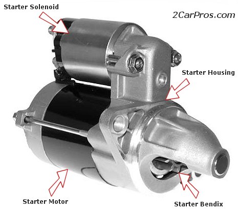

xmoht Posted June 5, 2010 Report Posted June 5, 2010 Hey everybody dealing with this problem myself as we speak. Just charged the batt and that's all good. Having trouble locating the solenoid on my 4K. Looked in the knowledge base section but doesn't tell me where to find it. Thanks, and yes I know I'm a total noob. Quote
KENut Posted June 5, 2010 Report Posted June 5, 2010 The starter motor solenoid is attached to the starter motor. Passenger side under the exhaust there is two cylinder sorta things. Wack the small one with previously said lump of wood and you might get lucky... Quote
