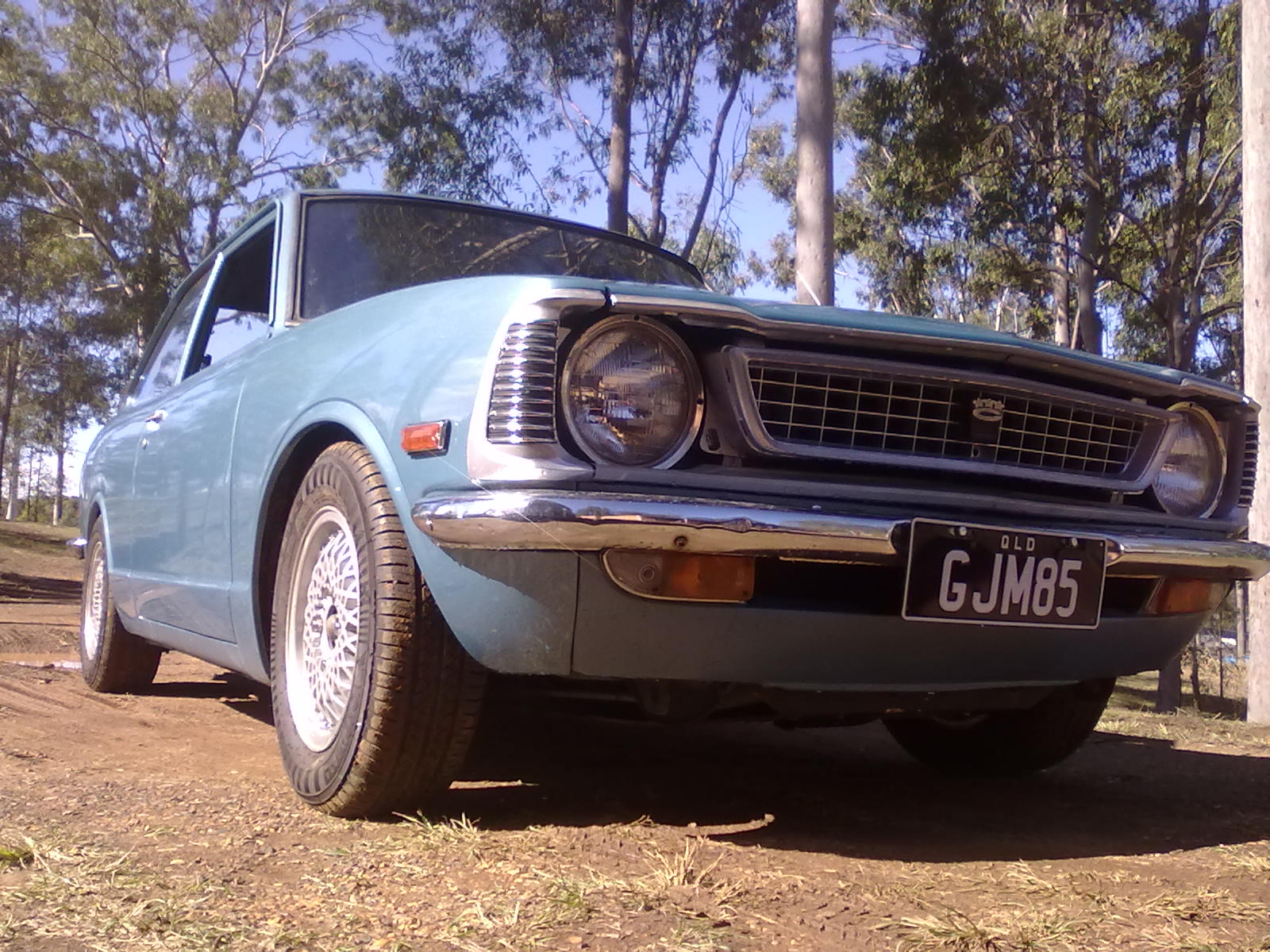

GJM85 Posted February 16, 2011 Report Posted February 16, 2011 I just picked a ke25 grill from ebay. It's goiing on the 20. The top three mounting points are sweet. The lower center is to the left instead of the right and the lower outers are further out than the 20 grills. I currently have 3 grills with the pointi centre and one ke25. Quote
