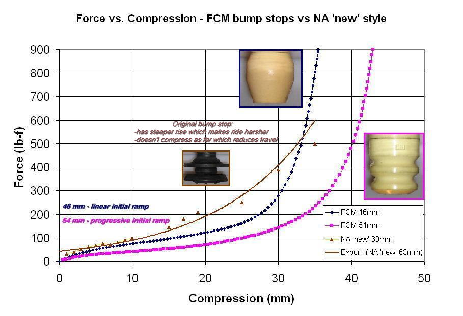

altezzaclub Posted February 15, 2011 Report Posted February 15, 2011 This sort of thing- soft to start with then stiffens up. http://www.fatcatmotorsports.com/FCMstops_comp.htm Quote

jaygore Posted February 15, 2011 Author Report Posted February 15, 2011 On 2/15/2011 at 12:20 AM, altezzaclub said: This sort of thing- soft to start with then stiffens up. http://www.fatcatmotorsports.com/FCMstops_comp.htm Out of those ones which ones would I be wanting to purchase?? Quote
