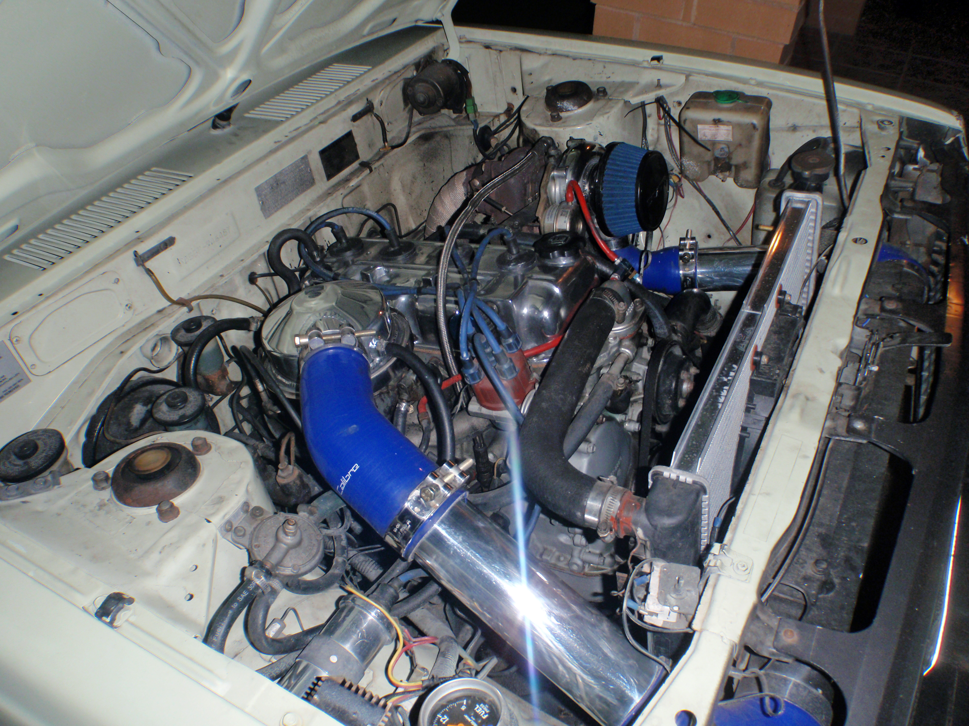

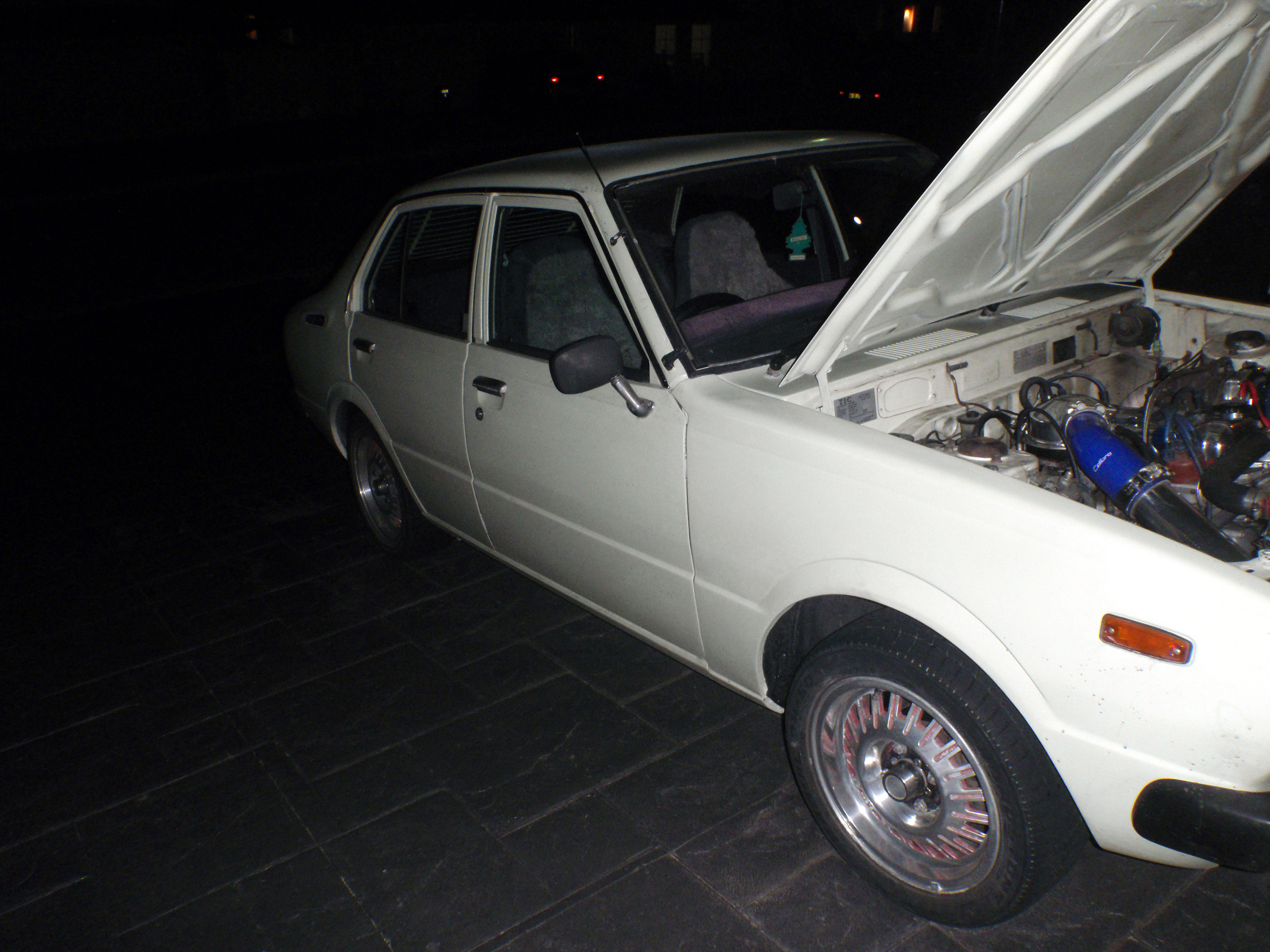

the colour is acutlly the old lime green but for some reason the cemera like the car better white lol
Hi the motor and that looks pretty cool ive got a rolla with a 3t in it as well and i was thinkin about goin turbo i was just wondering what carbie are you using on yours
hey champ carby is standerd just rejetted runs 10psi fine just heavy on the petrol if u put ur foot into it

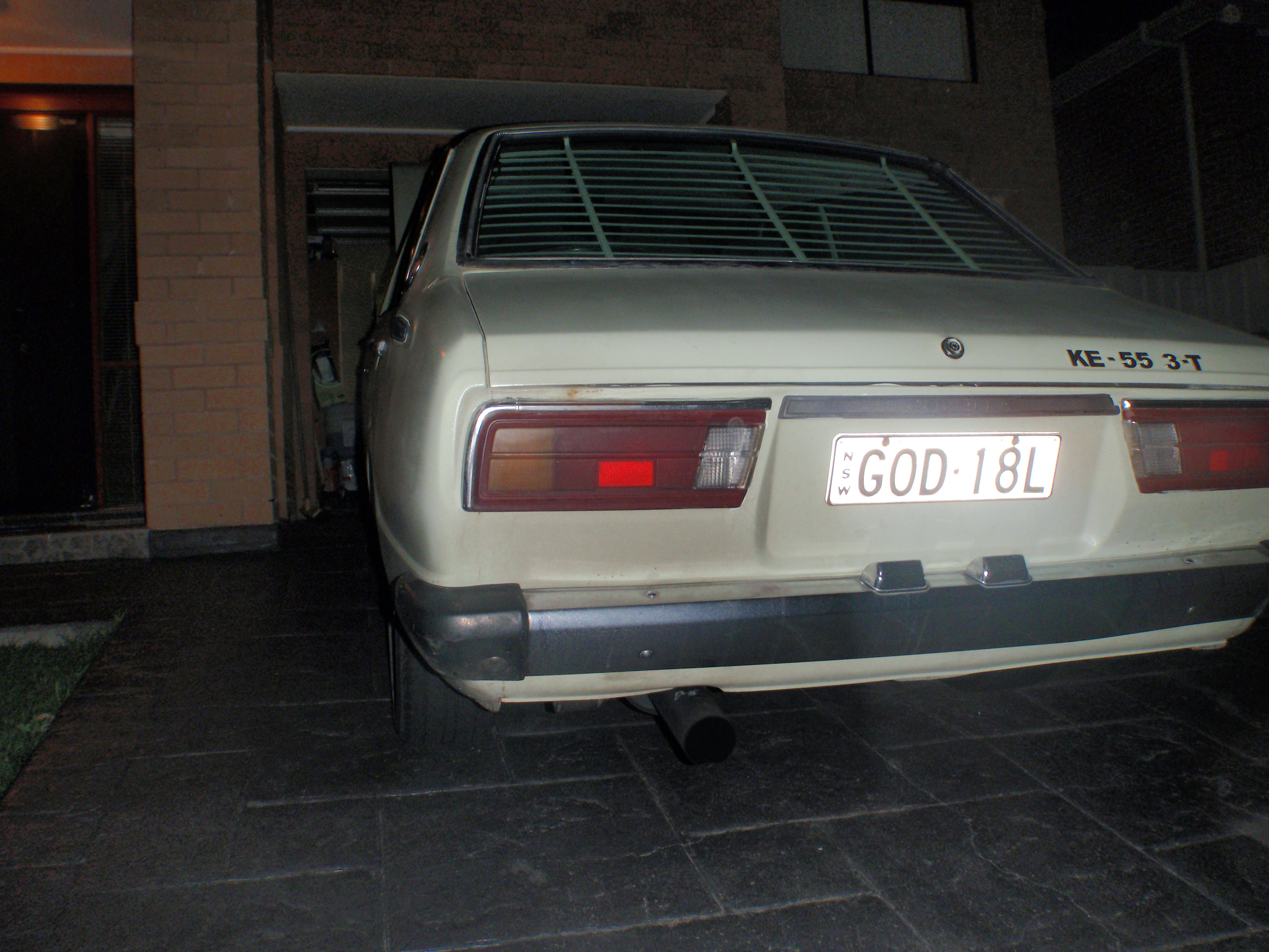

I'm looking round $3500 but is neg rust near the fuel cap, rear wheel bearings are nosiey and the speedo cable just broke and the rear muffler require replacing/welding carcked round the rear

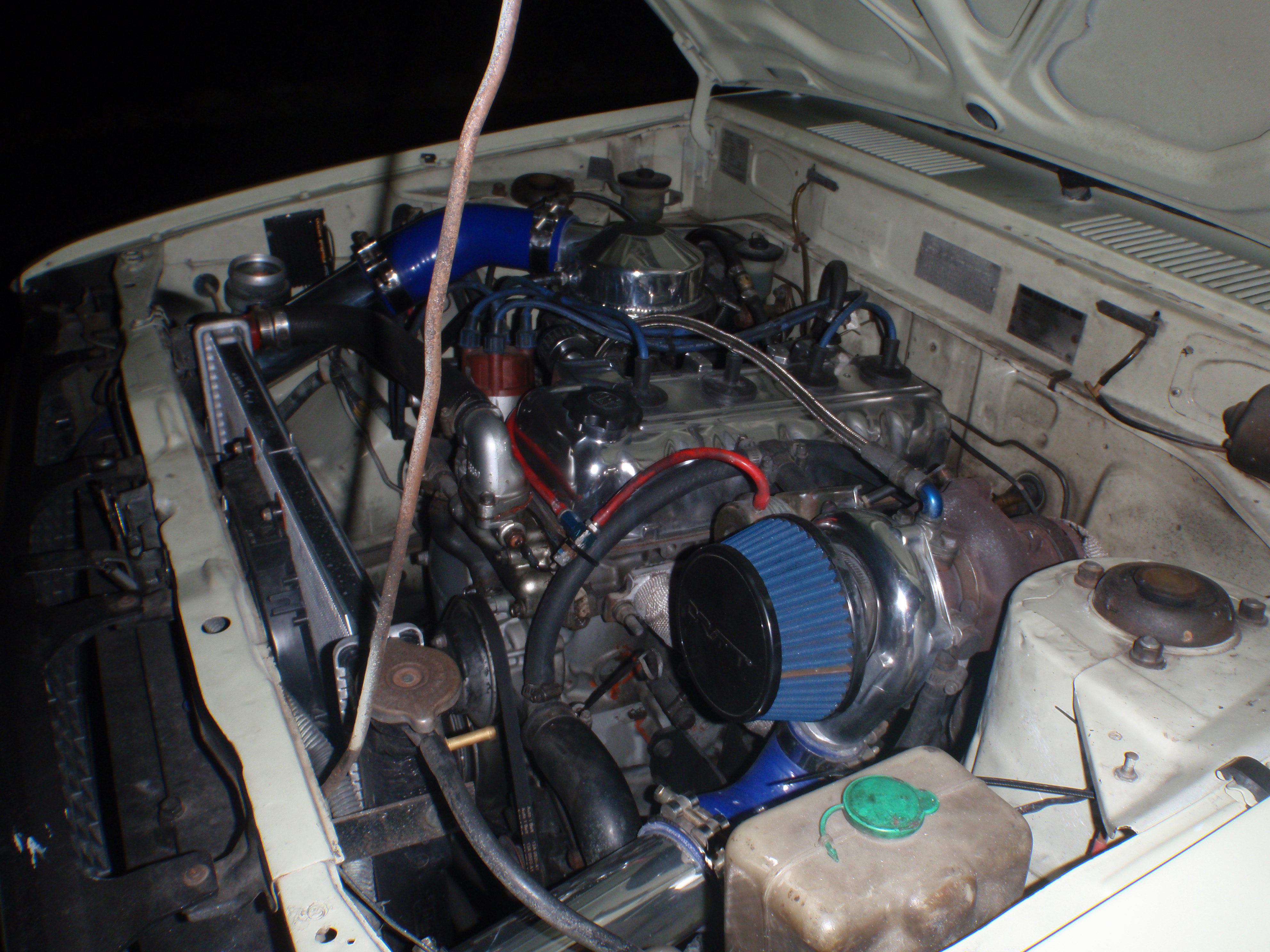

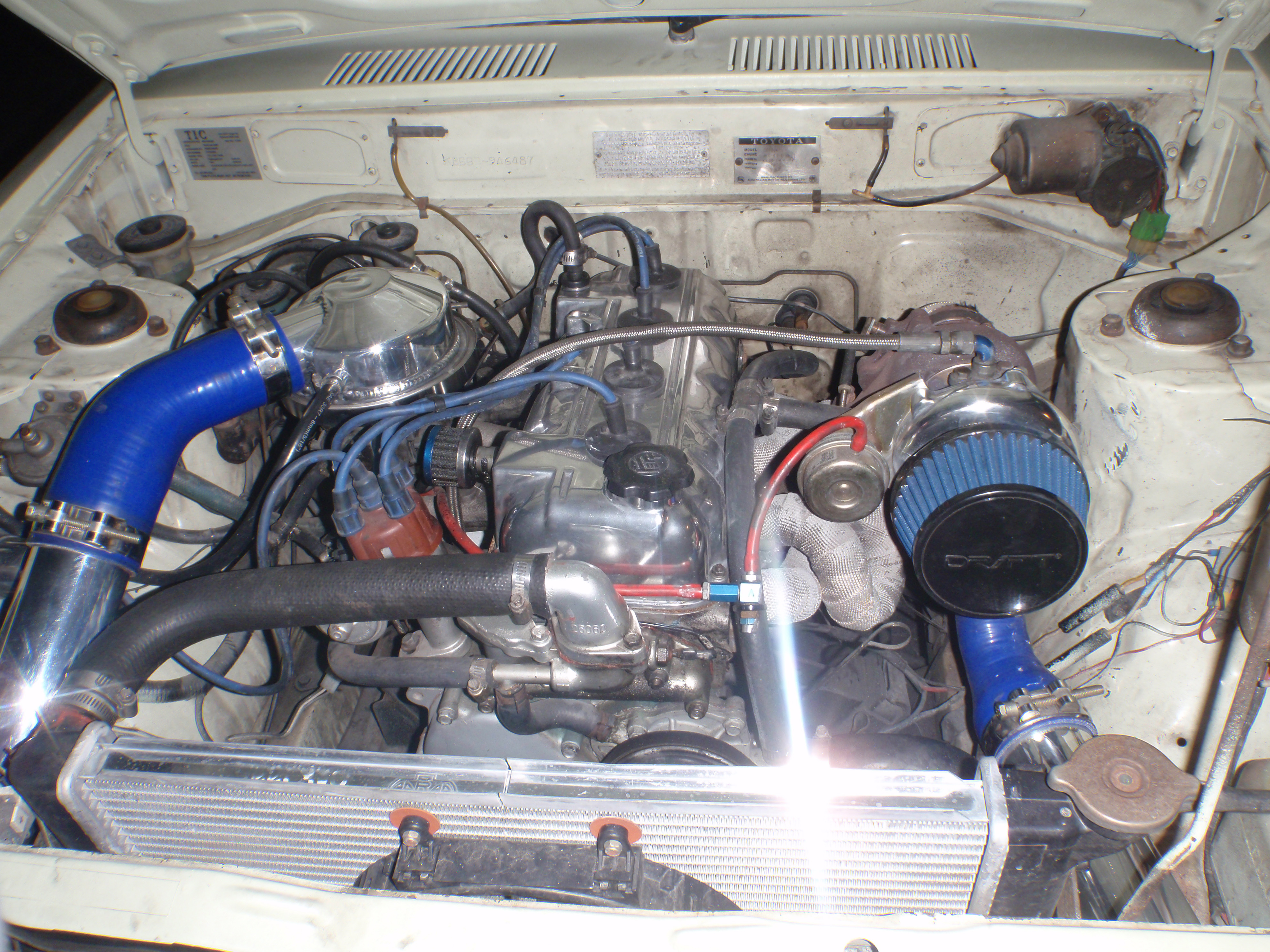

umm mod electonic ignition,turbo running 8psi,custom manifold,custom carbie hat,front mount t50 box,hydrulic clutch, holly blue fuel pump, malpassi fuel reg, rejetted carbie to suit boost, sigma diff and suspenion, ill try get some descent pic of it in the day light just serviced
