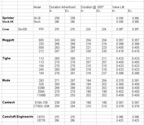

altezzaclub Posted May 26, 2010 Report Posted May 26, 2010 Quote i gave crow cams a call today and all they said about a cam for " the old 4k " is that they havent had anything to do with the k mortors for about 3-5 years and wanted nothing to do with me Odd!! I sent mine off in January and got it back OK. Part number 600606 You must have ot the office dummy! Go back to them and ask for the organ-grinder.... The valve spring replacements are from the Holden 202 motor, but stock springs should take 0.4" cam lift OK. Quote
RainWarriorDregs Posted May 26, 2010 Report Posted May 26, 2010 i'm getting 0.423" lift and staying with stock springs. is it a massive job changing springs? i'd really like something that just fits, without requiring more machining. Quote

altezzaclub Posted May 26, 2010 Report Posted May 26, 2010 (edited) Crow have just told me- Quote We still do regrinds, (your own cam) but can't do new cams as they no longer make the blanks He said to email him directly- Just take the spaces out that I put in to prevent the bots recognising an email addy. martin@ crowcams .com .au You must have got the office cleaner with a sense of humour! :happy: Edited May 27, 2010 by altezzaclub Quote
