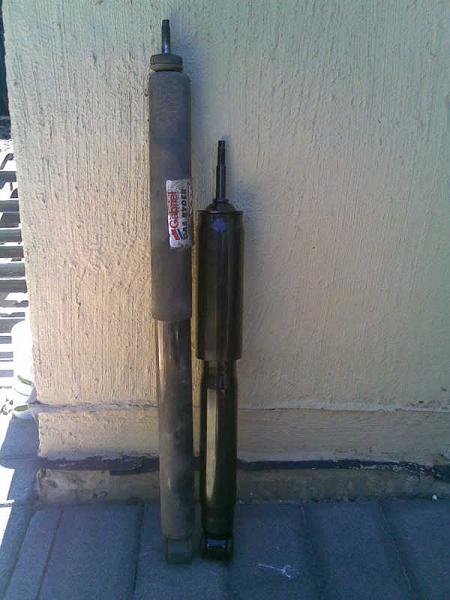

Sounds like you needed the model designed for a lifted sierra. If you're on the bump stops the stroke is far too short, suspension travel is a must for grip. Short stroke sierra shocks shouldn't be used on any corolla if you want it to handle. Bump stops are there for a reason.
2" drop - you want commodore wagon shock absorbers, they are perfect for a corolla.

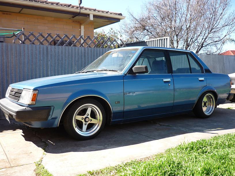

here's a pic of me old ae with choppy kings and sierra's in the rear for u guys to guage.. on 14"s here.
solid ride, slides out awesome even without a welded diff.
