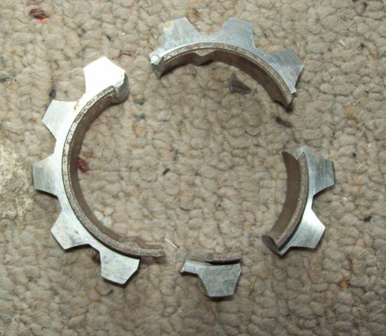

I know this does not seem like much but in the past I have broken oil pumps with big revs but after this little trick I have had any more broken pump gears. Here is a picture of an oil pump that I broke about 4 years back.
